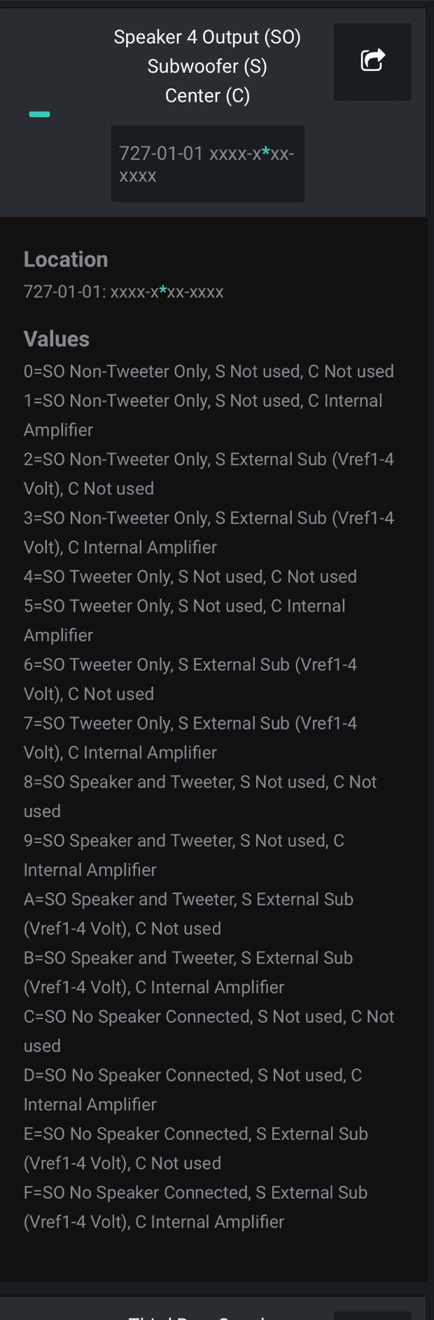

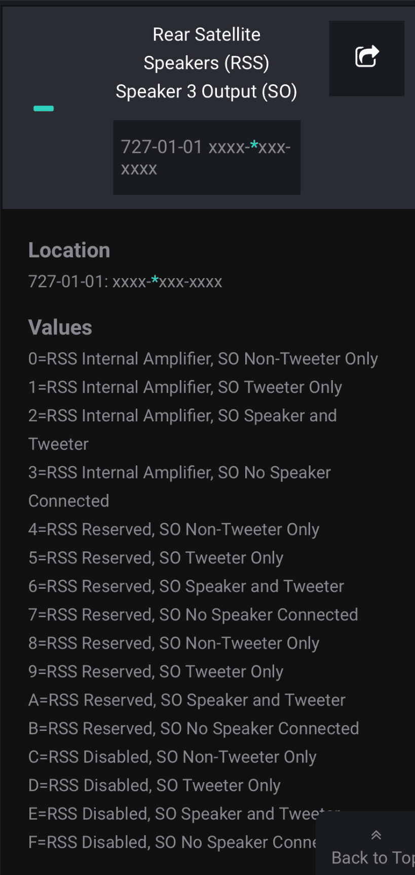

I have the B&O system and I tinkered with some settings in Forscan and I believe I have unlocked more range from the rear pods. I have all factory speakers installed. After making changes to the ACM module in Forscan, there is more range coming from the rear channels.
I am going to be replacing all of the speakers and I will report back to share how it sounds with upgraded speakers all around.
Here are the changes I made:
727-01-01 xxxx-2Bxx-xxxx

After a couple days, I tinkered a bit more. The speaker 4 output settings change the sound of the subwoofer. I changed back to OEM setting and it definitely has more sound going to the sub.

I've been looking for this exact info, but I need a point in the right direction. It seems you found how to adjust the amp settings that B&O/Ford set.
Some background first: I've replaced the 4" speakers with kickers in the front corners, a midrange in the center, and focal 100s in the rear. As others have said, this cleans up the sound quite a bit. It's much less muddy in the middle and I find the bass well rounded with the factory kick woofers in the footwells. However, my issue now is that my sub claps at volumes over 18. The sound is still well balanced via the head unit EQ, but sounds like the sub is bottoming out or getting too much power. The threshold seems to be on volume 18 no matter the EQ bass setting.
Question (stick with me): I'd like to find a way in Forscan to lower the sub output but keep the overall bass level the same. I tried turning the bass all the way down on the EQ and it kills the balance of the sound from the rest of the system. It seems your adjustment of sub output via Forscan might help accomplish this. Can you elaborate on what setting I might try to see if it lowers the gain/power on just the sub? If I read right, you did that and then changed it back to factory, right?
TLDR - how to turn gain down via Forscan on factory B&O sub.

When I had the factory B&O speakers and sub, I made the Forscan changes shown above and it definitely changed the sound of the sub and quieted it down some. It helped reduce the rattling noise I was getting.
I ended up reverting the forscan setting to factory and replacing all of the factory speakers and sub. I went with Hertz 100.3 in the corners and pods, a PRV 4” midrange in the center, Hertz 165L 6.5 midbass in the kick panels, and a Kicker 8” sub in the OEM enclosure powered by a Kicker Key 500.1. It sounds really good now.
The sub/amp install was a big project, but worth it.

Thanks for the info. I'm trying keep this as simple as I can. I would be satisfied if the sub was scaling with the music and not clapping. Maybe something is loose, but it's weird how one click on the volume seems to quite it versus having to turn the bass all the way down on the EQ.

Completely stumped, I’ve only replaced the 3 dash 4” speakers with Fosgates, and the 2 rear pods with 4” Focals.
Used ever version of FORScan ACM I’ve found here to fix the rear sounds, no changes at all and still very muddy and faint.
Original “as-built” ACM is :
727-01-01 3017-34FD-10B8
727-01-02 0900-000D-0047
any help would be greatly appreciated

742
Georgia
Most of what I have read when it comes to the B&O is that there isnt much change at all. Most of the change with FS happens when you have the original 4-speaker setup and turn off the DSP on the rears.
I did replace my 4" rears with 6.5 " in the MTI Pods. The difference is clear with that upgrade, but would Likely need a real amp along with speaker and sub upgrade for a massive difference.
