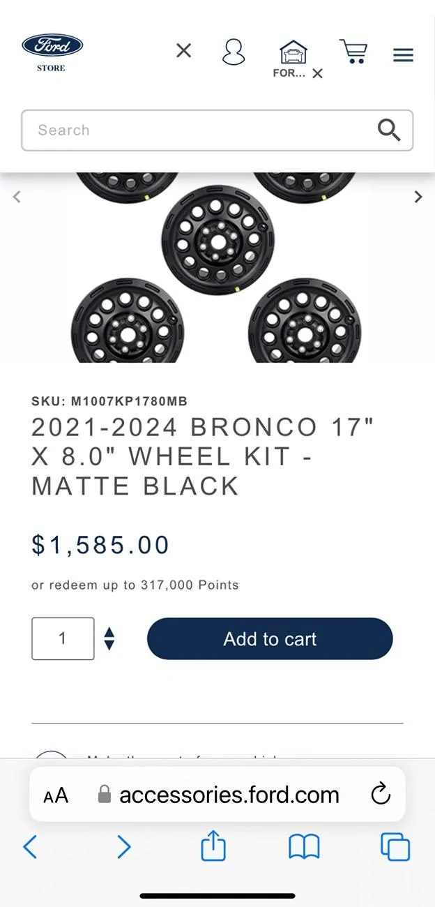

I’m considering the wheels in the photo below with 275/70R17 tires (undecided on brand) possibly KO2/3s.
I’m not sure what the small gain in width of the tires and an 8” vs. 7.5” wheel with the same +55 offset would do for poke or rubbing.
I’d like the tires to be about even with the stock painted flares.
I’m still considering leveling it too.
any thoughts or advice would be greatly appreciated.

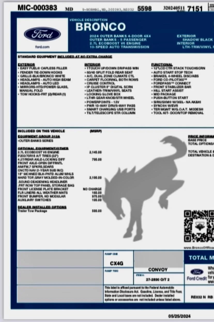

Not sure how much it matters with the tire sizes you’re considering but if I recall correctly you can’t have the 4.7 rear on a non-SAS OBX. You sure that’s what you have? If so, how did you get that?

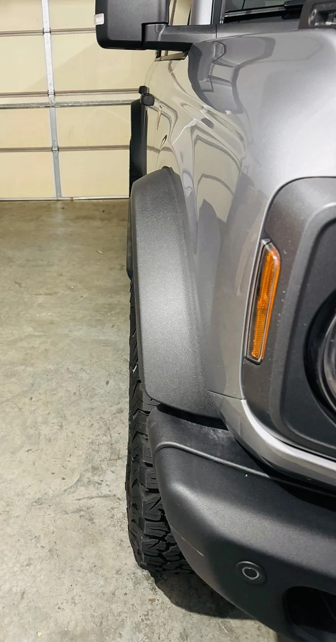

Thanks for the replies. I guess I understand the 275/70 will fit on stock wheels with no issues. I think I want to make sure that going with a wider wheel at the same offset won’t cause any problems.

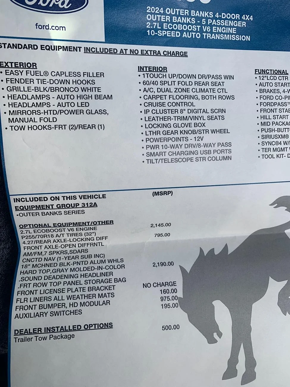

That window sticker shows 4.27 gearing, not 4.7

You’re correct. Typo originally and thank you. This photo will be easier to read

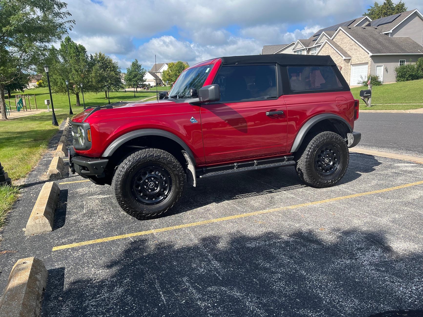

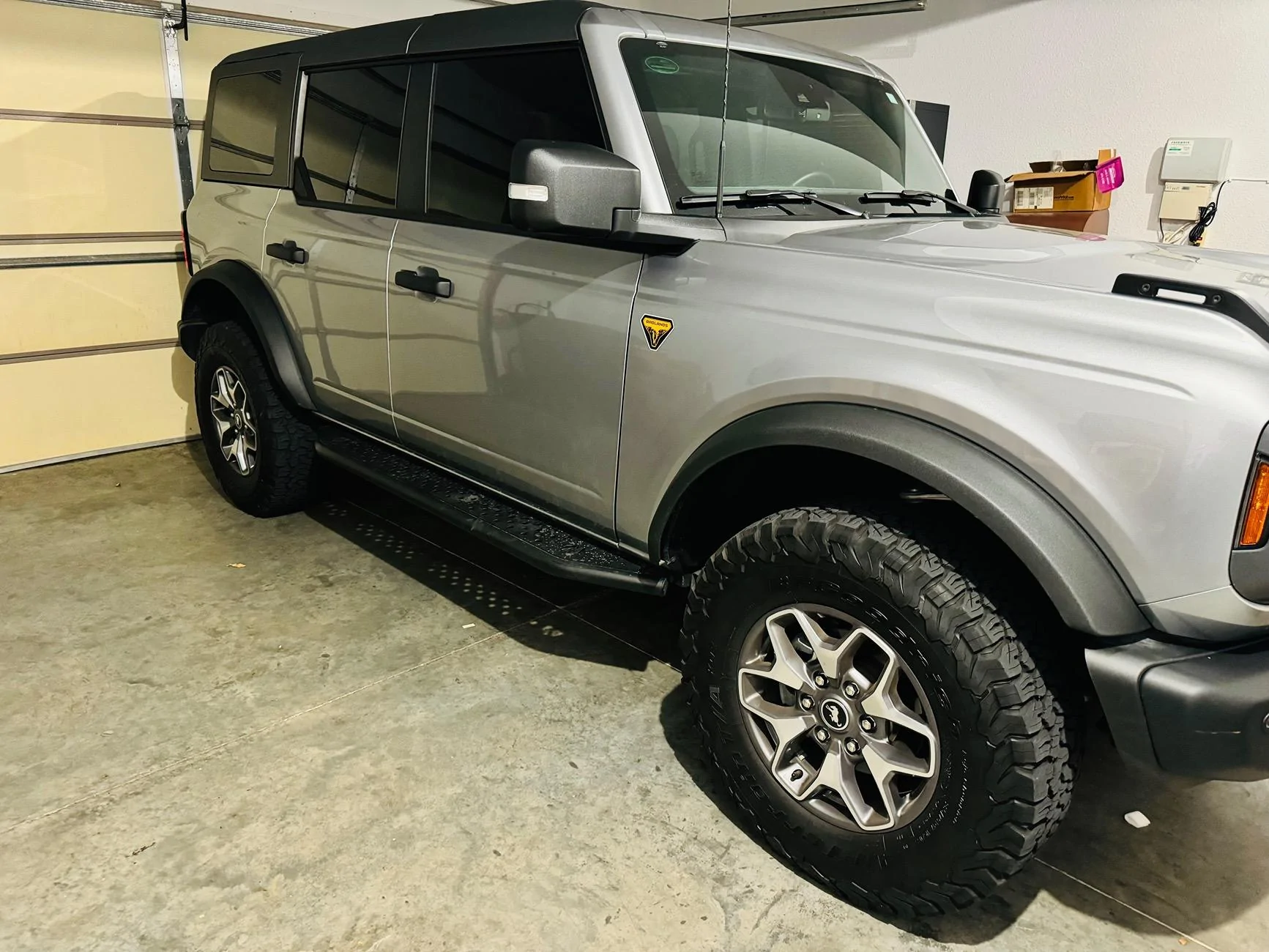

My non-SAS Badlands has 17x8 wheels with +55 offset and 285/70/17 BFG KO2’s. My fender flares aren’t painted but the same width as yours.
Pics below should give a fairly decent representation.
The 275/70’s are about 0.40” narrower. Half that width would get eaten up on the inside and the other half on the outside meaning your edge of tire would be about 0.20” (almost 1/4”) less than mine from the outside fender flare.
if you like the style of my wheels, you can probably find some takeoffs local to you for the $1,000 range with BFG KO2’s attached. Not bad for 5 wheels and tires. The 285’s are a little taller too, about 32.8” as opposed to 32.15”. FYI, I am upgrading soon and interested in selling mine (no pressure).

I just mounted 285/70/17‘s on the same wheels you show. I wanted to keep my original 7.5 wide black steelies but it was rubbing on the stay bar. The 8 inch width gives an extra 6mm clearance (poke) on the +55 offset and is just enough to clear a 285 width. You’ll be fine with a 275 width. Here’s a pic of mine with a 2 inch FP lift.
I ordered the wheels through Stage 3 Motorsport and the price was $1200 delivered to my home. It wasn’t in their online catalog, I called and they submitted a special order at a discounted price. Great prices and service!
