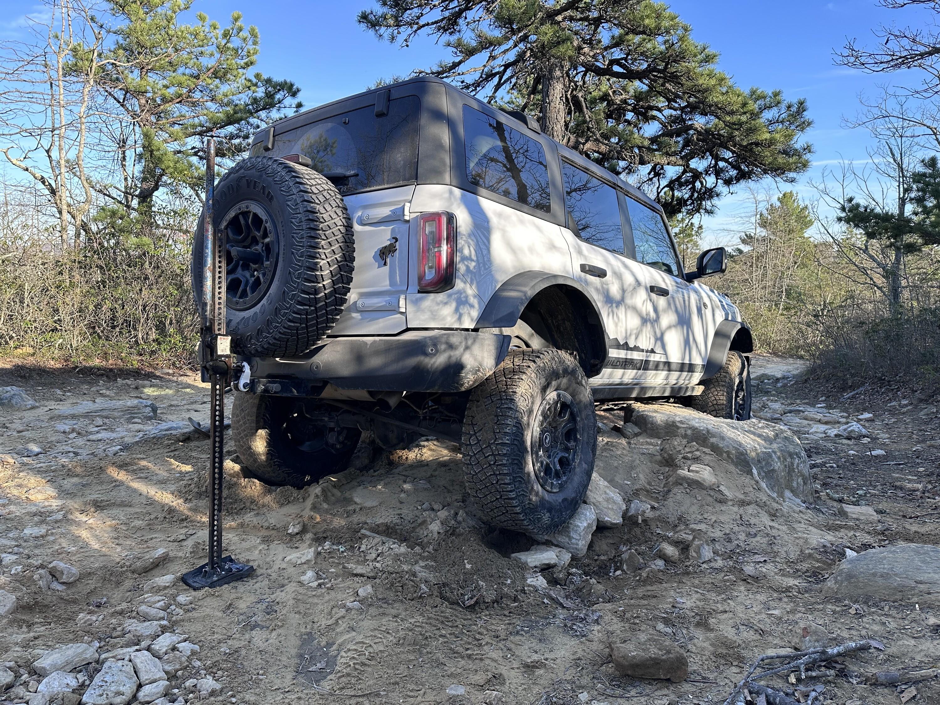

I made fun of my friends for having them then needed two (the second one to stabilize the first) to get mine high enough to get the wheel / knuckle assembly out from under my rig on a steep incline. Had to hold my truck with a winch and even then it was sketchy in loose rock.
Hopefully won’t ever need one again, but plan to eventually mount one on a swing away spare type bumper. A bottle jack won’t go high enough to do what we did. They are definitely dangerous, but nothing lifts as high or as quick (I was blocking the trail on Imogene Pass).

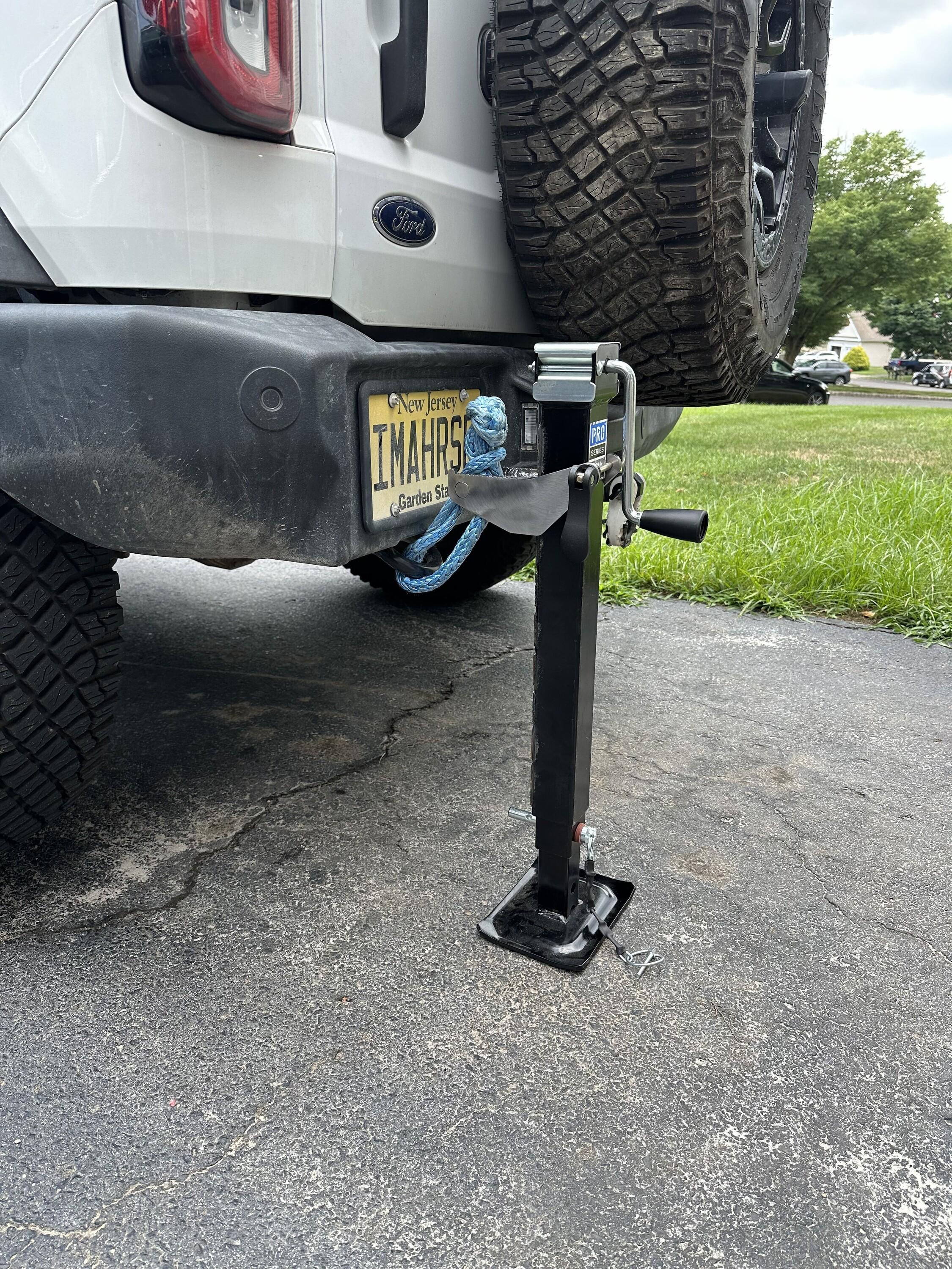

First gen taco
Hi-lift is an incredibly useful tool in the right hands. It also can be finicky and usually needs lots of lube to continue to function properly. That being said it's bulky which makes mounting locations on these trucks difficult. If I were to do it I would mount it vertically next to the spare.
Sure a bottle jack could have worked here from the rear diff but then I would be fully under the truck to use it...
Ford Bronco Hi-Lift jack mounting 53692065023_8c50adac75_4k
Untitled by MJH Creations, on Flickr
I am currently exploring another option for the Bronco that is a weld together solution based on a trailer leveling jack called the Tauler Jack from Brennans Garage.
Ford Bronco Hi-Lift jack mounting 53874091189_2fd2d05283_4k
Ford Bronco Hi-Lift jack mounting 53873688334_f8e8143250_4k

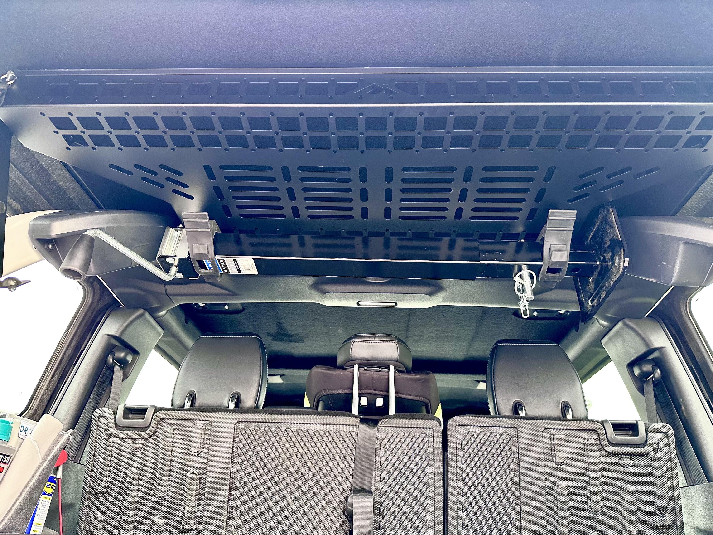

And the plan is to mount to the M2M attic shelf.
Ford Bronco Hi-Lift jack mounting 53874083349_7fed03e8a9_4k Untitled
It's greasable, has no hydraulics that can fail, and has no risk of teeth getting bashed out (if you are stupid enough to put your face in the way) when it uncontrollably CLACK CLACK CLACKS down. If you have seen a hi-lift do this you know what I am talking about. :crackup:

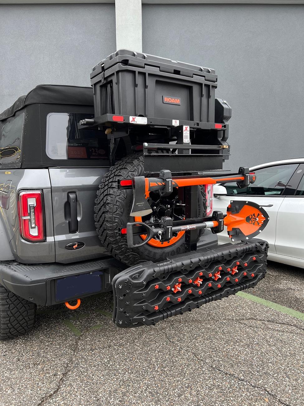

CalvinT
Calvin
Mar 15, 2022
1,303
1,318
Phoenix, AZ
BroncoA512021
Aug 26, 2022
804
932
Long Island, NY
www.facebook.com
2021 Ford Bronco OBX
I can just picture those traction boards jettisoning on the first ledge one drops off :unsure:
@xrack is a very high quality American made product. The MFG is a Bronco owner and an avid fisherman. I own the over the spare Xrack. The tractions boards and everything else is locked and secured...
