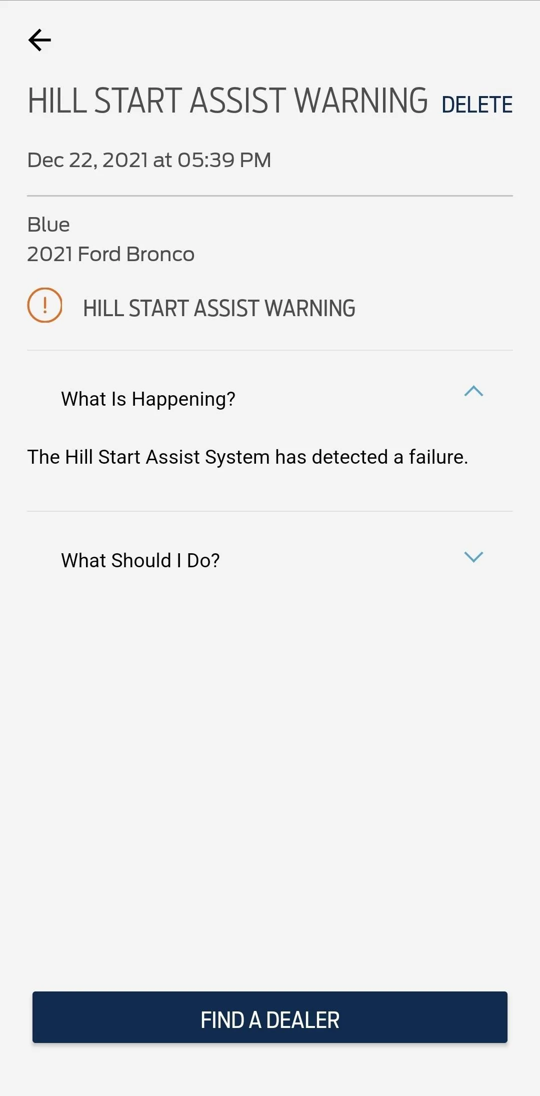

Same here. Happened once last week and I totally forgot about it until yesterday when I noticed an entry in my Ford Pass app. Under "what should I do" it just says to go to a dealer.

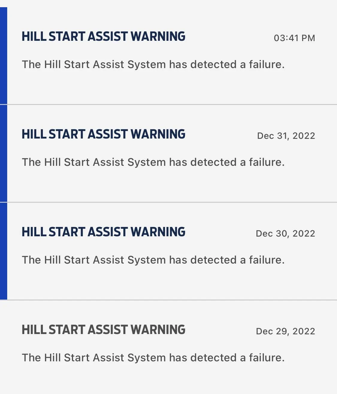

Rekindling this dead thread. This has happened to me twice now. I believe @Vtfakie is on to something as I had it come up for the same reason. I don’t feel it’s worthy of a trip to the dealer for it, has anyone else had bigger issues with this other than just having to disengage the e-brake?
