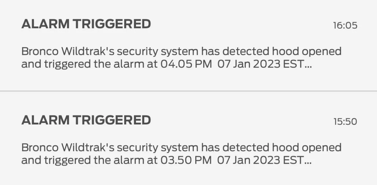

This has happened a couple of time now while driving, and twice today while shopping, setting off the alarm and sending me a message. 31 degrees out. Cycling hood didn’t clear initially on 2 occurrences.
