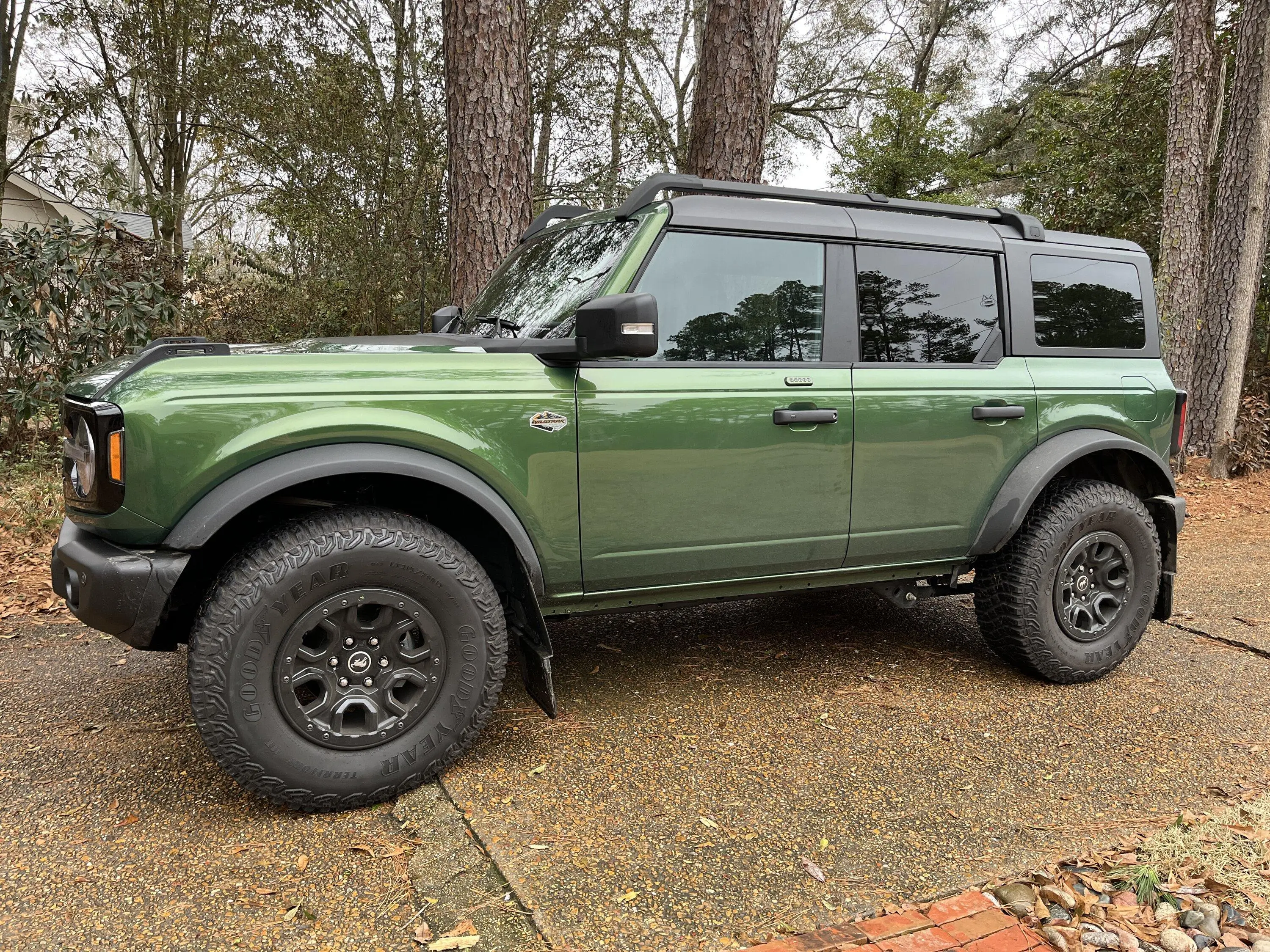

Ford Bronco HOSS 3.0 Lift options? 061AC462-DC13-495B-A0C4-98305E070C60

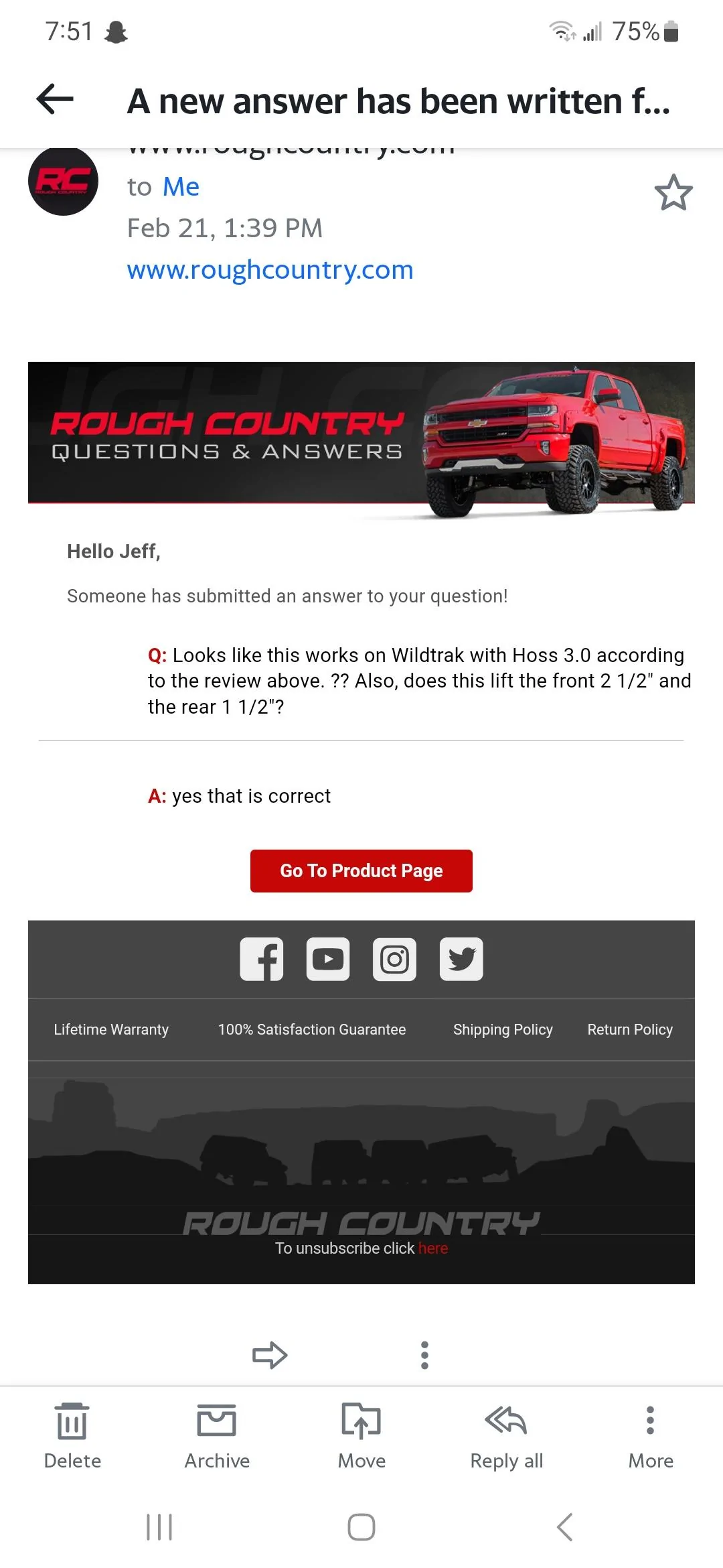

I believe a post here: https://www.bronco6g.com/forum/threads/wildtrak-hoss-3-0-build-almost-done-hahahahahaha.63537 suggest that kit actually will fit a wildtrak with hoss 3.0. He swears RC told him it'd fit and he just needed to clearance some under panel, but RC has told me it wouldnt fit.
Well, if you look at the reviews on the site, first one is a Wildtrak Hoss 3.0 owner. Also, I posted the question on the site if it would indeed work on the Hoss 3.0 and lift the front 2 1/2" and rear 1 1/2". I received an email answer. 😳
