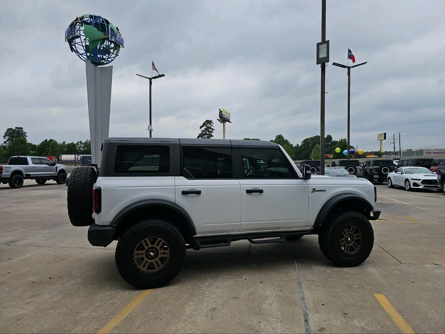

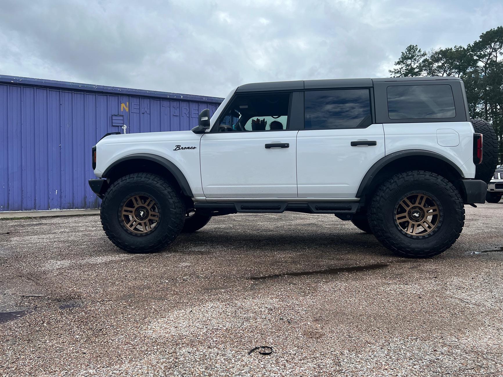

I found a set of four 90+% new Recon Grapplers, 37x12.5 r18 on Facebook Market. $1100. And he bought my 295/70r18s for $400. So I netted out at $175 per tire for 4 (my spare is a little smaller but that’s ok until I can find a deal on another)
They fit with no rubbing whatsoever, and this is with the Zone 2.25 kit only — crash bar mounts still entact.
I will likely get the JKS kit installed here as I’m sure I’ll rub under any serious flexing, or driving down any significant enough decline that puts more weight up front … but I’m a happy man not to have to modify just yet until I’m ready for a next off-road trip.
Full relevant specs:
HOSS 3.0 Wildtrak
Zone 2.25” kit with UCA
Vision Manx 2 18x9 wheels, +12 offset
37x12.5r18 Nitto Recon Grapplers
before:
Ford Bronco HOSS 3.0 Lift options? output_image1712681820404
After:
Ford Bronco HOSS 3.0 Lift options? IMG_8315
