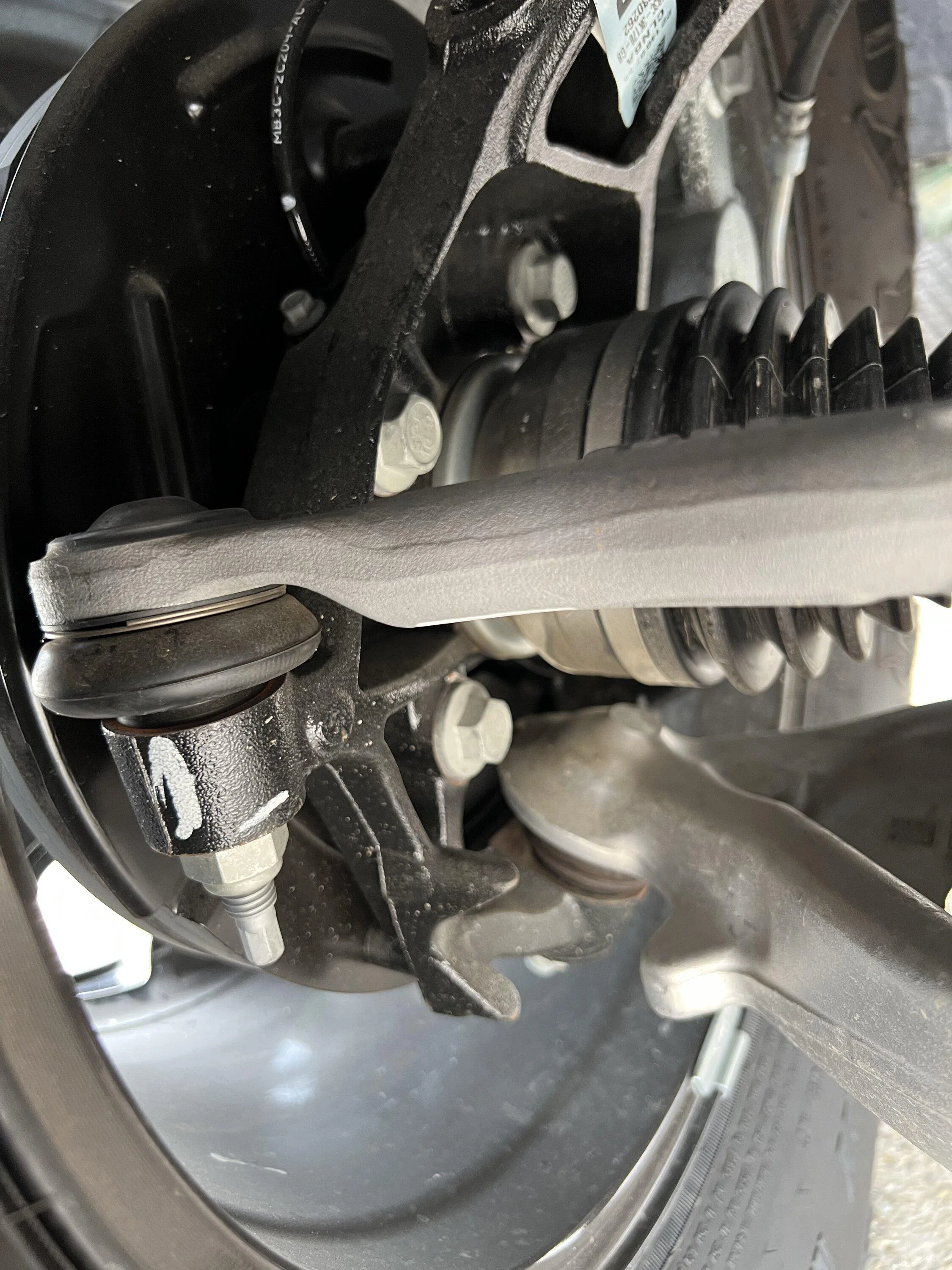

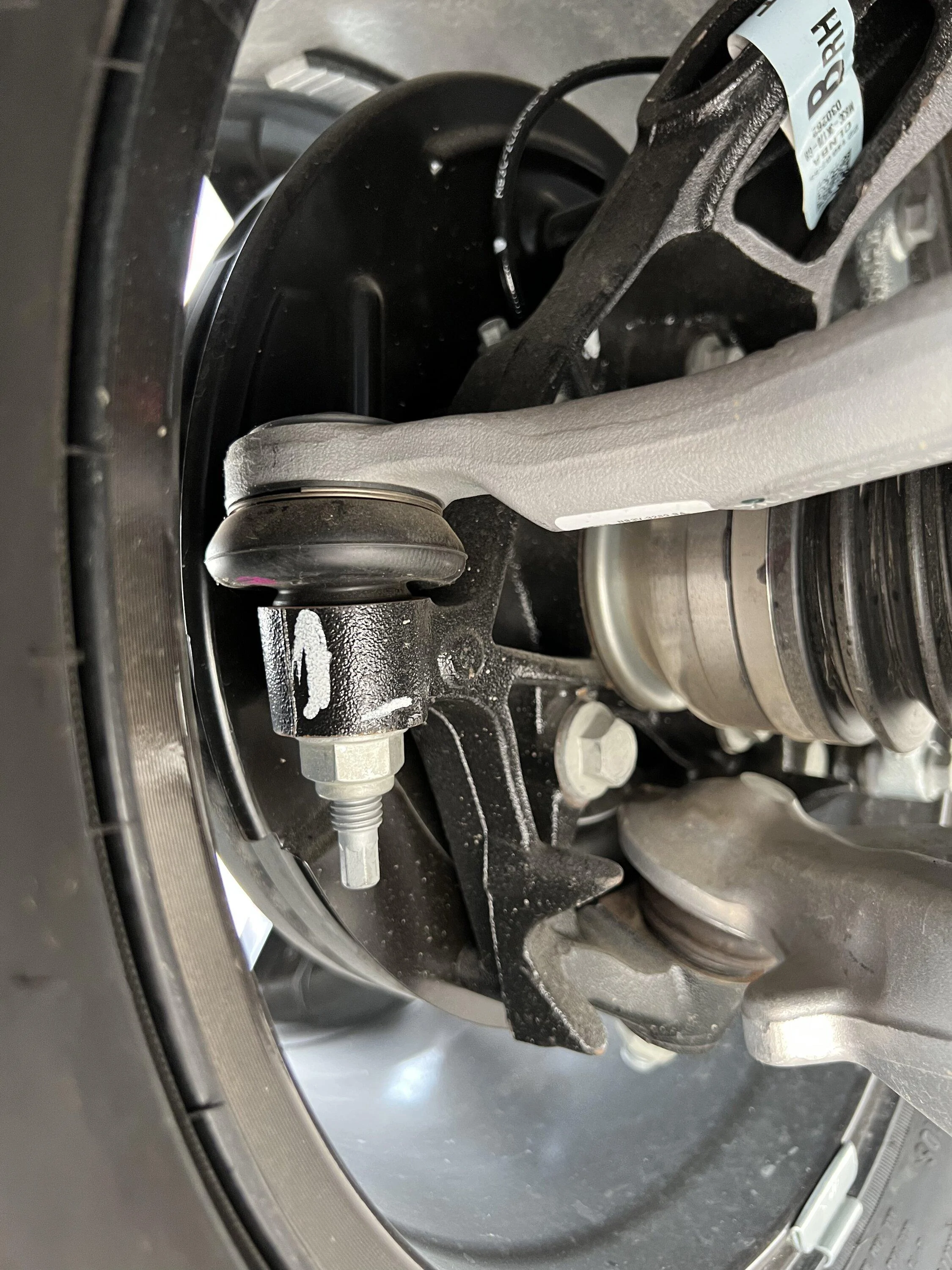

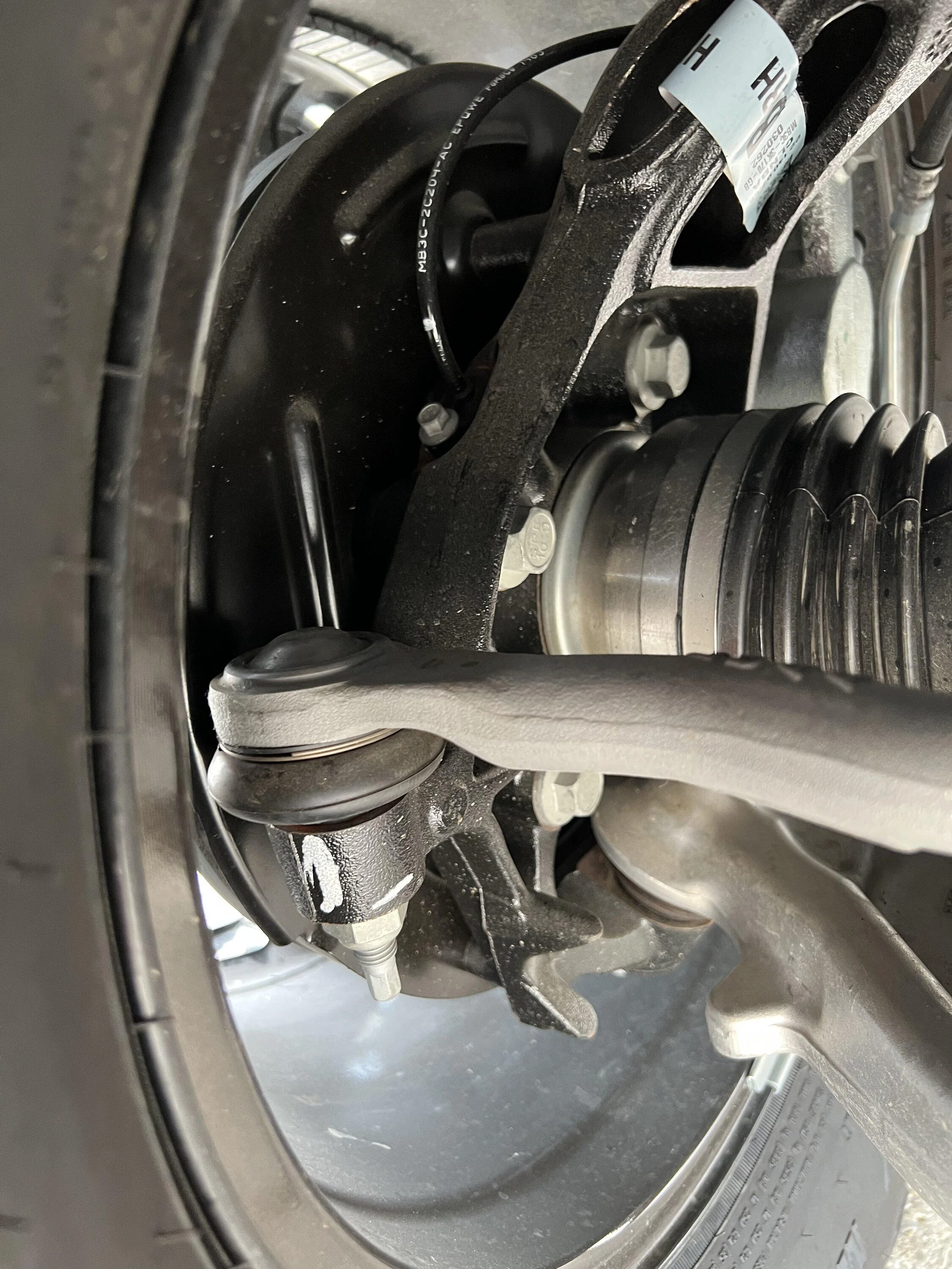

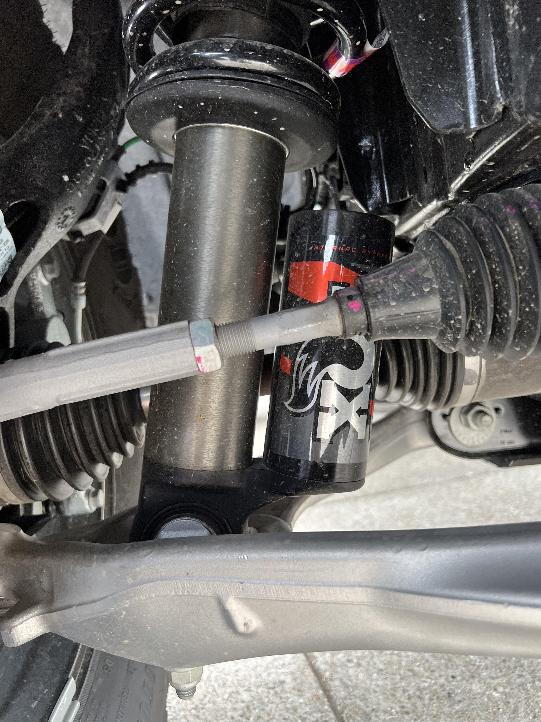

Can someone with a HOSS 3.0 post a picture of the knuckle? The dealer was concerned whether the beefier tie rods might attach differently.
