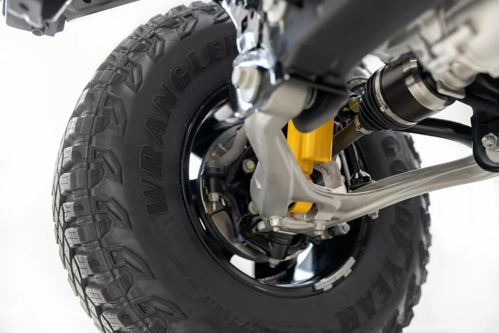

FordBronco_parts_08.jpg: Closeup of the 2021 Bronco independent front suspension featuring forged aluminum alloy lower A-arm.
Ford Bronco HOSS (High-Performance Off-Road Stability Suspension) System FordBronco_parts_08 - Copy

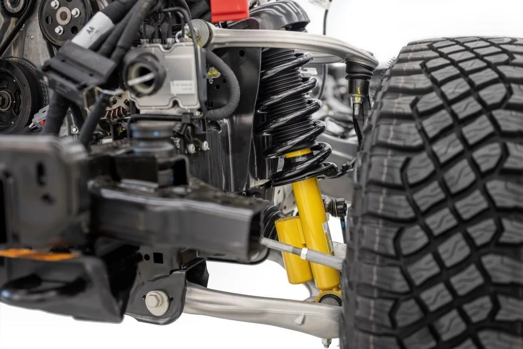

FordBronco_parts_09.jpg: Closeup of the 2021 Bronco independent front suspension featuring two forged aluminum alloy A-arms and available Bilstein long-travel position-sensitive dampers with end-stop control valves.
Ford Bronco HOSS (High-Performance Off-Road Stability Suspension) System FordBronco_parts_09 - Copy
