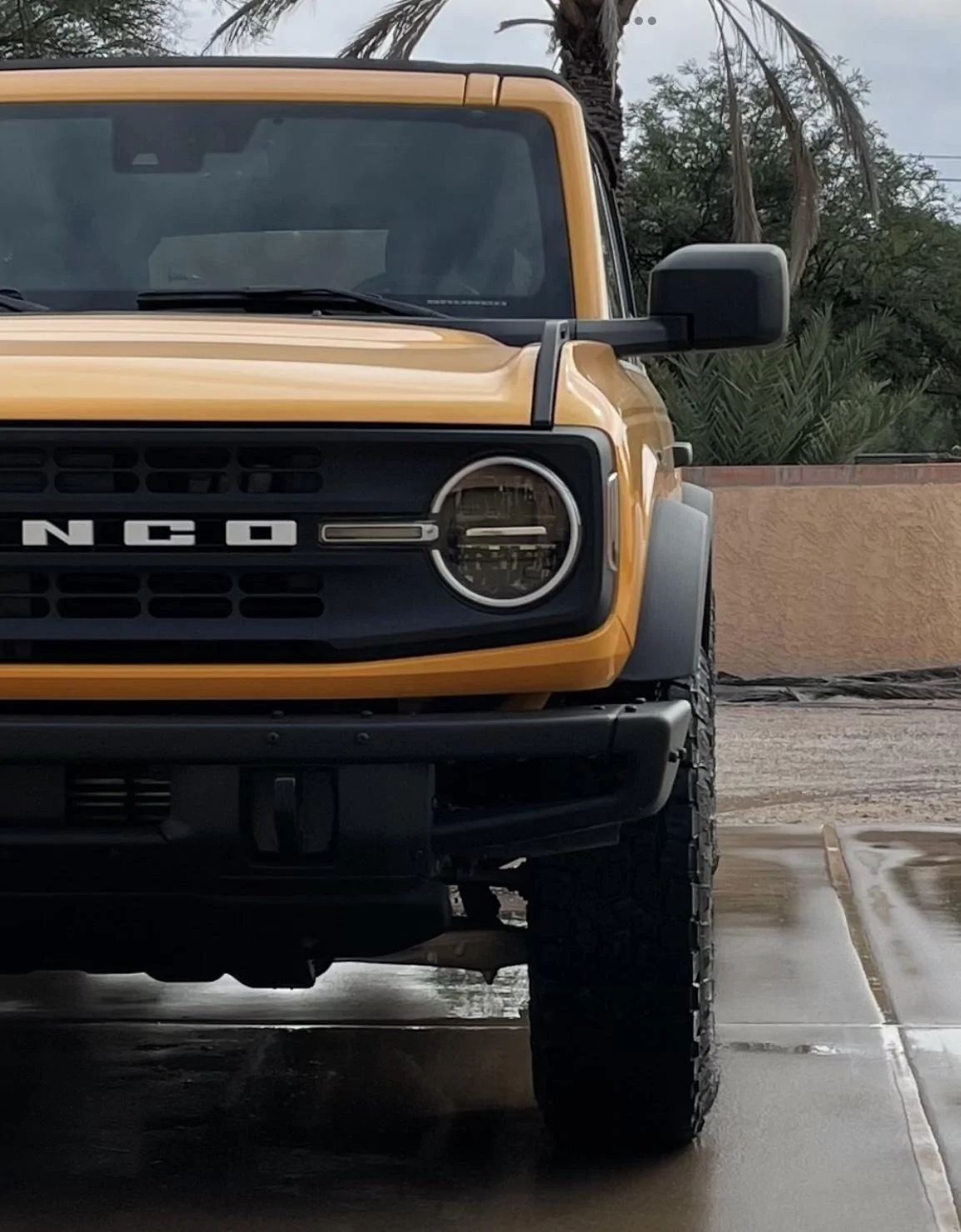

That tire (285/75-17) on a stock (+55) wheel is perfectly flush with non-Sas fender flares. (That’s what I have on my Bronco). So if you go with a +15 offset wheel, that’s 40mm of poke, or about 1-1/2”. No way around that…
Ford Bronco How does "Measured Rim Width" affect tire width, if at all? A0FF1D81-2D01-49B3-9A79-73B09F3C92E9

Man that looks really good to me. I am hoping some company comes out with a higher offset wheel that looks like the Ansen slot mags. As much as I want the look, I don't want the poke from the original Ansens which are 0 offset from what I recall.

I agree, I like the flush look. Hopefully, some wheel makers will start accomodating the large offset of the Bronco, maybe offer at least a +35 or something…
