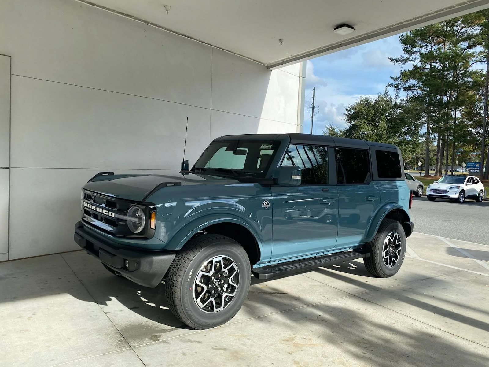

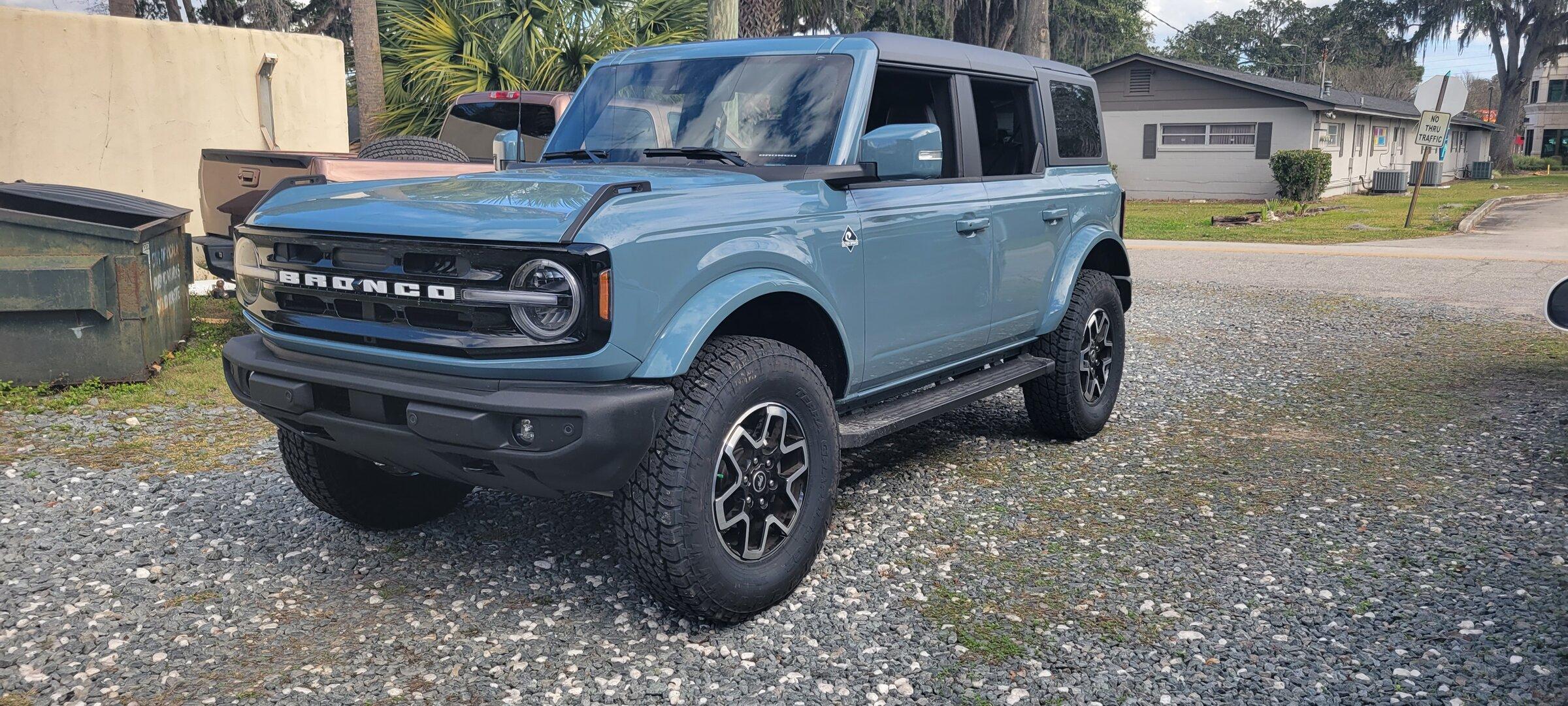

I just did the same. Depending on the offset of the rim, you may need slightly smaller tires than 35s to avoid rubbing at full lock. I ended to going with 285/75/r18 which gave me 34.8 inches and no rubbing.
It did take my average mpg from 20 down to 15 but it rides just as quite and smooth... just a bit higher.
Before and after pics

    Love it!
