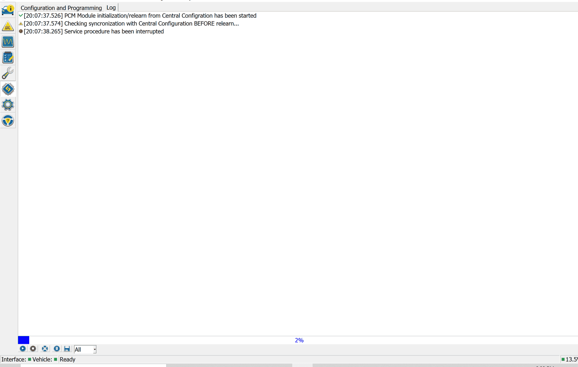

I have been reading this thread intently and I finally got my Bronco last week. 4 door Outerbanks with standard rims. I quickly ditched the Duellers and put on some 265/70r18's. I then bought the vgate vlinker cable and got Forscan. I went into the Tire field and put in what I calculated to be the correct circumference in MM to my tires? (2646mm), but now I've for a DTC lamp on for the PCM that I can't clear. (P160A:00-2F) I don't have TCM module like in the original how to thread, and when I try to get the PCM to relearn, it says "Service Procedure interrupted". My question is 2 fold.
1) Did my tire size reading actually get changed, with this PCM error?
2) How do I clear this DTC?!
Thanks!

See the followup post on the first page that describes what else needs to be done to clear these errors
Just make sure after you change the tire size to force the TCM and PCM to relearn and do the reset of the DTC, then you should not have any error messages:
13. Now we have discrepancy between tire size values known by PCM and TCM and new value stored in BdyCM. So we have P160A DTC in TCM module and P0610 in PCM module:
14. In order to remove the discrepancy, we need to force PCM and TCM to “learn” the new value from the ECC. We can do it using Module Initialization/Relearn vehicle data functions for PCM and TCM module:
Note: some cars may have other modules that require this operation, for example AWD, SOBDMC.
15. After running the Relearn functions, we need to reset the DTCs:

Yes.. I've read that post many times. The issue is that when I click to relearn, I get a "Service Procedure interrupted" error and it just stops.

I got the same relearn error for the PCM. AWD module relearned successfully. I took it for a drive and it did change the readings, had to do another change to get it closer. No CEL, but the P160 code is still in the PCM
This is where I am now.
285 K02 - 2525
315 gy mt - 2600
Ya. Same thing as me. I haven’t figured out the p160 code in the PCM either or how to turn it off. And because of this I don’t now if the new circumference has actually taken.

I am also getting the error with the PCM relearn, no issue with the AWD relearn.
