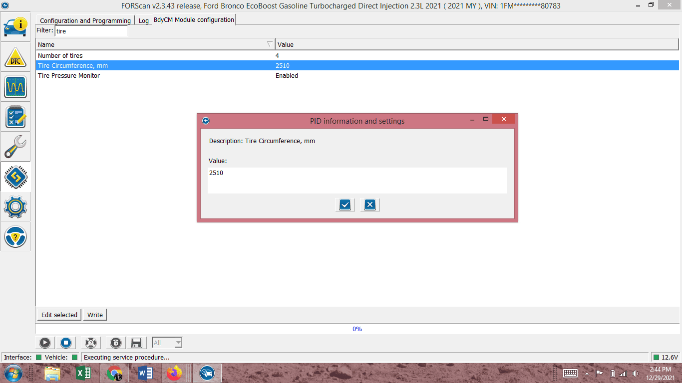

So... If I just wanna make a 2% correction to the speedo, without any actual tire changing going on, this is the procedure?
Yeppers.
First you change the tire circumference in MM (by 2% in your case) in the BCM. Then you have to relearn the PCM and AWD modules. AWD works great, PCM is where we get the error. And if you leave it, you get a trouble code. The speedo does change, but there is a DTC.
Several people have indicated that they just left it with the code. I’m not sure what other stuff relies on the tire size being committed properly in the PCM, so I always put it all back in my attempts to get it to work.

That’s awesome and lucky! My tire size adventure has been less satisfying, but based on all the research and poking around I’ve done I came to the conclusion that the speedo must be significantly off for a stock Black Diamond. The BCM is set to 2440mm, which is much smaller than the 265/70R17.

Just make sure after you change the tire size to force the TCM and PCM to relearn and do the reset of the DTC, then you should not have any error messages:
13. Now we have discrepancy between tire size values known by PCM and TCM and new value stored in BdyCM. So we have P160A DTC in TCM module and P0610 in PCM module:
14. In order to remove the discrepancy, we need to force PCM and TCM to “learn” the new value from the ECC. We can do it using Module Initialization/Relearn vehicle data functions for PCM and TCM module:
Note: some cars may have other modules that require this operation, for example AWD, SOBDMC.
15. After running the Relearn functions, we need to reset the DTCs:

Got it, I was able to take it to my dealer and they were able to run both relearn's using the official Ford tool. So I am good to go, but it's annoying not to be able to do it at home.

No, I'm all good, these are the values I set mine to. No lights, no error codes.

So this is the exact series of events we followed. Changed the circumference in Forscan myself, then went to do the AWD relearn, which went fine. Then I tried the PCM relearn in ForScan, no luck. Took it to my dealer Spirit Ford in Dundee Michigan. They hooked it up in FDRS right in front of me ran the simple PCM relearn took 2 minutes, then we cleared the codes. No lights no issues, circumference is still where I originally set it. Been driving on it for 2 days with no issues.
