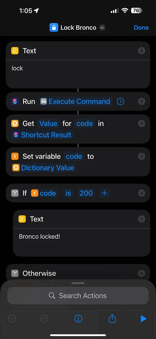

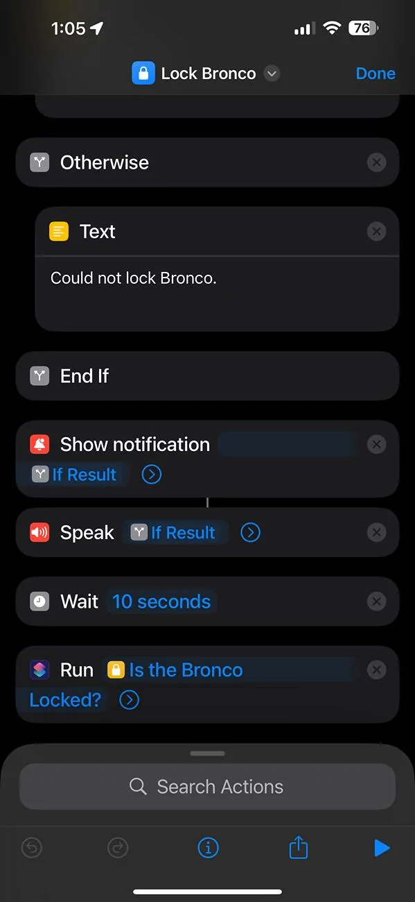

ok, had this all working. all commands (and through SIRI and received all notifications back. Upgraded to IOS 18. and the commands are broken. Siri doesnt recognize them, and none of the statues work. if I manually go to the shortcut and press unlock/lock (haven't tried turn on/off yet) they work. Any body else have this problem with ios18 and troubleshooting?

I’ve been on ios18 for a couple months and everything carried over just fine. I don’t see anything from you screenshot that looks wonky.

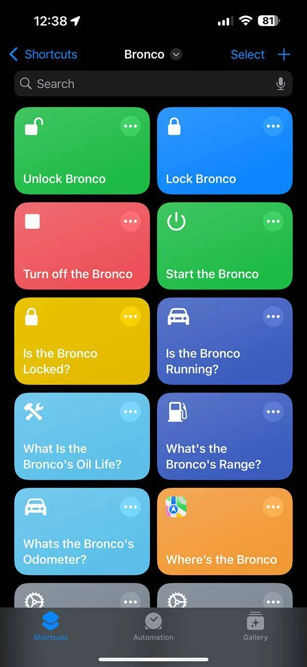

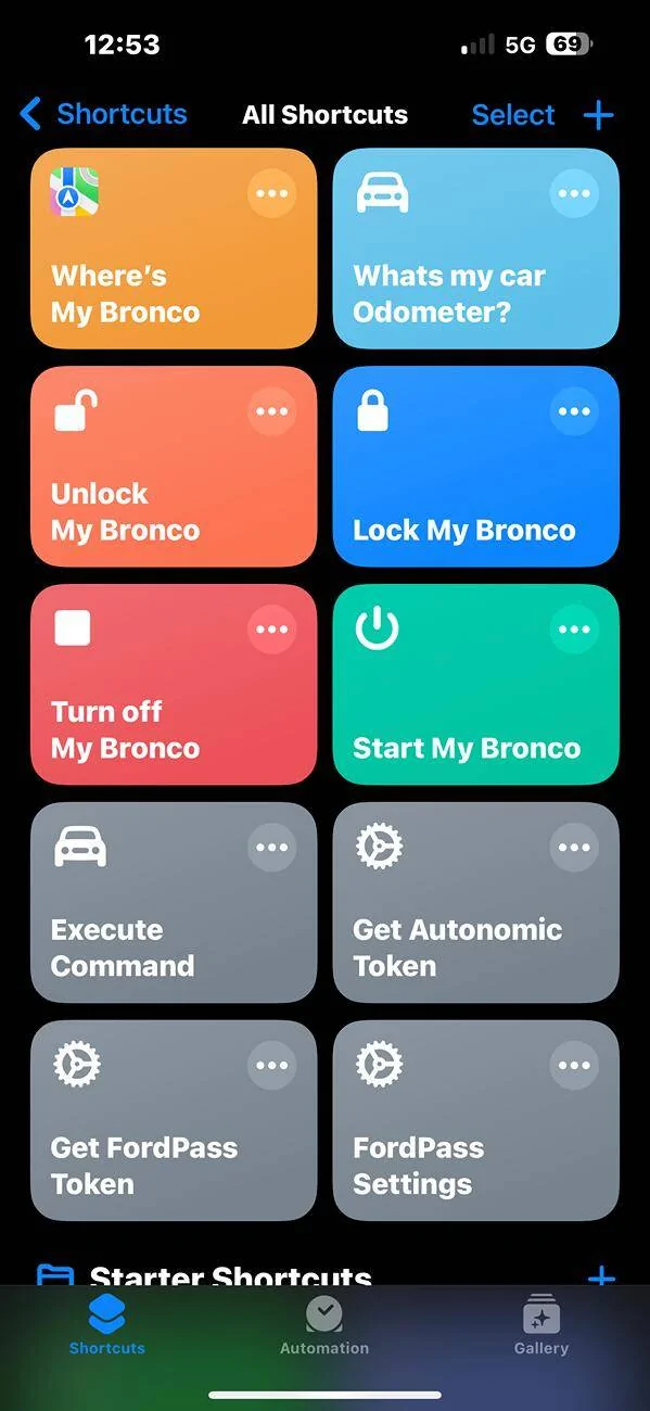

Hmmm. Turned iOS shortcuts on and off in system preferences/iCloud and then restarted my phone and the shortcuts work but Siri doesn’t recognize them I say, Siri lock, bronco or lock the bronco and it lock the iPhone. It doesn’t recognize any of the bronco commands. Does everything look right in the set up?

Looks the same as mine.
