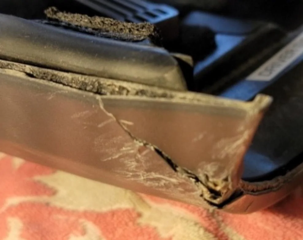

I cracked my hard top panel *HELP*

Being that it will be out of pocket and not a warranty claim, you may as well trying "patching" it first. It will likely look like shit and be temporary. But it is worth the shot. The damage looks like a clean crack. You might try JBWeld and then some touch-up paint.

A good body shop can repair it.

Get some THIN (slightly runny) clear epoxy and let it wick into the crack. Then within one to two minutes wipe off the excess with a clean, smooth cotton cloth. Use some denatured alcohol (Home Depot or Lowes in the paint department) and use another piece of clean cotton cloth and wipe off the surface to clean the epoxy smear with it. Do Not use acetone or you will melt the plastic.
Here is an article on how to thin epoxy using various methods.
Thinning Epoxy – How to Thin Epoxy Resin Correctly?
Cheap Tip: Try the one titled "Denatured Alcohol for Thinning Epoxy Resin" since you are going to need to purchase Denatured Alcohol already.
These were comments made by @North7 last year for a similarly cracked panel. Seems like solid advice.

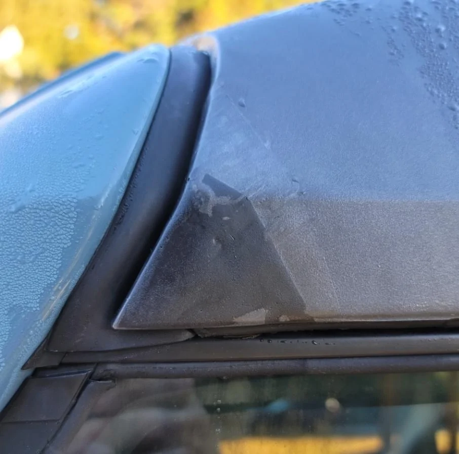

Just dropped it putting it back on, heart breaking. Any ideas on how to patch this puppy?
passenger panel on top right corner
Ford Bronco I cracked my hard top panel *HELP* IMG_1341.MOV

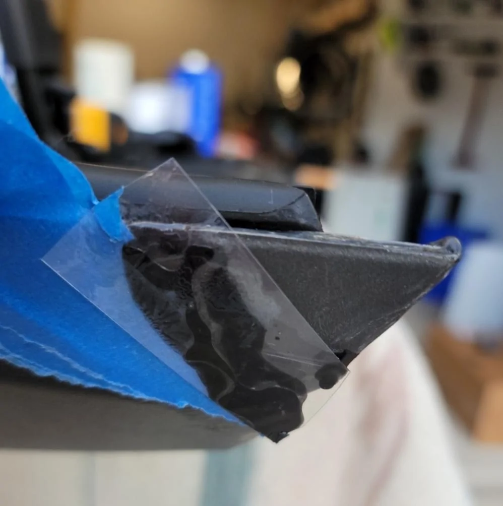

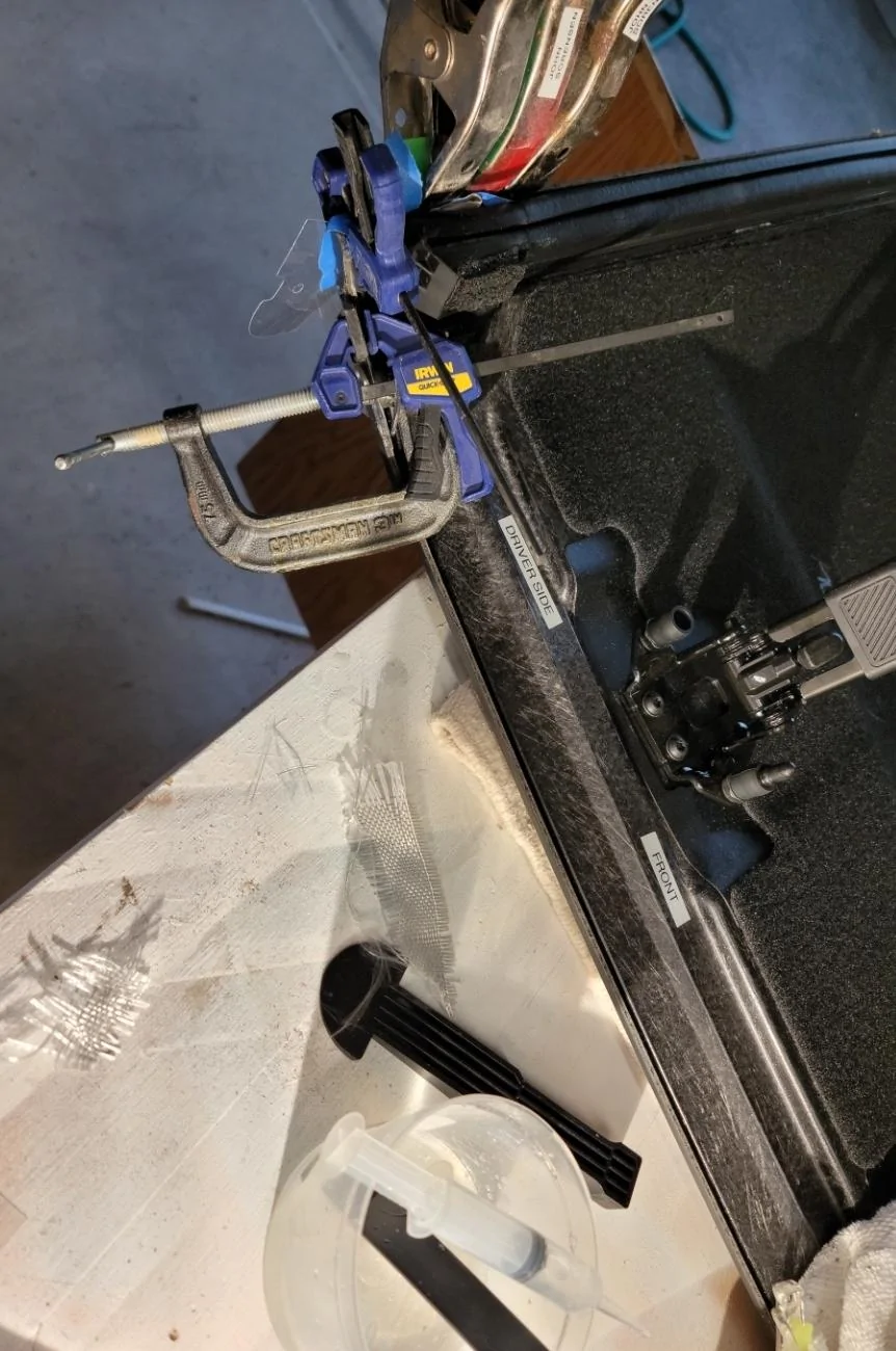

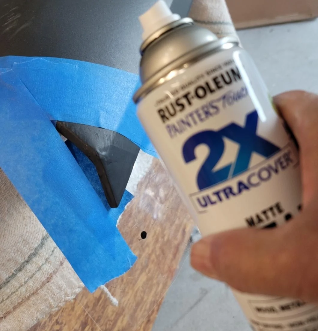

If you'd search my post from Oct 2021, you'll see I broke the other corner similarly. There is no honeycomb under there, its solid glass and composite. Its quite strong, but if you drop it just right on the corner, it will snap. The best approach is to repair by injection from below, but you cannot make it much thicker or you'll mess up the gasket. Only way to repair from top is an unsightly build-up. I mixed carbon powder with west system. If you take a few photos from below, and with a slight bend I can see. Or message me.
Funny thing is, some well-positioned tape will stabilize it. Heres the general idea.
1. Separate void, clean and stabilize
2. Fill w thickened epoxy & maybe fiber
3. Clamp to keep contour.
4. Use plastic release material, cover areas to prevent bleed. Cure. Sand/file
5. Cover and shape with carbon & Epoxy.
6. Release plastic. Repeat 5.
Wet sand. Spray with a UV protectant ckear coat. UV rays destroy Epoxy, and the carbon is a close color and a UV blocking agent.
7. You may be able to repair yours from below, avoiding rebuilding the corner as I did. Because it is a thermoplastic material, polyester resin will not work, hence epoxy.
Thats my experience. Its held up 16 months
