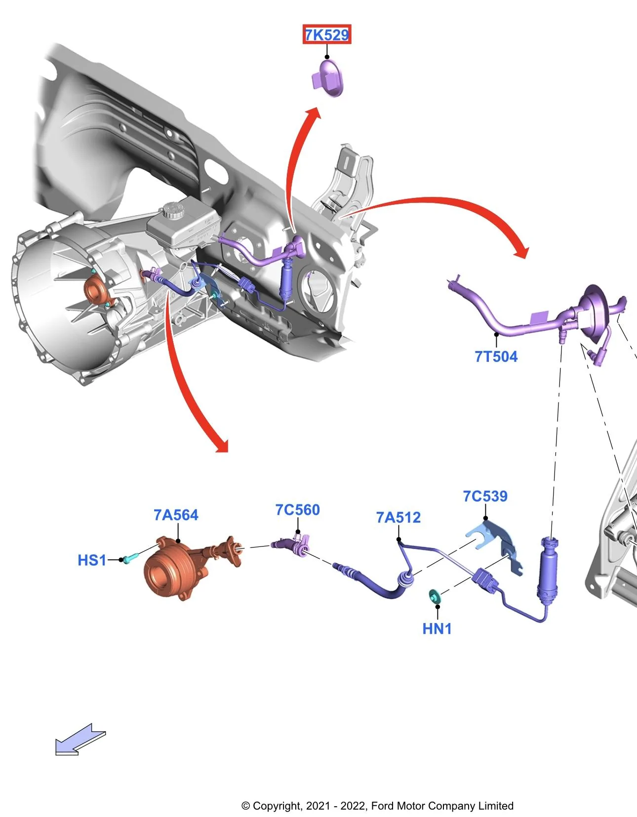

On a manual Bronco that grommet spot is used for the clutch master cylinder line.
Assuming there’s still some room to pop a hole for an 18g wire? I also plan on sending the power adapter wire for the Kicker Key…
I’d assume so. But I have an auto, so I can’t confirm.
