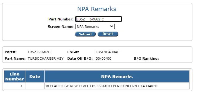

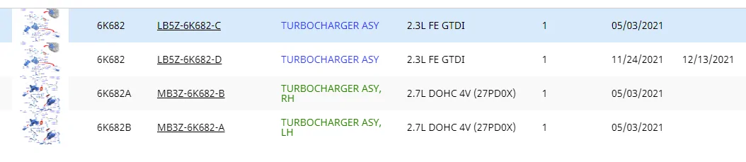

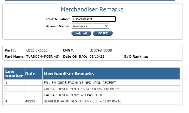

Depending on what the dealer ordered, the part has had two supersessions. Started with a -C, then -D now -E. See B/O date and remarks. This is a Ford product but someone else supplies the part to them which puts customers and Ford at the mercy of someone else's labor or sourcing mercies.
The only thing the dealer can do is put in an emergency order, VOR (vehicle off road) and open a GCCT/COPIS case. If the part doesn't show up in 30 days they need to go back in and code it so the system doesn't drop it from the order que.
Beside supply chain shortages across this industry and just about every other one that relies on a sub supplier(s). In this case the dealer can only look at this DOW inquiry screen to figure out when it might start shipping. There's no reason this can't be communicated as it's not confidential info and can assist the service department planning for rental/loaner needs and help manage customer expectations. Not that anyone involved likes the delays but it's out of Ford's, the dealer's and customer's control.

This is from Microcat. Not sure if your dealer is using Snap-On or Ford E-Cat but when I went to DOW to see what availability was I got the supersession notes that it went to -D.
I don't think this part number is specific to Bronco based on the prefix and likely shared with Ranger.
