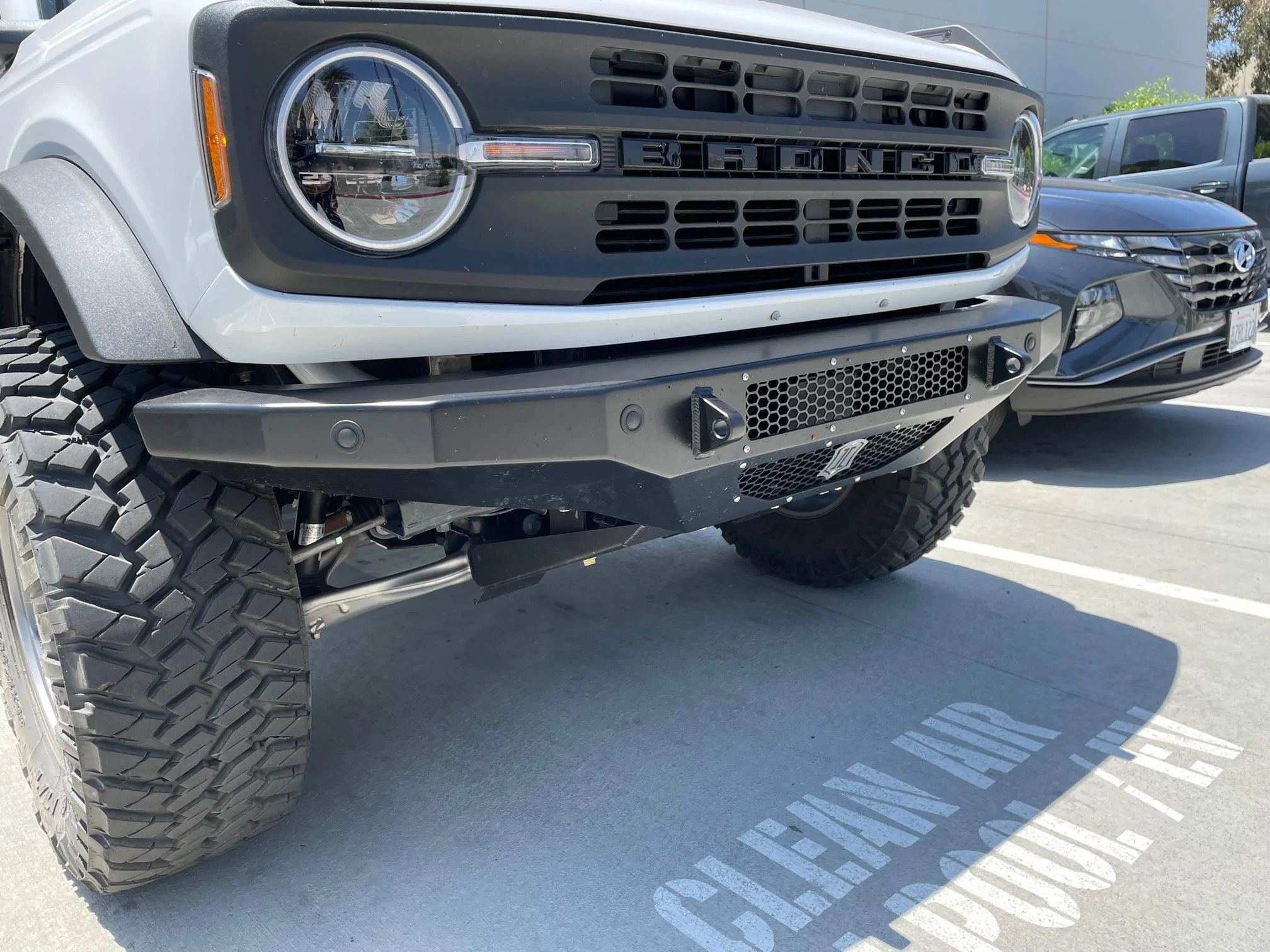

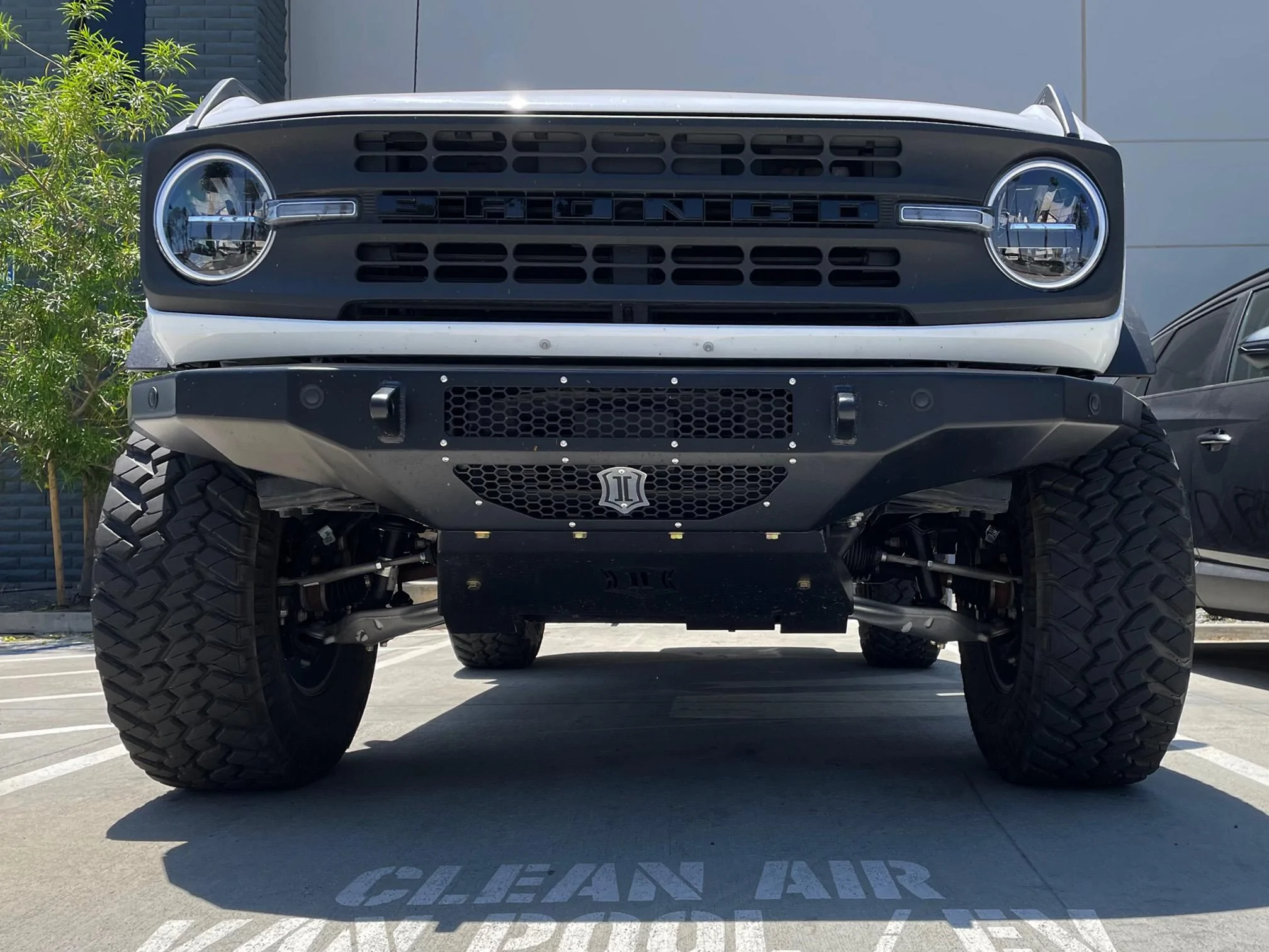

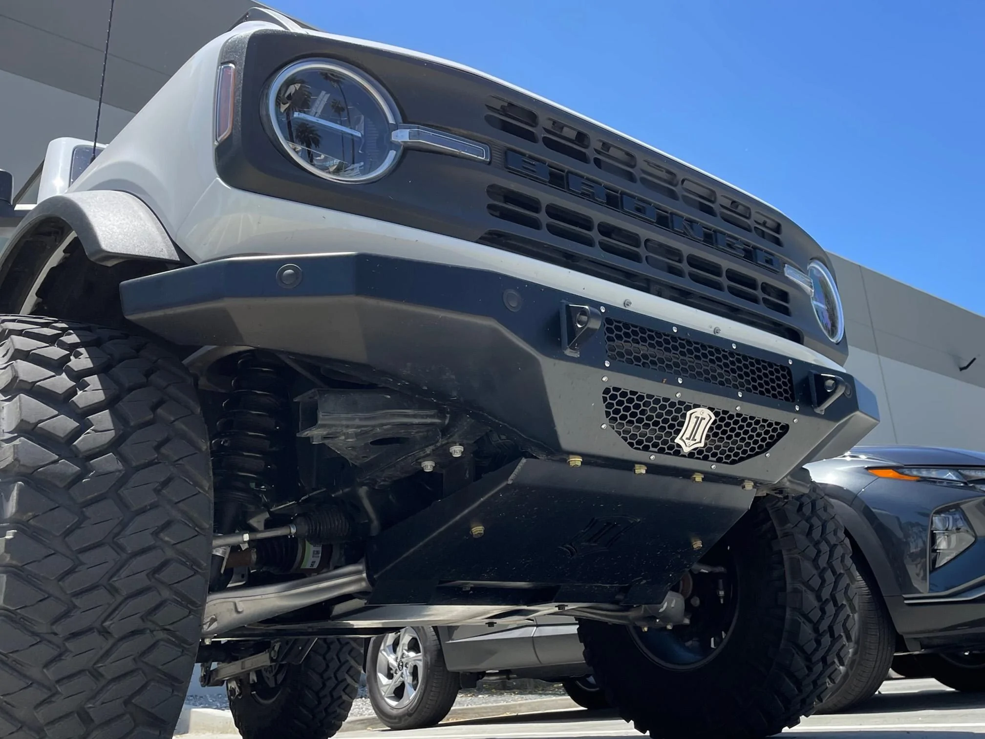

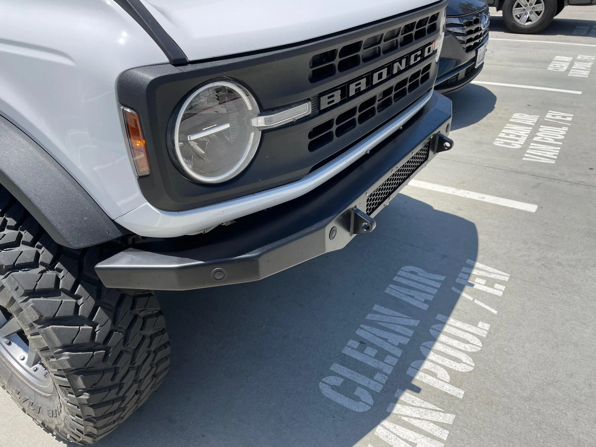

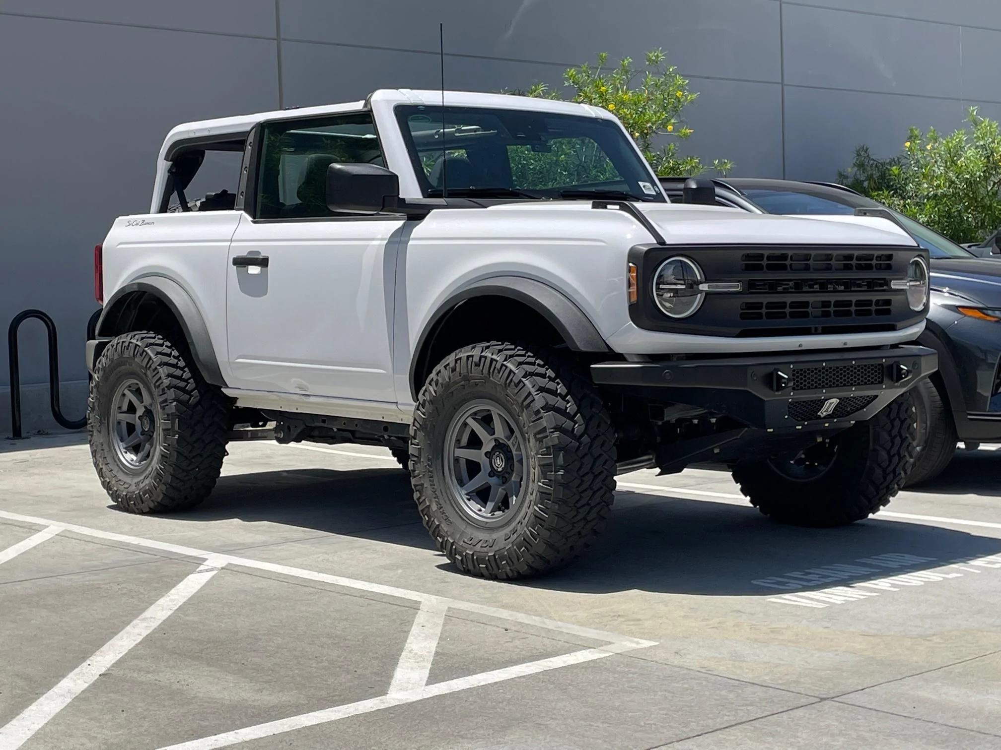

OK I didn't really want to clutter up my EXP thread with pics of bumpers, but I don't have a bumper thread yet and don't want to create one until they're ready to officially announce. So I guess I'll just sneak them in. Apologies to those who are following this thread for the EXP's. Anyhow, as promised I grabbed a few shots for you of the non-winch bumper when I came back from lunch. A couple of things to note:
  • This is a prototype. It isn't an actual production article yet.
  • The skid plate shown is powder coated steel, but the production ones will be aluminum, like what we showed with the winch bumper earlier.
  • The center mesh section in the upper part of the bumper will accommodate some optional lighting solutions (or just leave it mesh). No details on those yet.
  • The Icon logo cutout in the lower skid will be removed. Someone suggested that after seeing pics of the winch bumper, and we agreed; it's redundant.
  • Comes with replacement skid/cooler mounts so it works on Broncos that came with any of the OE bumpers including the plastic bumper.
  • Sorry everything's so dirty.
