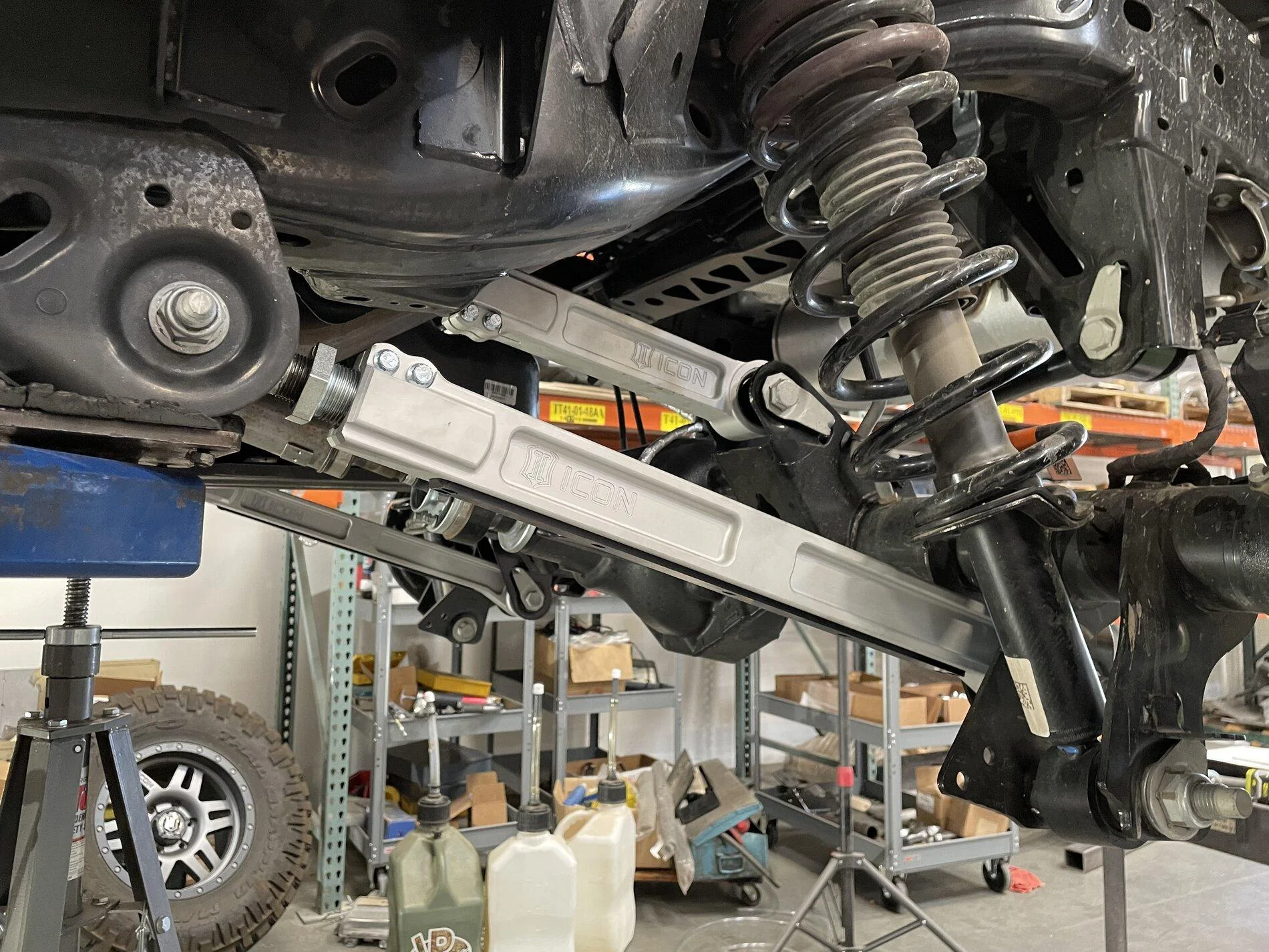

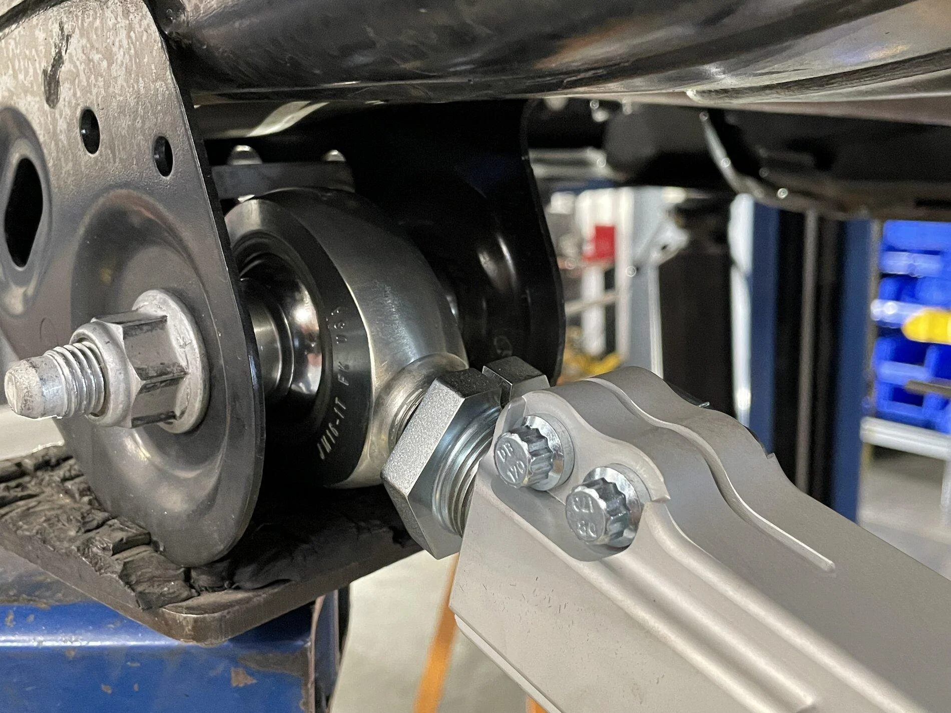

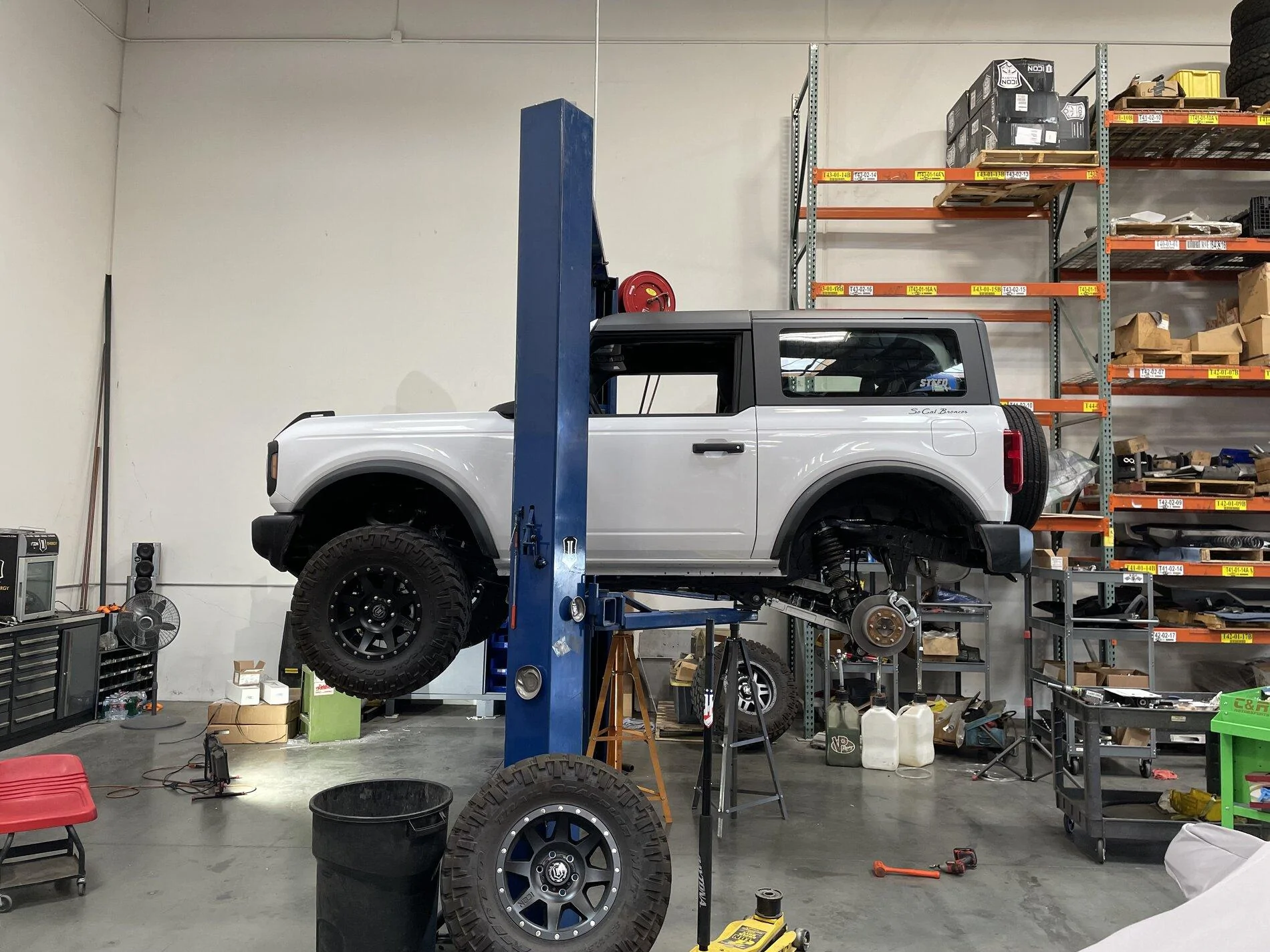

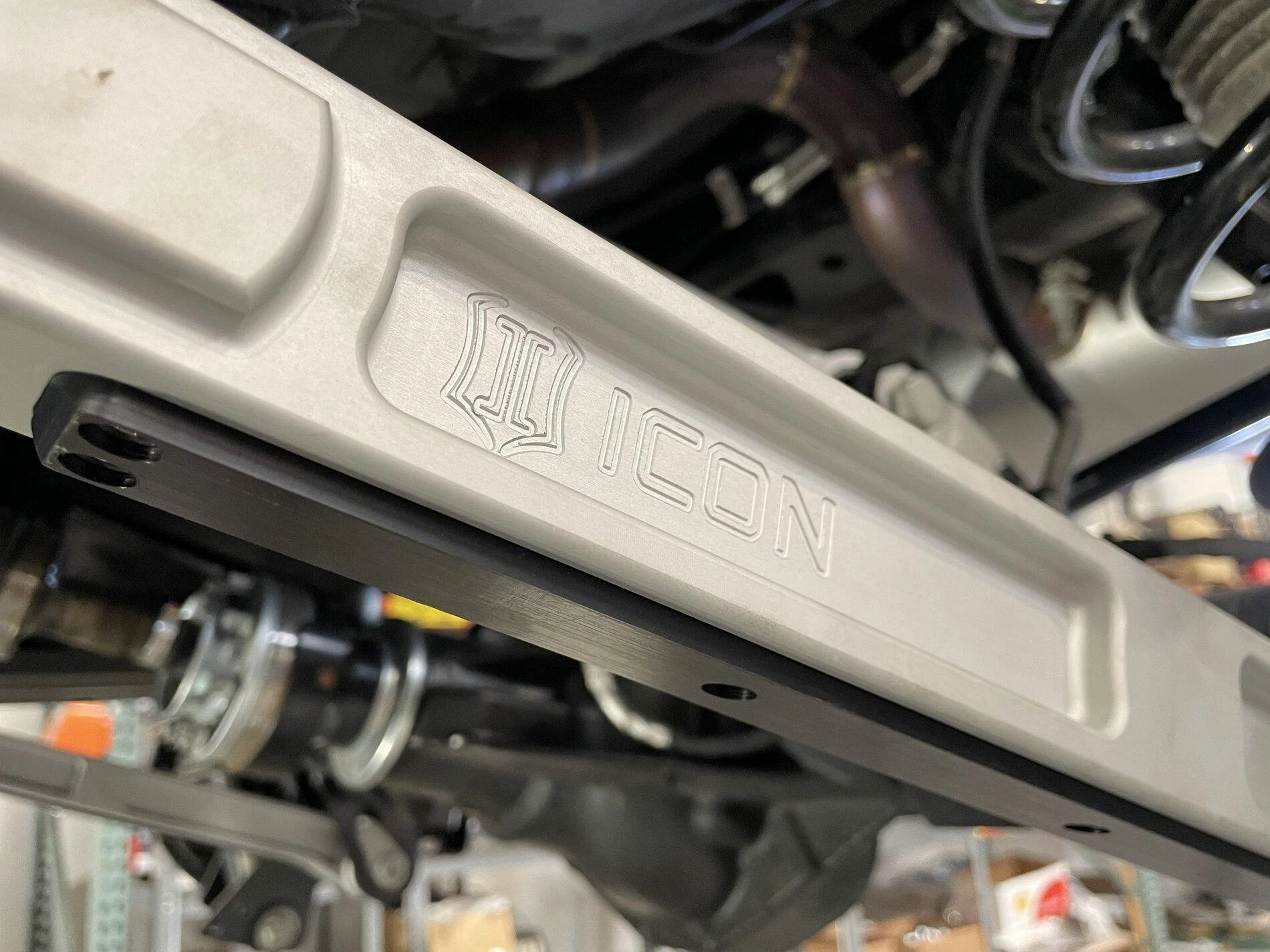

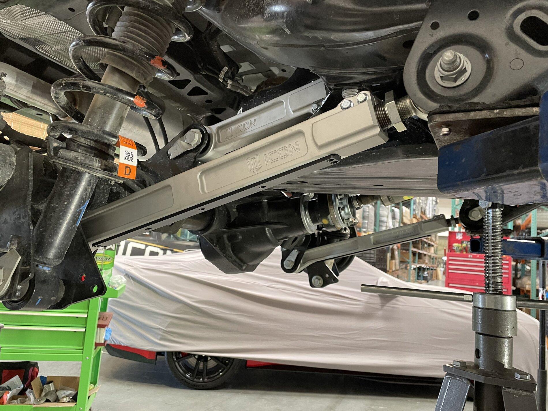

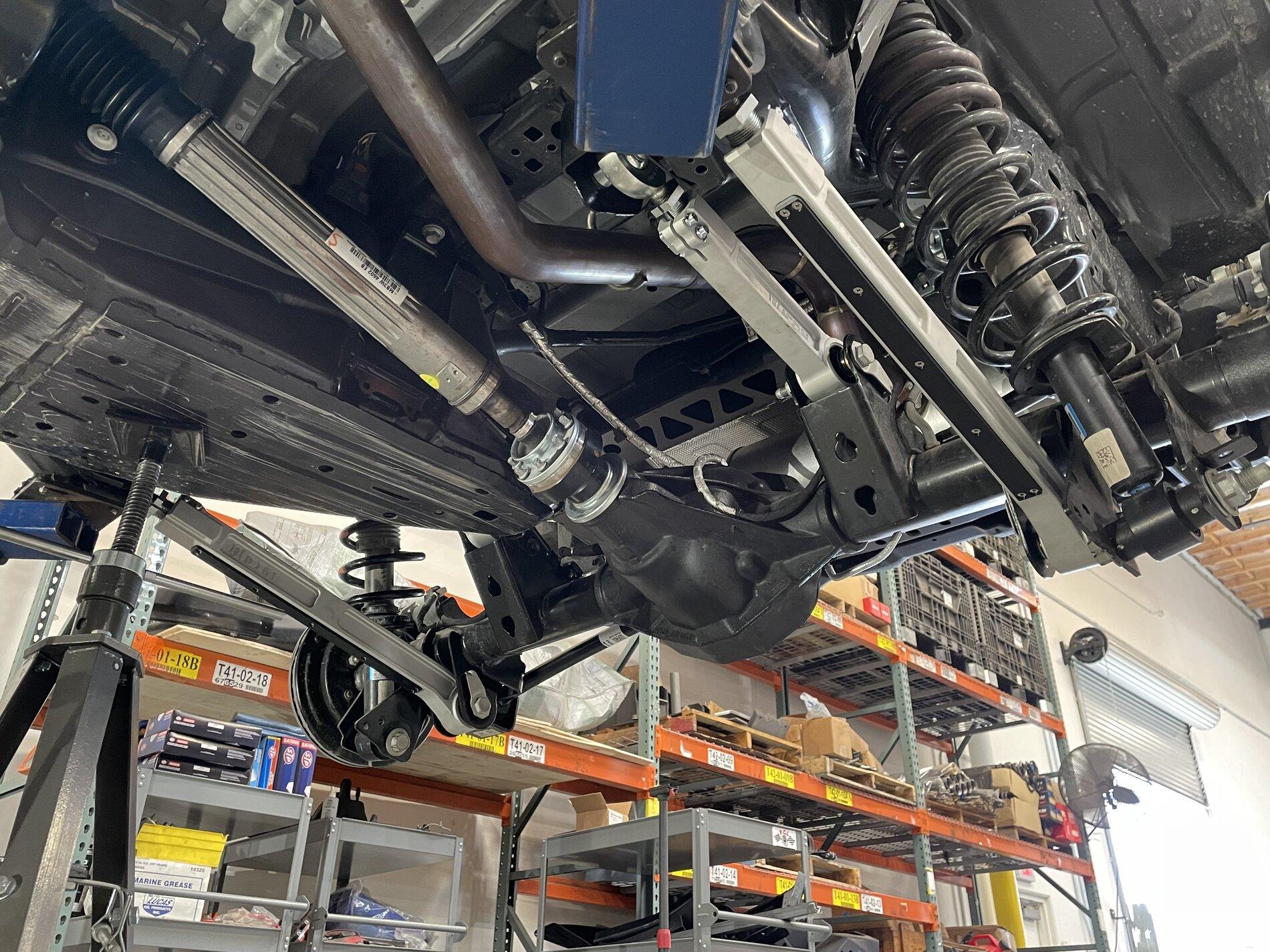

The guys at ICON test-fit some new jewelry on my 2-door Base today. These things are pretty badass and should be a nice component of the complete long travel kit they're working on for Bronco. CNC'd 6061 matte anodized, massive FK rod ends with high misalignment spacers, UHMW rock sliders on the lowers. These are first articles, not in production yet.

Just curious why are they billet and shaped the way they are vs DOM tubing with same rod ends? Is it more of a "looks" vs function?

Icon makes some excellent components. What is the material on the rock sliders on the lowers? Aluminum inserts?

function all the way and looks are a plus with these you can replace/change/upgrade ball ends, billet gonna be stronger, and notice those replacable skids on there probably gonna be spendy tho

Hmm...you can replace / change / etc ball ends with DOM (the tubing has a threaded insert welded in). Skids are definitely a plus to this style...I guess I am struggling the function is "better"? The DOM route would be considerably less expensive. @goatman where you at?

i was comparing to stock

A little bit of both. Machining them from a solid block allows the engineer more freedom of design to add features like those skids, lightning grooves, etc., and yeah they look cool too. Of course the trade-off is price. You can certainly get excellent quality and performance from a tubular arm. The billet ones will just be a next-level. I would guess ICON will also offer tubular arms since they do for the other vehicles they make parts for. The billet components are normally their top-line upgrade.

They're some sort of plastic but I didn't ask. I'm guessing UHMW but they could be Delrin or some other plastic. I'll find out next time I'm over there and let you know. And yes they are replaceable.

They're some sort of plastic but I didn't ask. Probably UHMW or Delrin. I'll find out next time I'm over there and let you know. And yes they are replaceable.
Thank you Dusty...yes, these and the RPG ones are definitely works of art! And the VMC and the cutting tools to build these are not cheap either!
