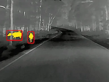

So far, this is the only thing i found with a range that would work for driving at speed. Super expensive.
https://speedir.com/nightowlplus-thermal-driving-car-camera
Yep, that is pricey but wow is that cool. I am still interested in how you may set this up. If it can truly put the picture on our 12" screen, I may still try it as a DIY, maybe after a few other mods first ;)

If I wanted to do this I'd be looking at bypassing the ford infotainment software by using an android device (e.g. https://mycarstream.com/), and then finding an IR camera that has an android app and plugging the IR camera into the android device.
