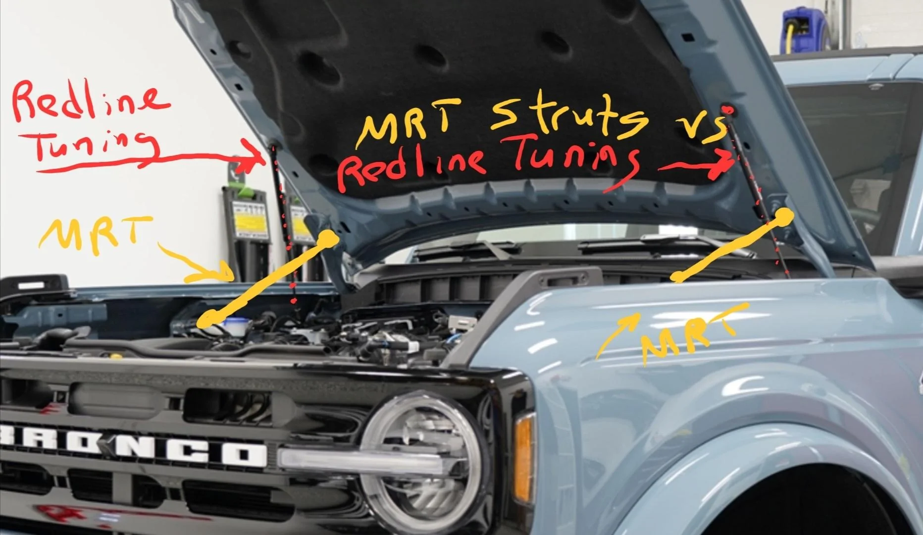

(DEC 18 UPDATE: I added 2 photos comparing the attachment design choices of the two hood strut options available, MRT vs RedLineTuning. @Tex is thinking of installing the RedLineTuning model so we can have a real world comparison. This is good for all of us. It seems that the question is, "which attachment point puts the least stress on the hood." I dont want a bent hood, which I have heard is the danger with installing aftermarket struts on OEM prop-rod hoods!)

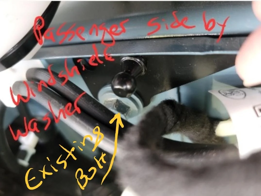

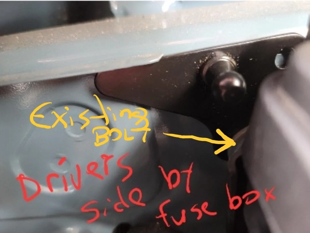

The lower brackets are installed by using the 13mm wrench to loosen an existing bolt enough to slip the bracket over the bolt, then retighten. The drivers side is wedged against the fuse box, very tight. The passenger side has more room to work, and I could use a 13mm socket. But I had to loosen the bolt more to slide the bracket into place.

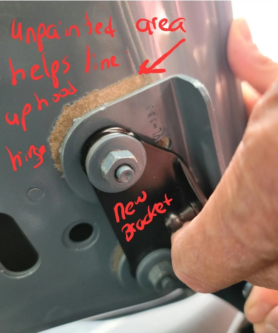

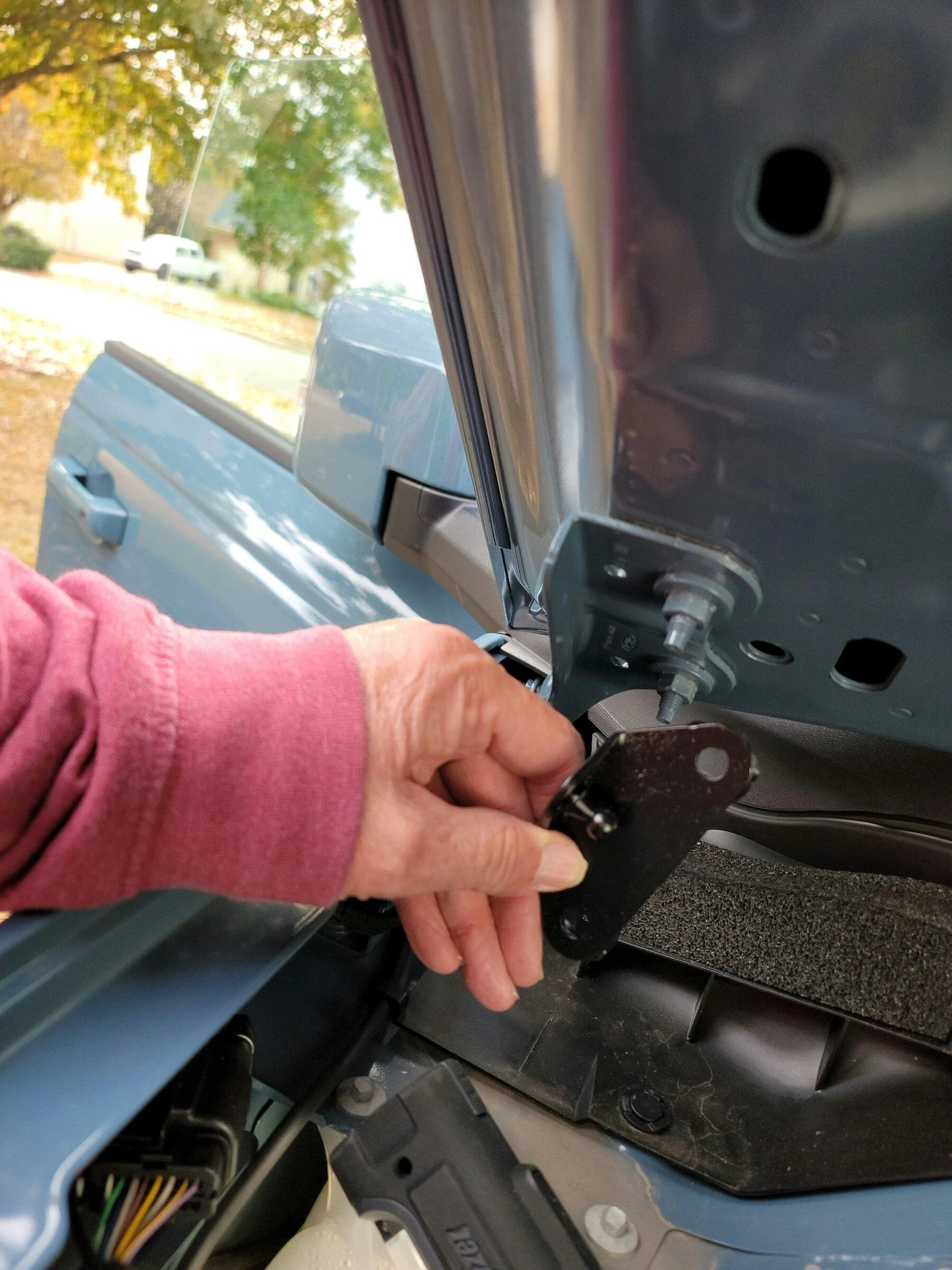

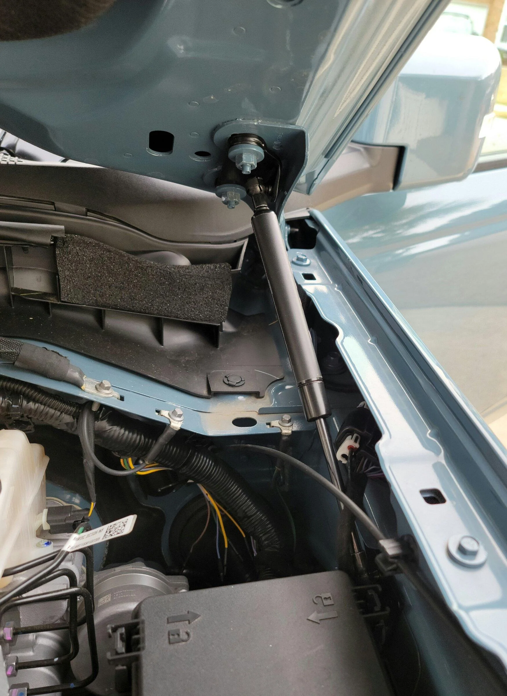

The upper brackets mount with the existing hood hinge bolts, but both nuts have to be removed to mount the bracket, and that means that the hood is moving around! I enlisted my son to hold the hood and hinge together while I mounted the upper brackets on both sides, and tightened. As the video said, the hood was painted with the hinge in place, so its fairly easy to slide the hood/hinge into position and tighten.

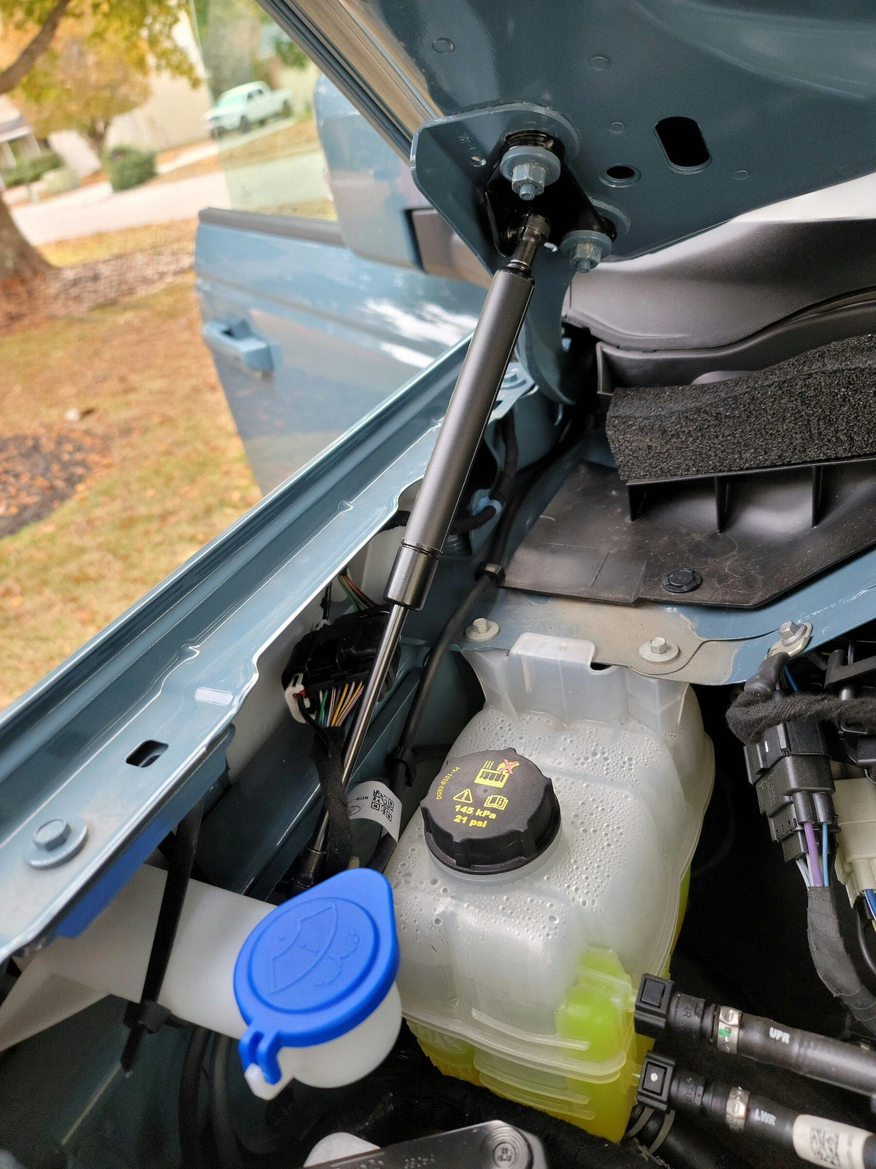

Here are shown the right and left brackets in position, and the struts clipped into their matching brackets.

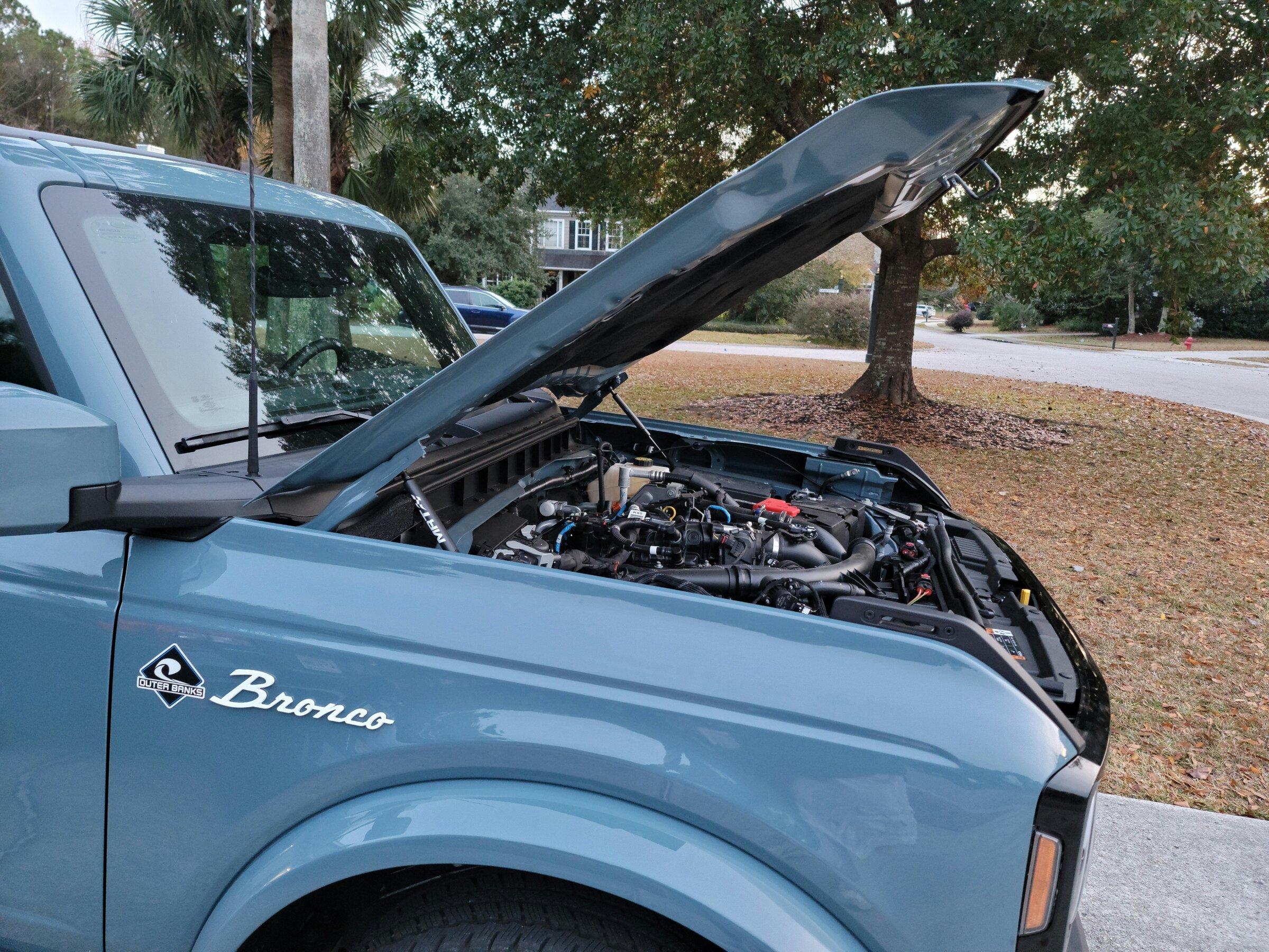

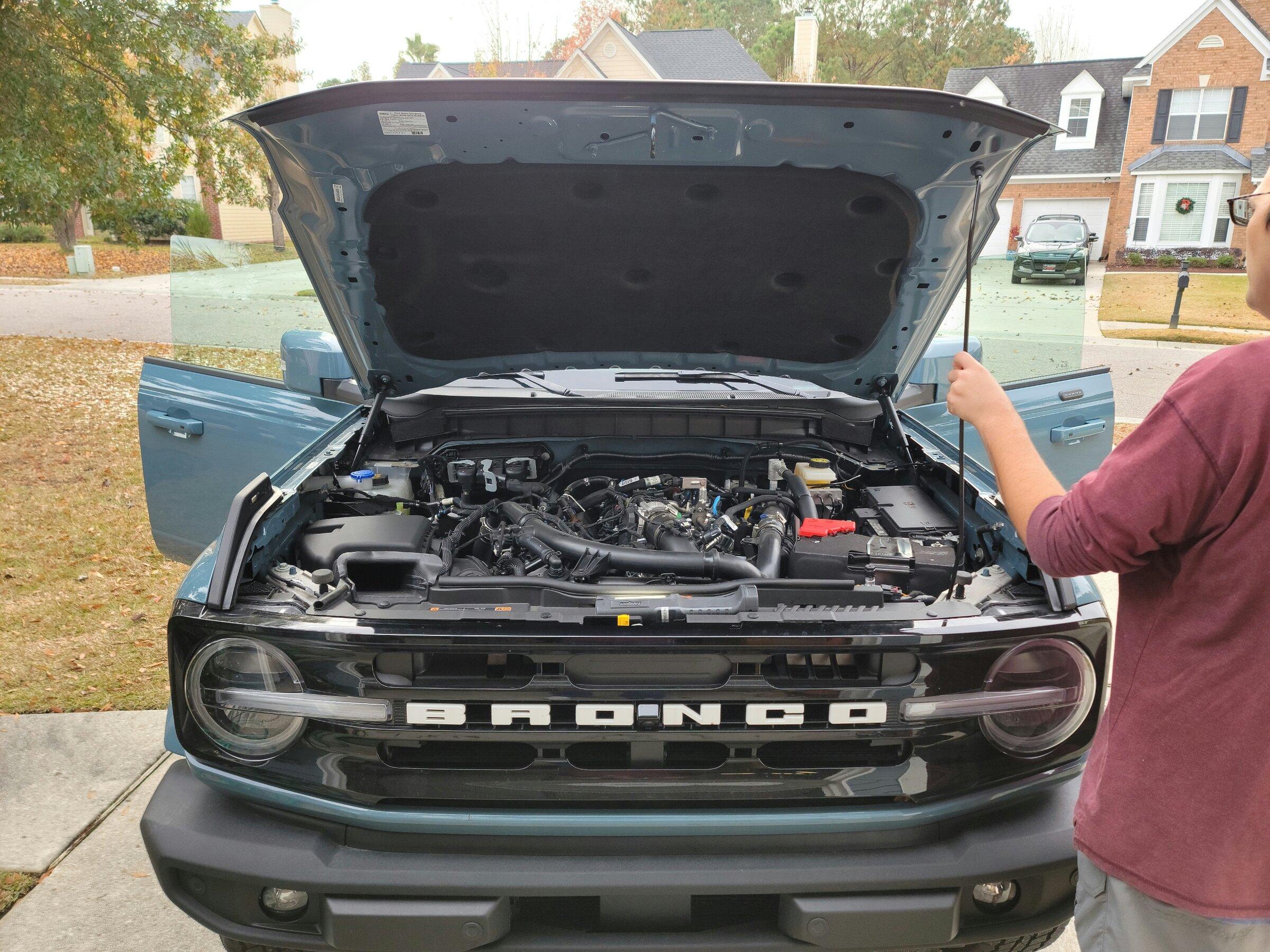

Above, my son is holding the now-redundant prop rod in position, to show that the MRT struts hold the hood a few inches higher than the prop rod, which I like because I'm tall and don't want to hit my head while pumping my tires back up after a day on the beach.
Below, the wide view of the installed MRT Hood Struts

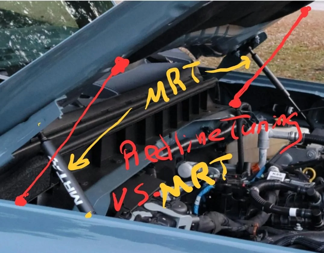

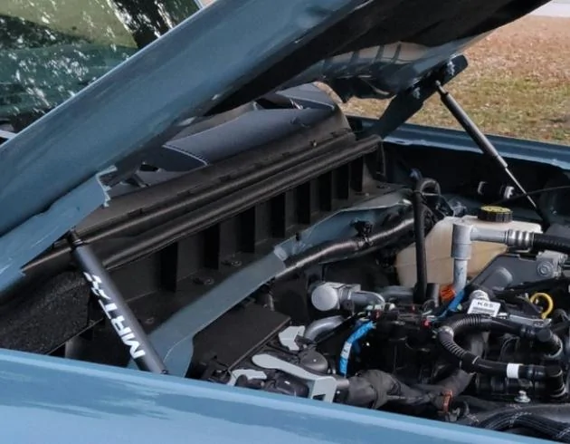

Above, a photo of my OBX with MRT struts installed (orange note). I drew the approximate positioning of the RedLine Tuning strut for comparison (red notes).
Below, a photo from RedlineTuning with their struts. I drew the approximate position of the MRT struts in orange for comparison.
Which design is better, I don't know!?

These aren't the old tough steel hoods of yesteryear. There is a little flex at the hinge where the strut is attached. The other style strut attaches 1/3 up the hood. I have no idea which is better. Or if the Ford mechanic will have a comment later.

Yes. That would be great to try the other and compare! Red Line tuning has the other system. In fact, they seem to have two choices, making choice confusing. How would I know which one I want? So I went with MRT, so far, its fine. Here's the RedLineTuning link:
I also added a photo of the relative attachment points of my MRT struts vs the Redline Tuning struts. As I noted, I don't know which angle works better, is better for the car, or puts less stress on the hood. A comparison would be great!

There is a bit of wobble or play at the MRT hinge, so Red line moved the pivot 1/3 up the hood, which could stress the aluminum hood, which is not designed for weight bearing pivot stress, AFAIK! I'd love to hear what the Ford design engineers say, but you can be sure that if either design bends the hood, it won't be Ford's fault: "We put in a prop support for a reason!" So hopefully MRT & Redline stand behind their products.
