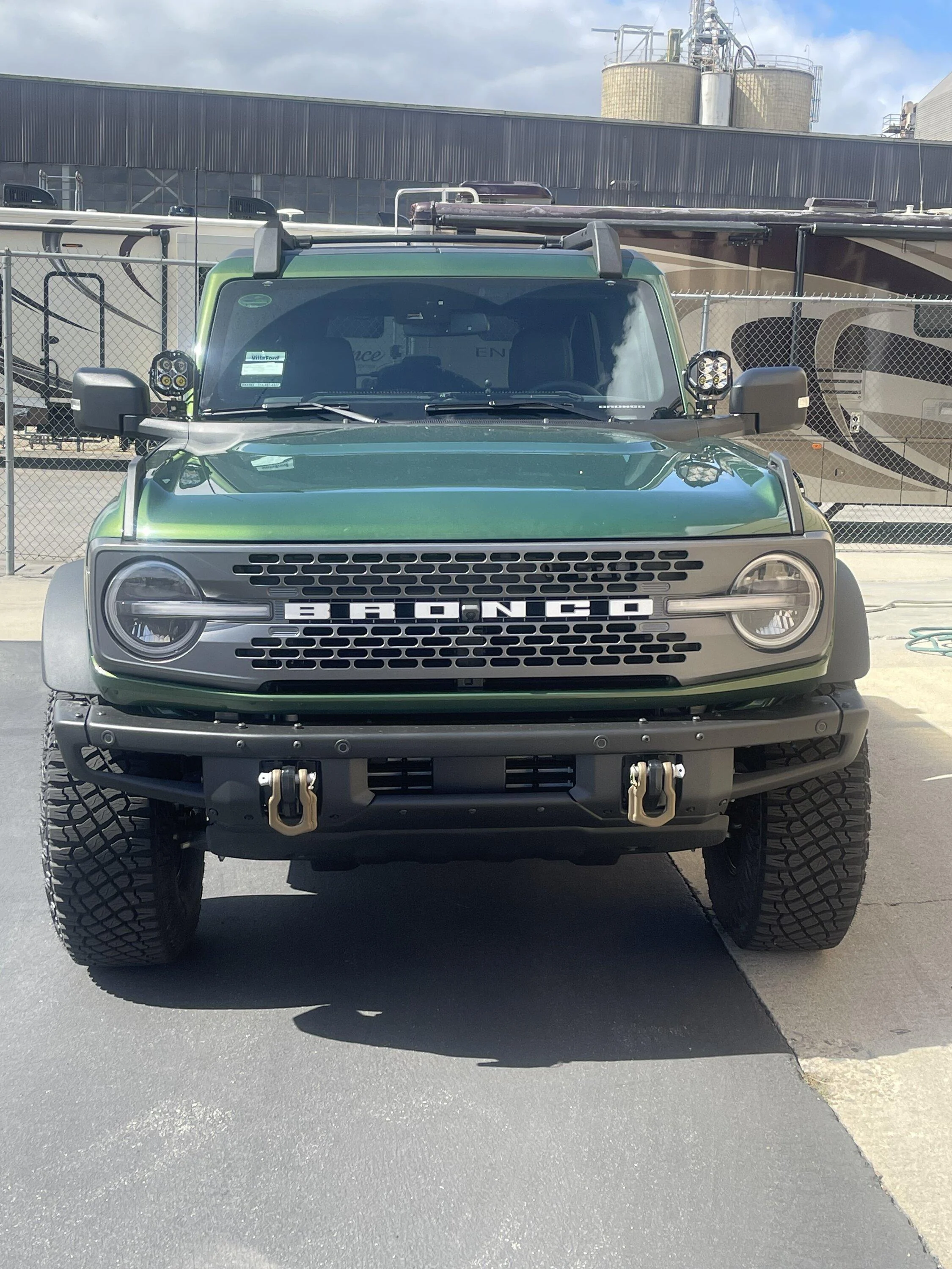

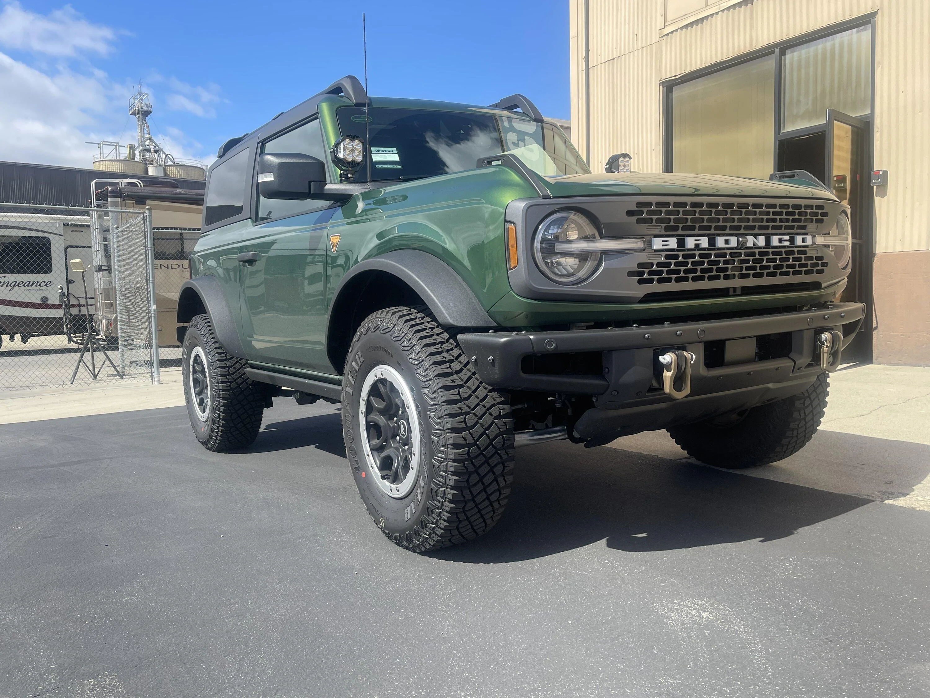

Last night I installed the Baja Designs LP4‘S on my new Bronco. I got the lights from 4x4 truck LED’S and they came with an excellent in house wiring harness. I just changed out the ends to weather pak connectors. Labeled all my aux switches and installed weather pack connectors on them so I can change switches numbers easily if I want.
These are bright! Can’t wait to take off road at night to light up some trails.
The back lights are not very noticeable during the day, but provide a nice glow at night.
