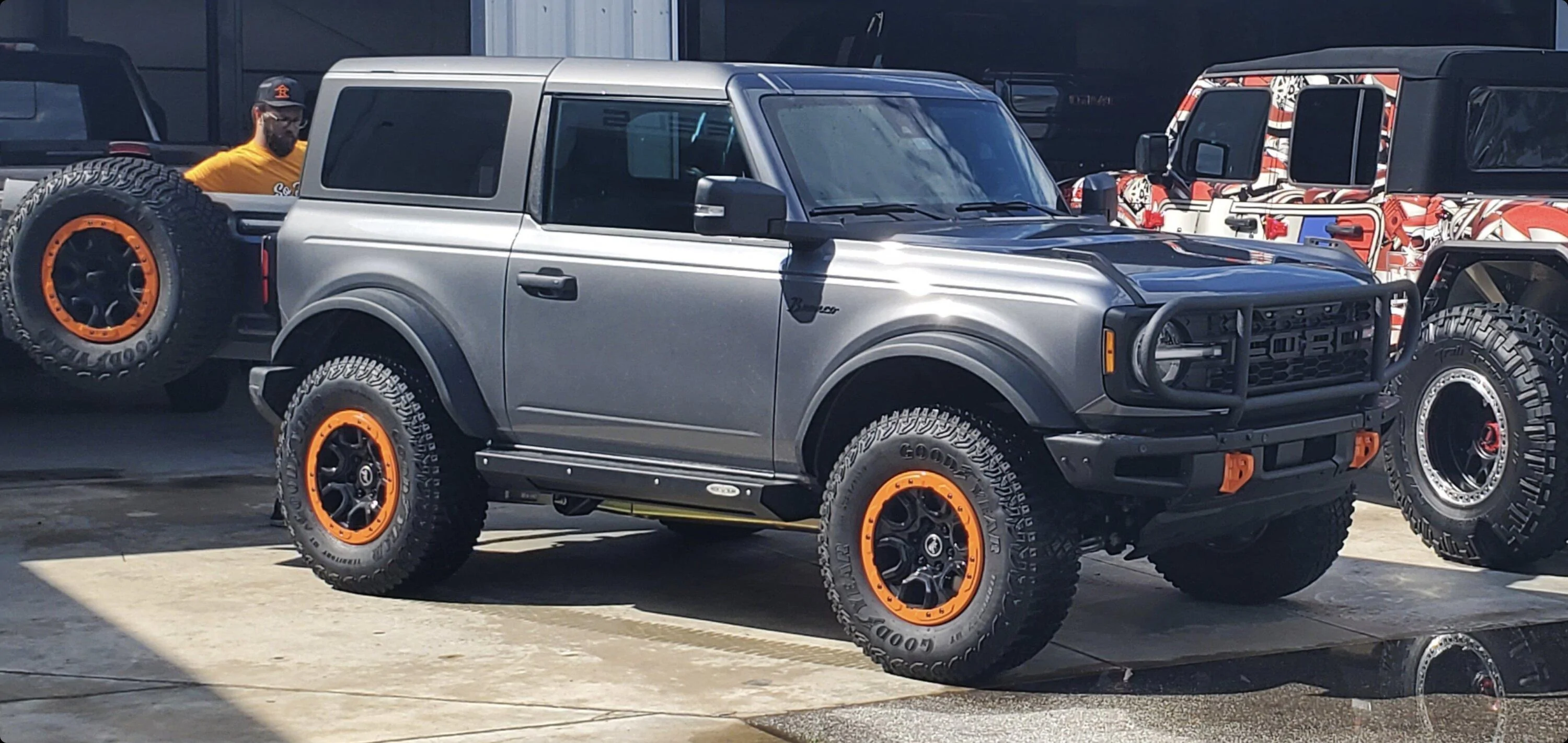

Just for anyone in a situation like me where you are planning to keep factory Sasquatch tires for a while so you aren't looking for maximum lift out of your coilovers and in fact might be looking for closer to the minimum amount of lift.
We installed Fox performance elite coilovers, Icon UCAs, Icon rear trailing arms and the RC steering rack bushings. Also installed Metalcloak skids in place of the Badlands skids.
I was not looking for a lot of lift out of my coilovers quite yet because I am keeping my factory sasquatch tires until I relocate out West and I still wanted to fit the Bronco in my garage until I sell the house, and the clearance was already down to only a few inches when it was stock.
There is probably a bit of extra weight underneath due to the metal cloak skid plates which seemed a bit heavier than the Badlands skid plates they replaced, but my total lift, measured at the highest point of the fender flare arches was 1 inch front and 1/2 inch rear. I kept a bit of rake because I will be towing a small offroad teardrop trailer.
Now if you don't add the extra weight of the skids it might be more like 1.5 inches front and 1 inch rear, but that is still a lot of adjustability down from Fox's advertised 3.5 inch front/2.5 inch rear.
So we were able to go low enough on the coilover adjustability so the gap between the tires and fenders isn't excessive when keeping stock size tires and it still fits under my garage door opening.
I have heard several people mention they wanted the Fox setup but thought it was too much lift for them staying with sasquatch tires. So just know there is a lot of height adjustability down in height in these Fox coilovers and then plenty of room to go up later when I do larger tires and tie rod upgrades.

First off Bronco looks awesome. 2nd this is great news as I would like to go the Fox route a bit down the road and I am going to stay on 35s with my 2 door. Really appreciate the info.

Thank you and you're quite welcome. I heard so many people say the same thing so I figured I would guinea pig the low lift coilover settings. When I had called Fox they didn't even have a specific answer for me on how low I could set them. This was as low as I cared to set the fronts because it looked like if you go much lower the line going to the remote reservoir might touch the adjustment collar on the shock body. And since I wanted a bit of rake left in it we set the rears according to that. I have about 5/8 to 3/4" of rake now. Factory rake measured at top of fender flare arches was 1.25".
And thanks a ton to Shock Surplus who actually sent me their demo set of Fox coilovers that they received a month ago since they were installing and testing a different suspension on their 2 door Bronco first.

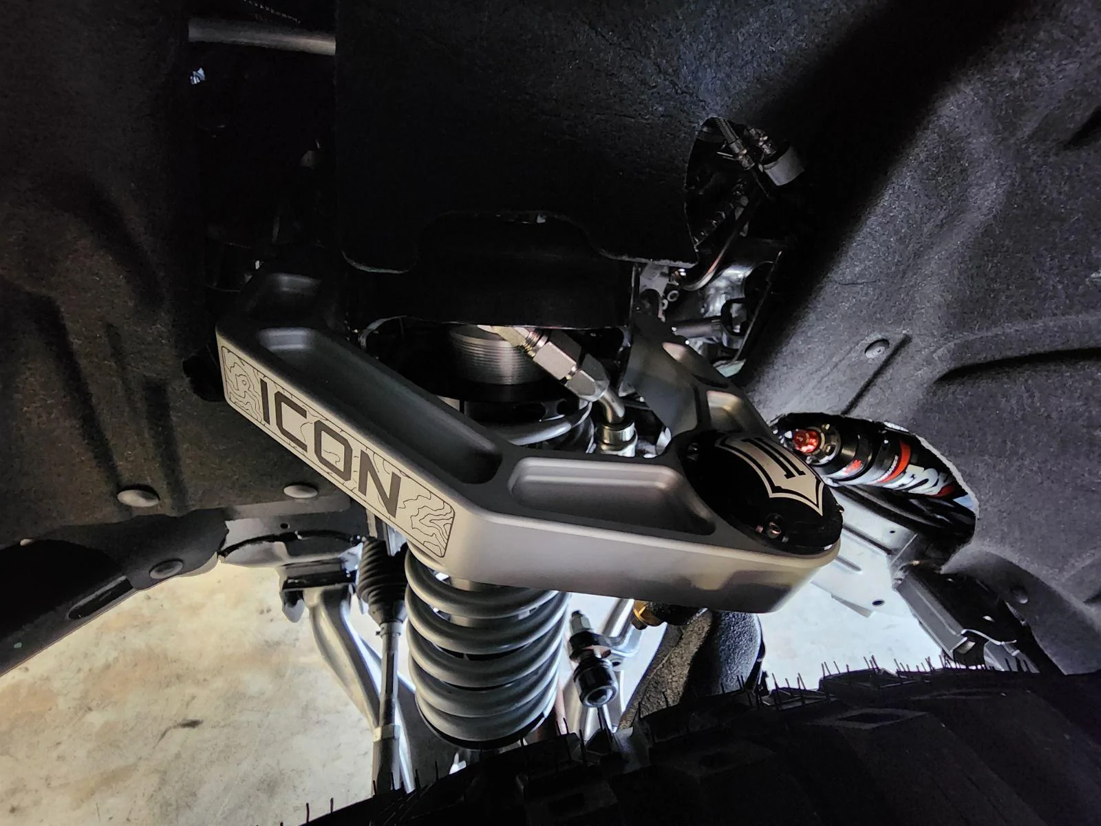

If you look through the middle of the Icon UCA you can see the remote reservoir feed line and the adjustment collar on the shock body, and I just wanted to keep a bit of clearance there.

Nice looking rig! I think the orange beauty rings are underrated. What aftermarket grille is that?

Thx. It's an IAG raptor style grill. I just wasn't a fan of my matte grey badlands grille and this one looks a little more old school and rugged. It has raptor style lights in it for those who like those but I didn't hook them up. Fitment was great, just like factory.

You sell your Badlands grille?
