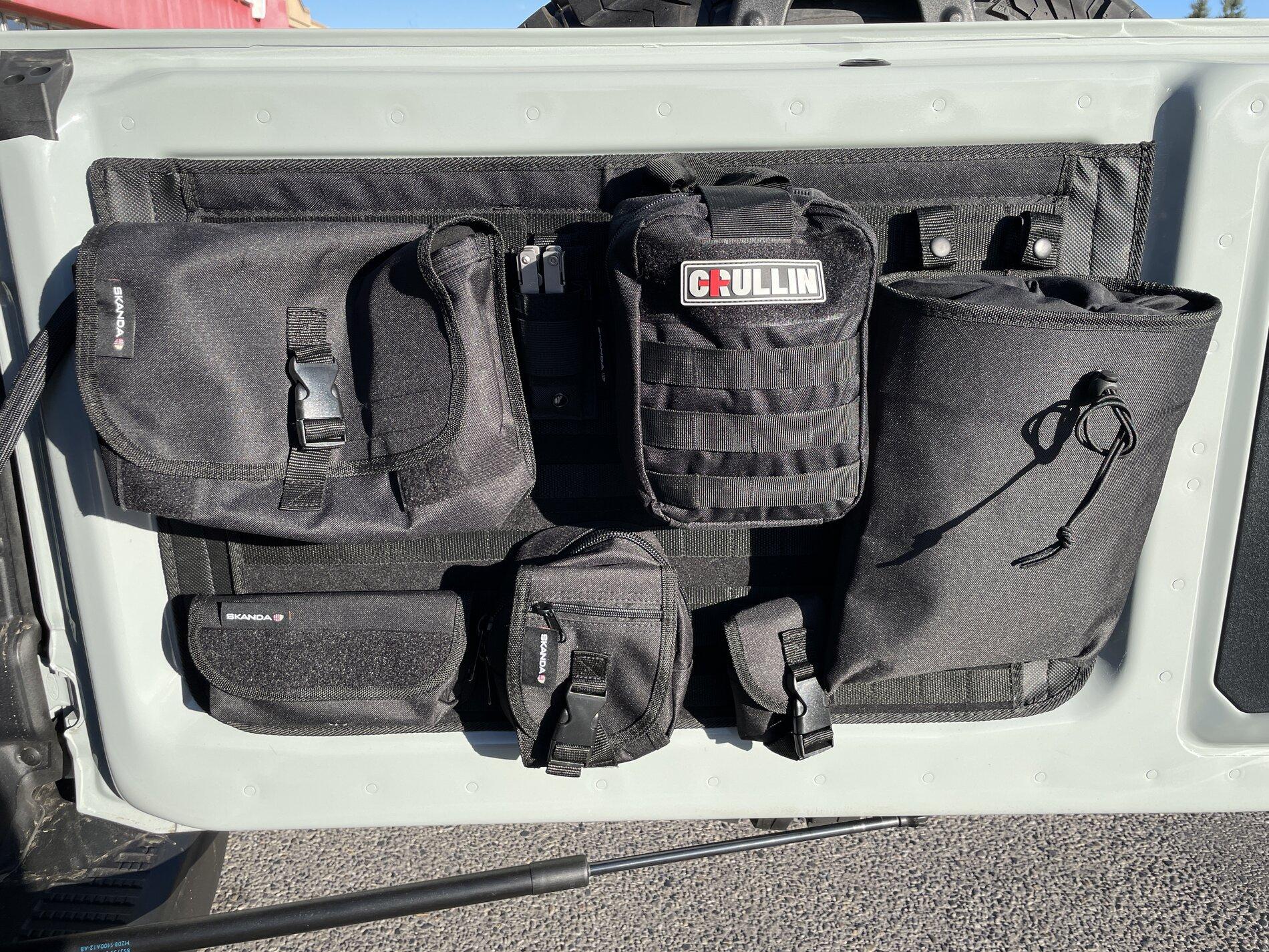

Installed the tailgate molle system today. Super easy. All the bags came with it except for the Crullen first aid kit. Word of advice for anyone installing it, remove the black plastic tailgate piece by pulling out the bottom out first. There are clips that go straight in. The ones on top have hooks and will break if you pull the top first.

No other issues. Just make sure to cut the velcro strip on the left side so your wire sleeve doesn't get glued down. Cut a little path for it.

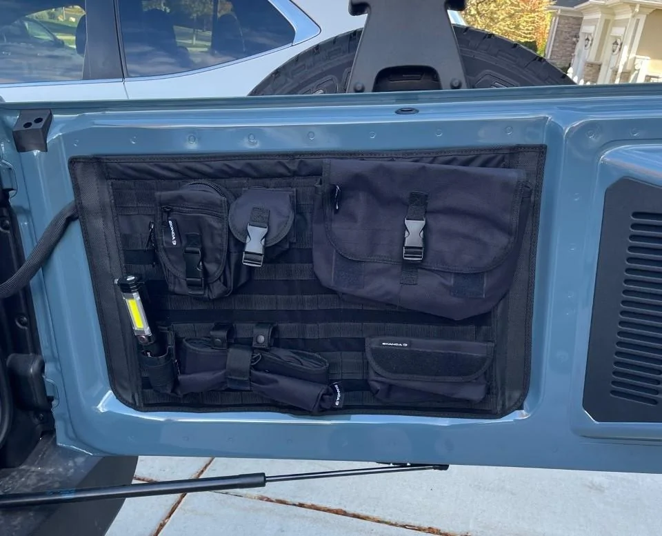

Was a pretty easy install - no problem with the straps as of yet. Need to figure out what will be the best things to mount here on the tailgate.
Ford Bronco Installed the Ford tailgate molle system today. Bronco_molletailgate (2)

Toilet paper. Flashlights. Leatherman. Golf balls.

Those are some great ideas - flashlight's there, the knockoff leatherman will be going on shortly. Maybe I can mount my putter across the back with some golf balls so I can stop at a putting green whenever I feel like!

Also jammed some old rags in one of the bags to clean my dogs feet off when he gets muddy.
