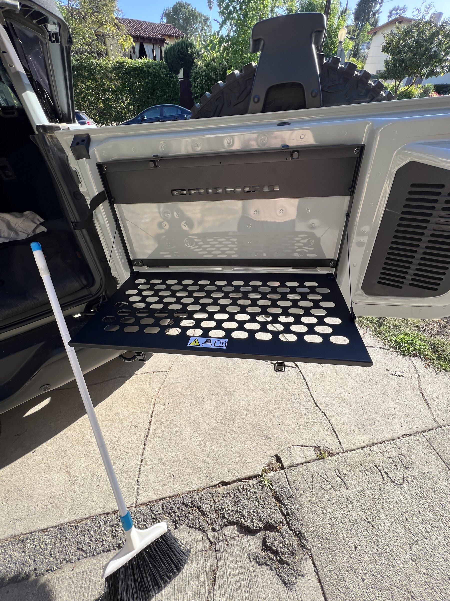

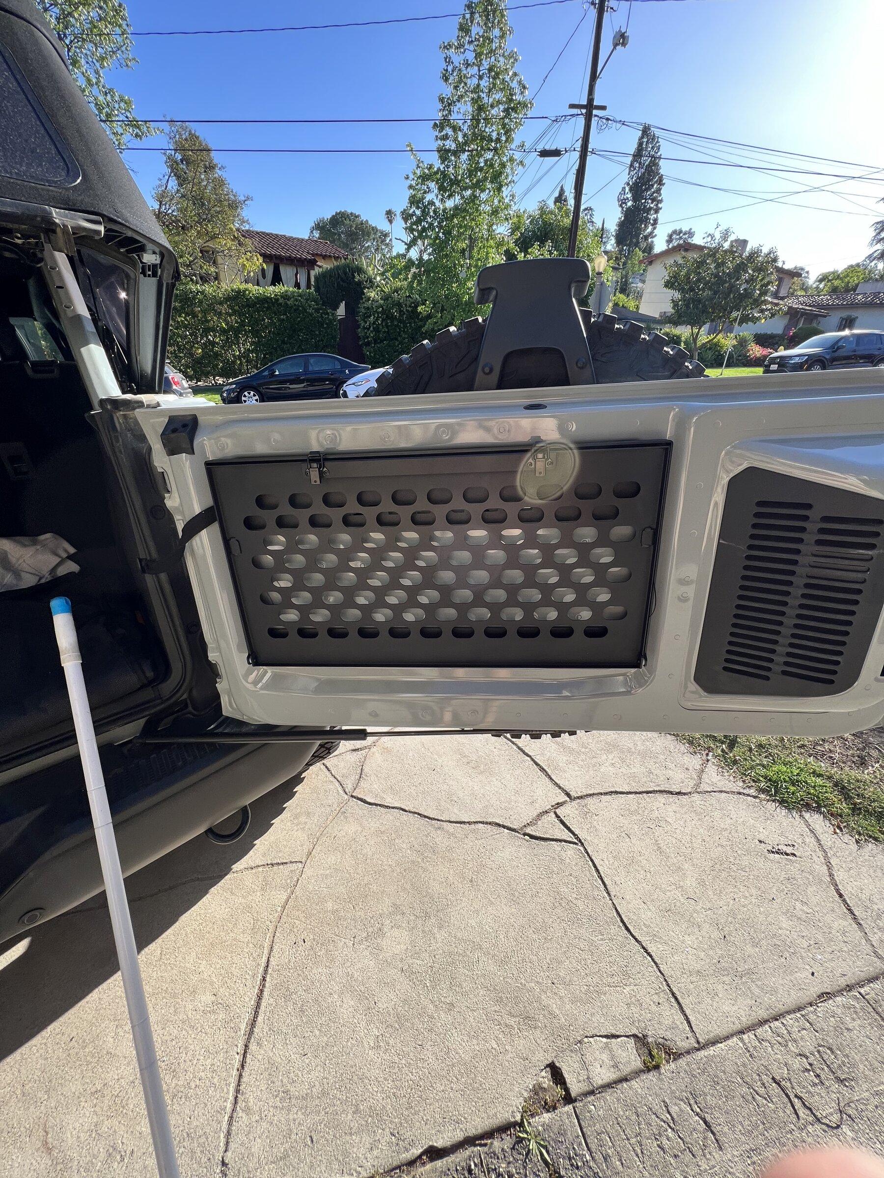

As the title says, I installed the rear tailgate table today. Once i had the proper drill bit, it was pretty easy and looks great!

Did yours not come with the drill bit and bit stop? Mine ordered 6 months ago came with them. Highly recommend using the bit stop so you donā€™t poke the outer skin.

Nice! Did you use a stepped bit? Haven't had a chance to install my table, I've had it longer than my Bronco.
Mine did come with both, and I did use the bit stop. The drill bit was too big to fit into my power drill, so to home depot I went.

What's your opinion of the quality of supplied jack nuts? Break any during install?
A few months back I read someone recommended buying some to use instead.

they're shit. One broke during install but it was already in there and i was still able to secure the bolt to it so doesn't seem to be an issue but yeah, had I known that I would have gotten my own hardware.

Any other tips or things you would have done differently (aside from drill bit stop and jack nuts)? Havent installed mine yet.

it was easier than I thought it would be. The drilling is a bit scary but it worked out no problem
