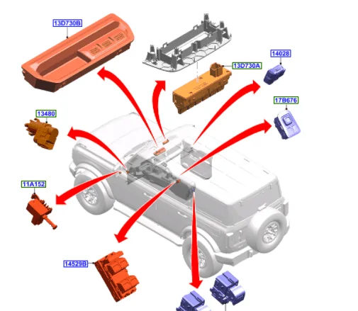

The biggest factor is if the harness going up to and coming back from the overhead console is there. This will require the overhead console be removed to check. I'm going to assume the relays are in the fuse box since non-trailer tow vehicles have trailer tow fuses installed from the factory.
Ford Bronco Installing overhead aux switches after sales? 1627728633482

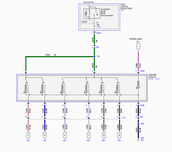

Did your Super Duty switch assembly looked like this?
I tried to do an image search for the part number that @flip posted, but it’s so new, there were no images available. The Super Duty switch assembly showed up during the same search, though, so I’m assuming the two switch assemblies might be similar even though the part numbers and actual dimensions and features are probably different.

What’s the difference, if any, between the Super Duty part and the Bronco part that you posted earlier? They both seem to have the same secondary number in the full part number (highlighted), and they physically look the same? The plug location, maybe (right side for Super Duty and left side for Bronco)?
Ford Bronco Installing overhead aux switches after sales? 53C6093C-D9E3-40F6-A724-D64A344E141E
