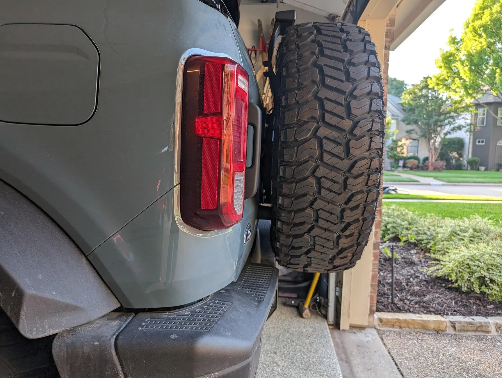

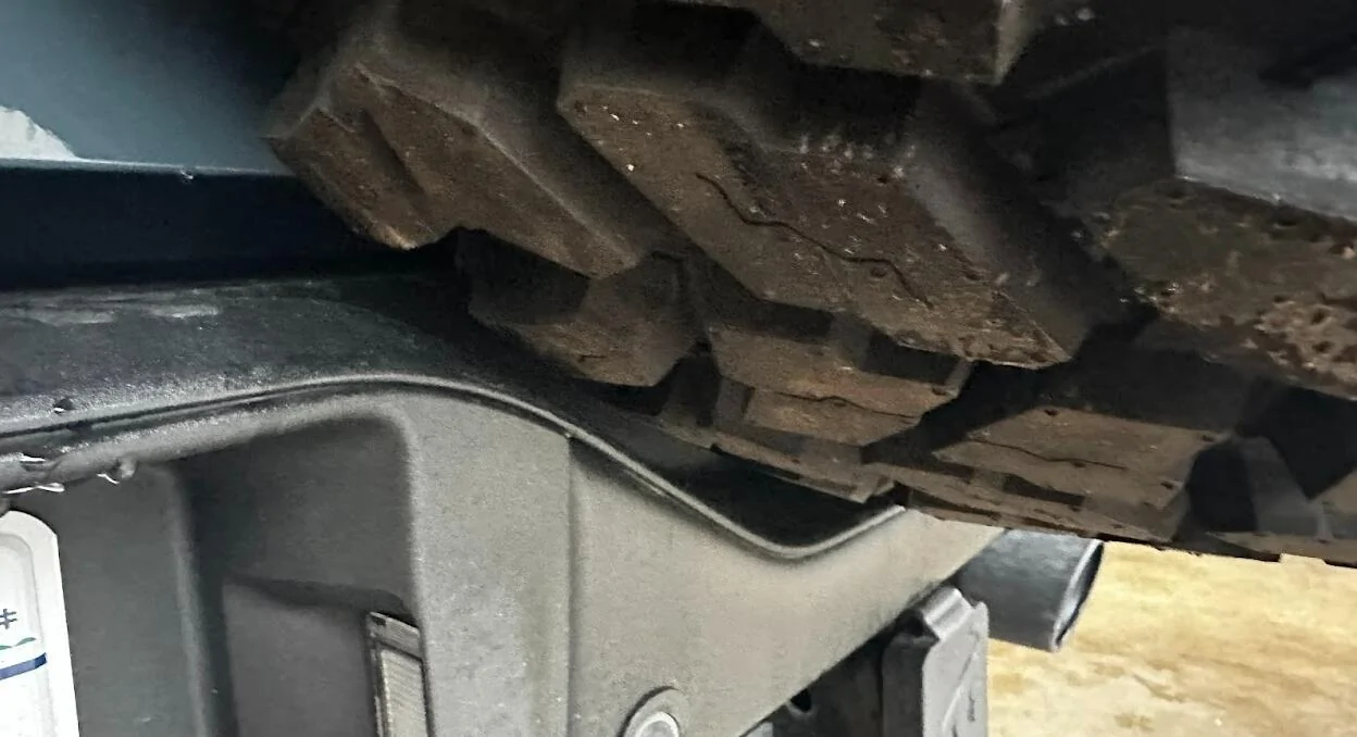

Hello All! I thought I would share an interesting use for a 1/2" body lift. I purchased a 1/2" body lift from a guy on Etsy last week and installed it right away. It was a super easy install, and after some front bumper realignment the gap is acceptable to me. The rear in my opinion is going to need some work yet.
BUT here is the real reason I did the body lift: It gave just enough clearance on my spare tire mount to still use the stock Sasquatch Rim with our new 37" tires. See the pictures. I added a tailgate reinforcement and brake light relocation bracket, and despite the manufacturer telling me it would give clearance enough for 38's the tire still rubbed the bumper. I am guessing they assumed I would have gotten a different offset rim that would have made it all work. My wife and I are going for that "Factory Plus" look and didn't want to change out our factory rims.
I thought this would be good information for those out there with a similar issue. Cheers!

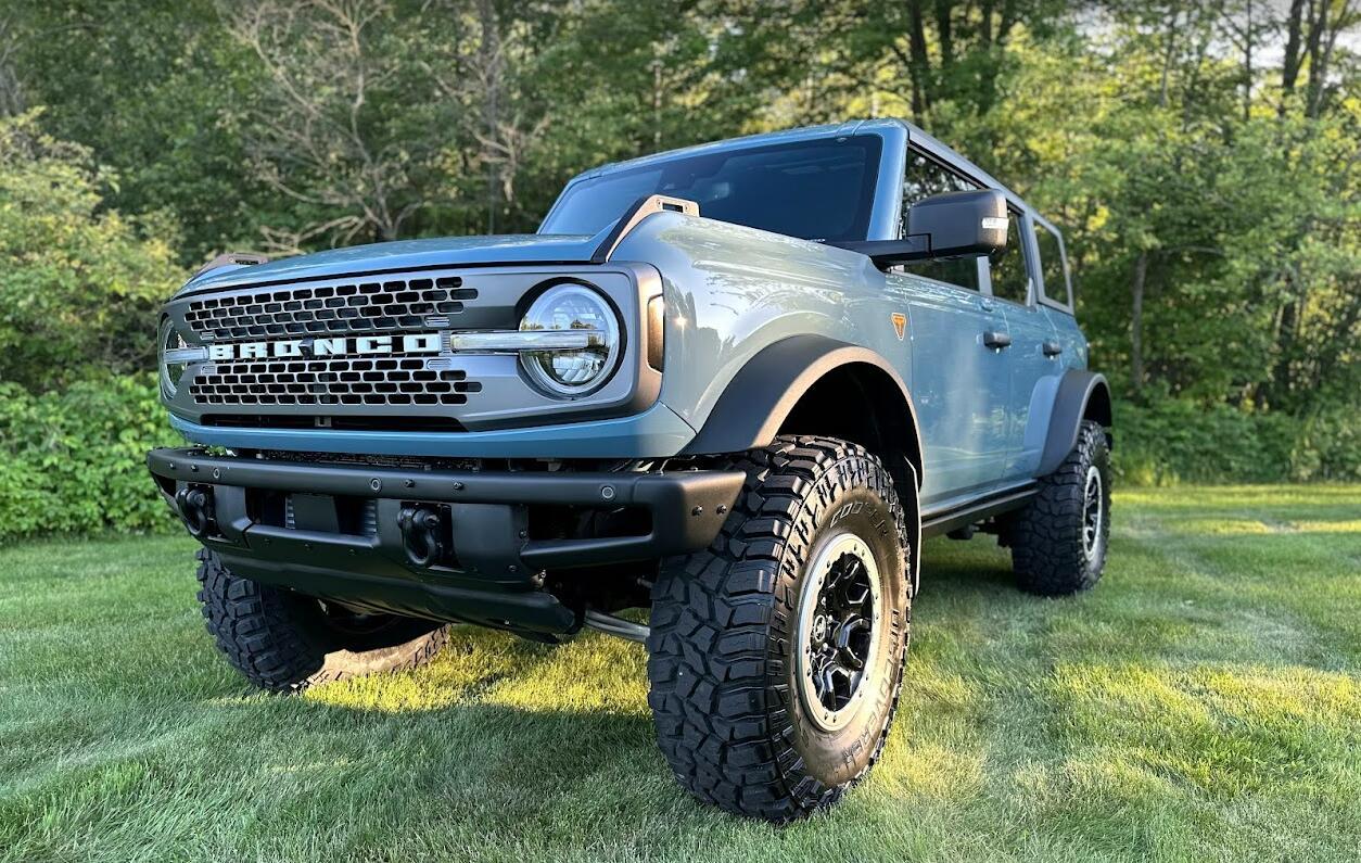

37s on my SAS wheels with those same great tires! 🫡
I added the 2.5in RC lift to my 21 Wildtrak.

They make tire carrier options for addressing at least the spare issue.
I know, but this way was pretty cheap and had the plus of adding just a bit of extra height/tire clearance. :)

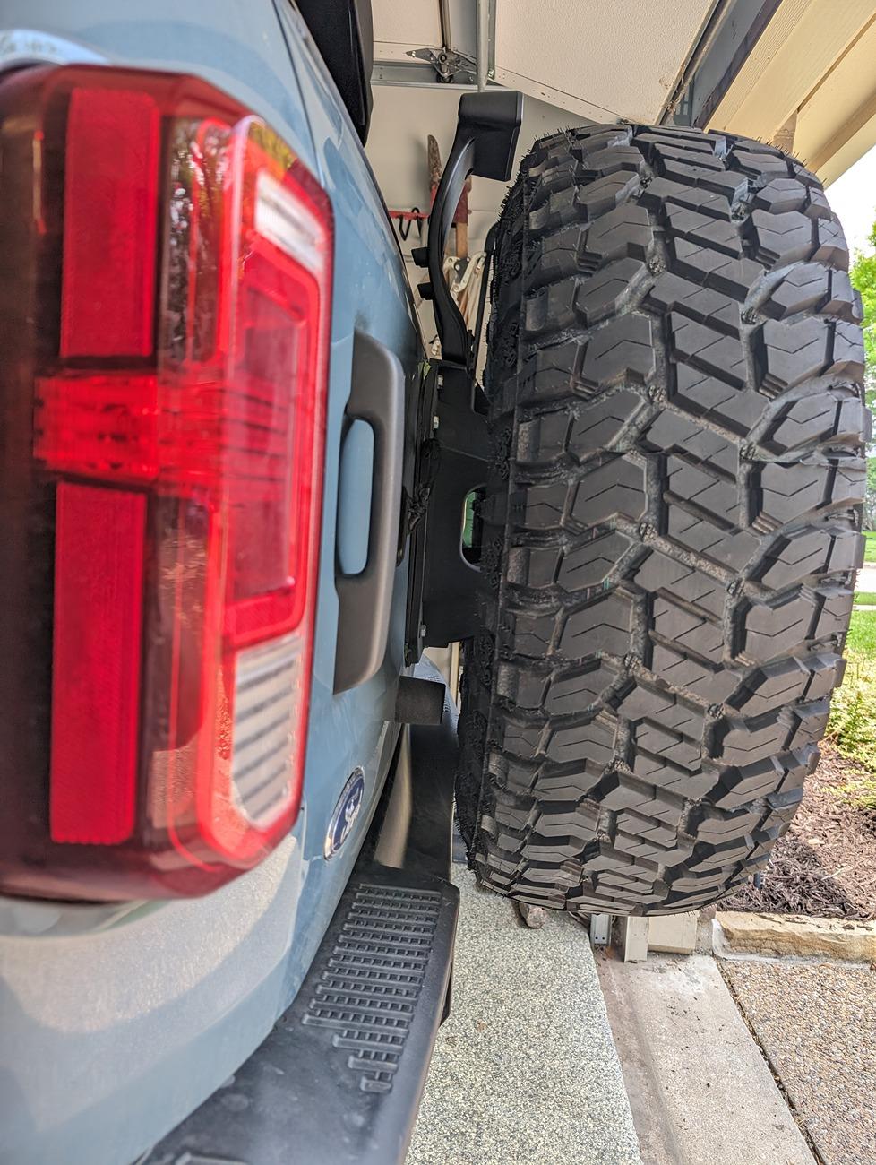

Also forgot the reason I came to post in this thread. My 37s were fitting on the stock carrier + a cheapo Rough Country reinforcement just fine. Mine is a Black Diamond so came with different offset (-55) and my aftermarket wheels had yet a different offset (-6) so not the same situation as @Denny3297 . I say it fit, but the tire was no longer resting on the bumpers. I ended up replacing the carrier with the Turn Offroad adjustable carrier and you can put that tire pretty much anywhere you want it. Lots of options if you want it high for clearance, or low for back window visability.
Before:
Ford Bronco Interesting Reason for a Body Lift: Clearance For Spare Tire Mount w/ 37's PXL_20240519_171205338.MP
After:
Ford Bronco Interesting Reason for a Body Lift: Clearance For Spare Tire Mount w/ 37's PXL_20240519_234709606
