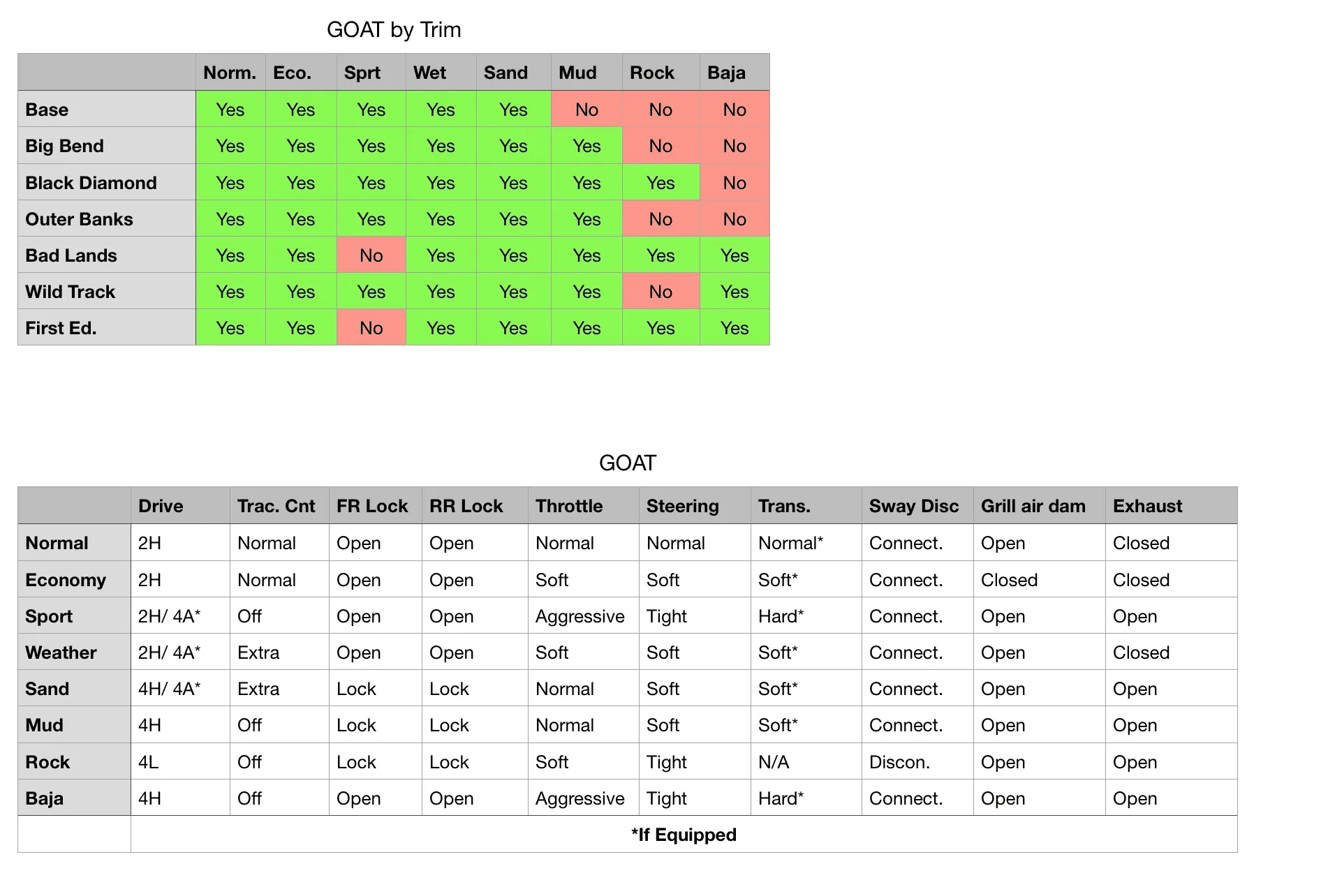

So can anyone explain to me the unlocking of GOAT modes...?
I'd greatly appreciate a thorough explanation! 🍻
For Reference:
Ford Bronco Introducing PandaScan, Our Remote FORScan Service! 1675261884951
For those Badlands folks - you're gonna want Sport Mode - it's all I use.
