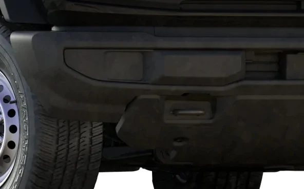

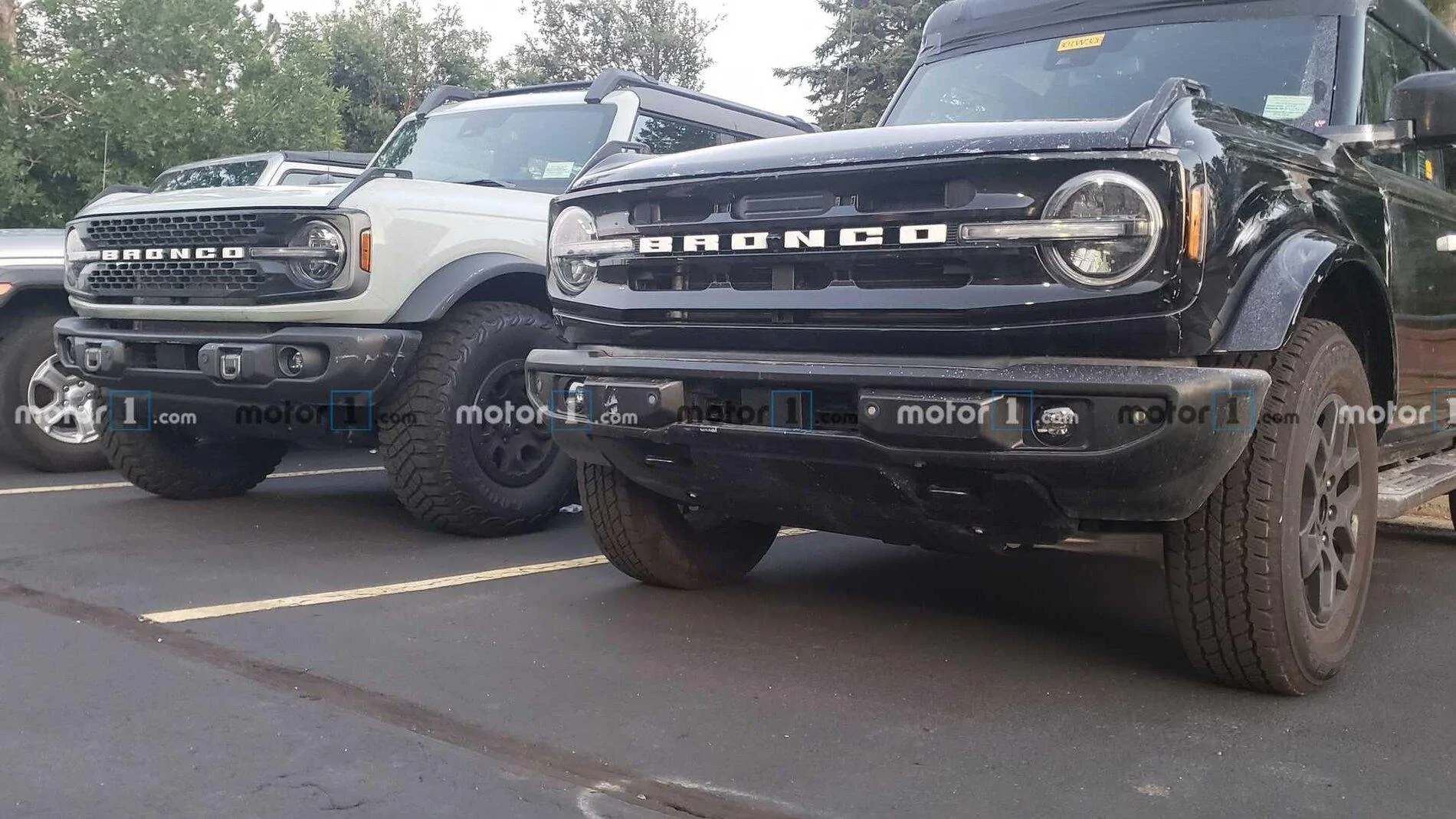

I know there will be base plates available from Blue Ox et al, but I tend to go my own way. Models with the Modular Bumpers have D Ring mounts and most tow bar manufacturers have D Ring adapters. But the D Ring mounts are quite high, requiring quite a lift on my motorhome hitch. Looking at trims without modular bumpers they have a low mounted tow loop that would be about the right hitch height. Any guesses if this would be stout enough for a tow bar mount? It's stout enough to yank the rig out of a mud hole right?
Trying to decide if I should opt for the modular bumper, I like the looks and the D Ring potential, but the standard bumper set up looks more adaptable to towing.

The lower loop is in the lower left of the photo, the D Ring mount is on the end of the frame horn.

I've been studying the bumpers/frame to predict towability, haven't come to a conclusion yet. I think the D ring mounts would work fine (don't know about winch compatibility). They come with the modular and I believe can be added to the standard bumper. For my application I think they are too high, maybe 24-28". My current set up is 20" off the ground. It appears that the tow loops on the base bumper are about this height, I just have to see if I can replace them with tow bar brackets. Then I would add D Ring mounts up high for safety chains and D Rings for mud holes.

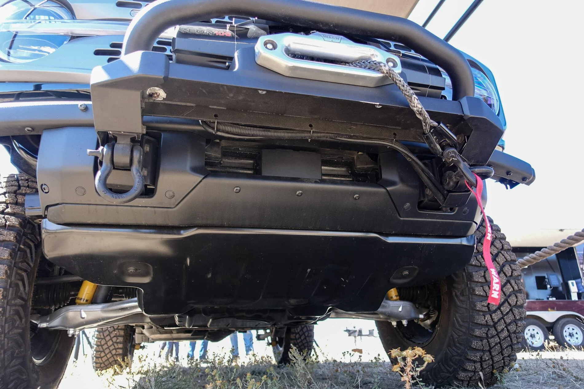

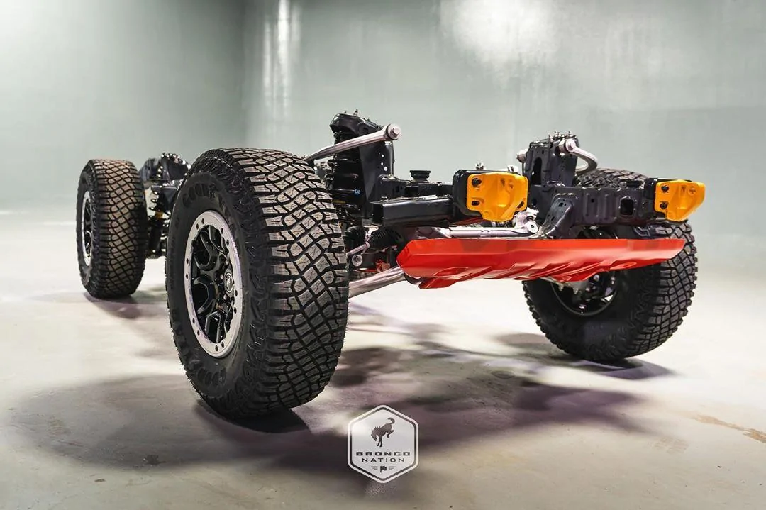

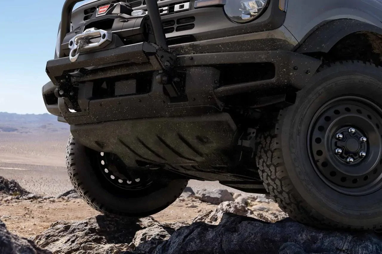

I don’t know the first thing about flat towing, but I do think I know that the ford winch attaches to the frame where the shackle mount. Both the Modular and the capable bumper leave this area open. The base bumper covers it up.

Did a close look at the Auto Show in OKC. Both units had winches mounted.
Upon close inspection the end plates on the winch are just a covers. Looks like there is enough room for the Blue Ox adapter to fit, would not be a issue to trim off some ot the end plate if necessary.
The biggie is the D ring mounts are at least 1 1/8 inch thick. The Blue Ox adapters have a 1 inch opening for both 7/8" and 1" pin.
I will have my calipers with me when I go to the Tulsa Auto Show. There will Two Bronco there probably the same two that were at OKC.
