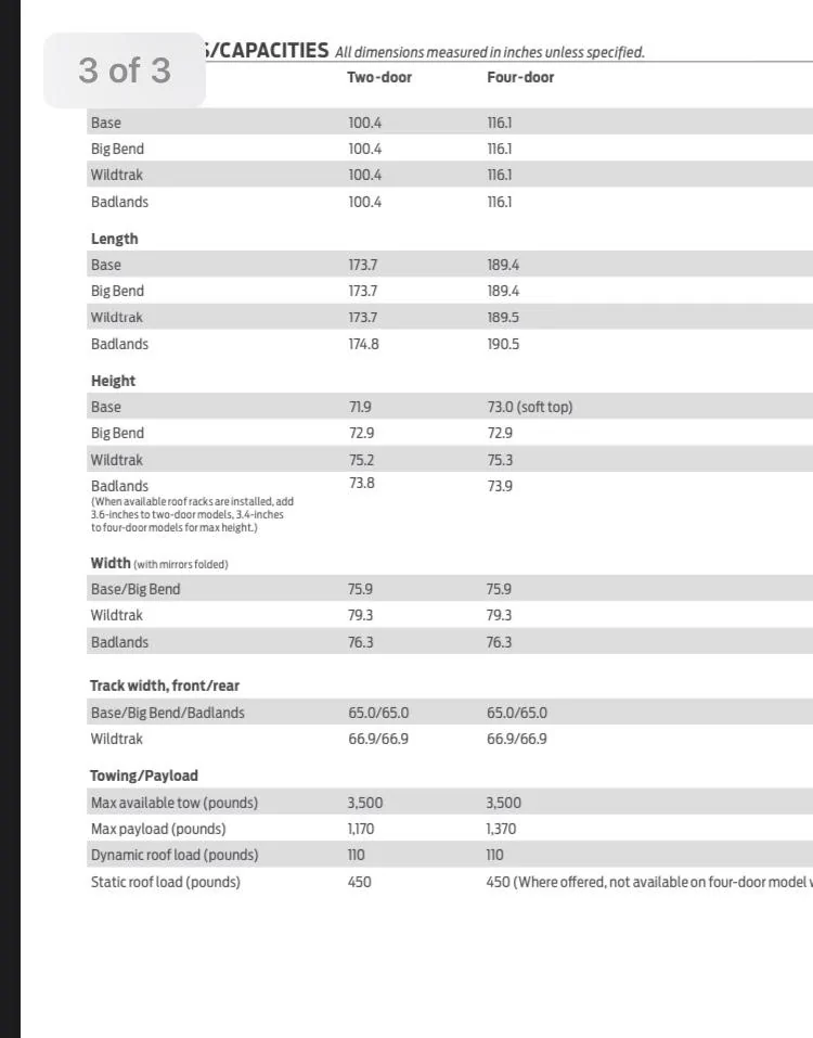

Nope, nothing to do with engines for towing/payload. And curb weight doesn’t change payload or towing cap either. Payload is on top of curb weight not part of it. 4dr is 1370 payload, 2 dr is a bit less. Some options would take away yea cause they count against payload, but are also removable when towing something and wouldn’t effect the rating. If there is a limit/change to payload for models/engines ford hasn’t said yet. Only one payload rating for 4 dr and one for 2 dr that I’ve seen anywhere.

Payload is max 1370 on a 4 door. So realistically optioned out 1170. 350 tongue weight plus 150 junk in the truck leaves 670 for occupants. You may be over combined weight if your running an unbalanced trailer that is heavy with a light tongue weight plus weight of hitch. So you are on point. As long as axle and combined rate was good there is a margin.

Max payload is GVWR-Curb weight. If Ford wants the Bronco to compete with Wrangler they have to stay under 6,000 GVWR otherwise its in a completely different category. It doesnt mean the vehicle cant technically carry more. That would be the official safe rating from Ford. The payload on the Bronco is listed as 1350 max because a GVWR of 6000-the base model curb weight of 4660 = 1340. As you add features and accesories this payload rating goes down. The highest listed curb weight by Ford is 5320. This leaves only 700lbs of payload.

Um.. those are max available. I don’t think you get what I’m saying. Payload= GVWR- curb. So if you put a engine that weighs 200lbs more and nothing else changes like wheel base or suspension you just lost 200lbs of payload. If ford is capping the Bronco at a 6k to stay in class with the wrangler and projects the curb weight in the pic that’s a pretty big difference in payload based off of configuration and options. So the way I see it curb weight effects payload and towing not so much gvcwr as the amount of tongue weight you can put on the bumper as that is part of payload.
