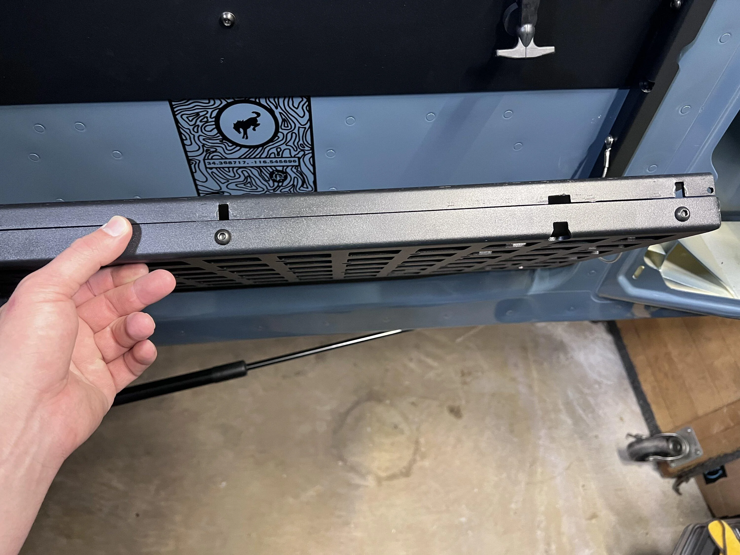

Has anybody with the JCR Offroad Tailgate Table had an issue with the table surface not fitting inside the MOLLE casing? I got all the way to the end and it at best, the front of the lid just sat on top of the MOLLE casing.

Yeah, watch their youtube video. It's tight, I had to use a screwdriver to pry it in. Once you get it in though, it's a lot easier to remove and replace. Their video helped me, just be patient with it.

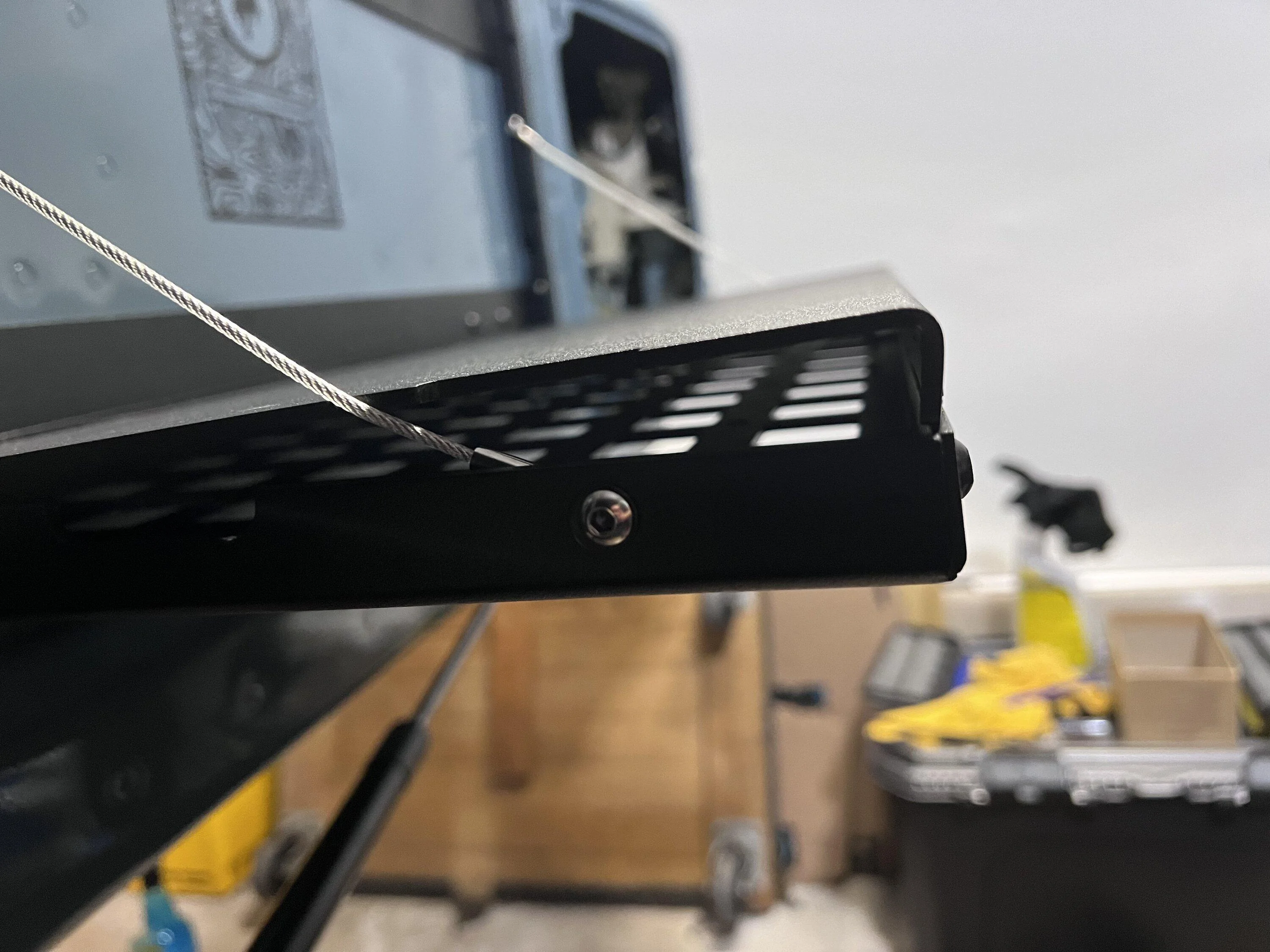

Update: Never got a response back from JCR, so ended up hammering the edge of the table surface slightly inward with a 4lb soft mallet and was able to get a snug fit (no rattle).
Ford Bronco JCR Offroad Tailgate Table Install Question/Issue F3BE1A98-DF1E-49E6-B3ED-5978FE5E84B7
I did have to do some minor cosmetic repairs (paint over some small chips). The install wasn’t a great experience, but it’s a solid product. Glad it’s done!
