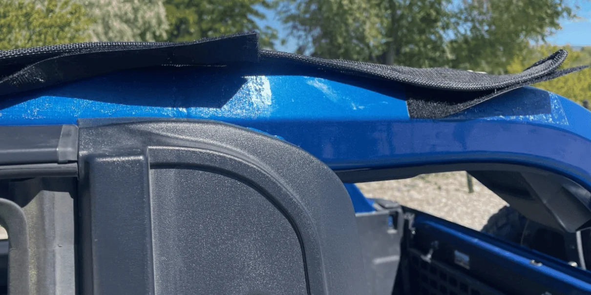

I had the same issue with mine. Installed the velcro last Thursday, didn't put the actual mesh top on until Saturday evening. Sunday afternoon at the lake with the bronco sitting in the sun it looks like this. I love the design, the magnets are comically strong hahaha, and it does not flap going down the highway. I'm thinking this crazy heat just melted the velcro side of the adhesive. They sent me an extra like 3 foot section, i'm going to clean it up and re-apply it this week and see how it goes.

We are going to need to send you a replacement kit. Once the acrylic separates it will not bind again. Please send a request to [email protected]
When you get the kit there will be instructions on the proper installation. Even moving it during installation can have an I’ll effect.

I followed the instructions in the original kit. I don't think I place it and repositioned at all. The rest of it seems to be holding very well. Just the spot that was baked in the sun that day at the lake.

I’ll send extra and a couple alcohol wipes and adhesion promotor. What was your order number?

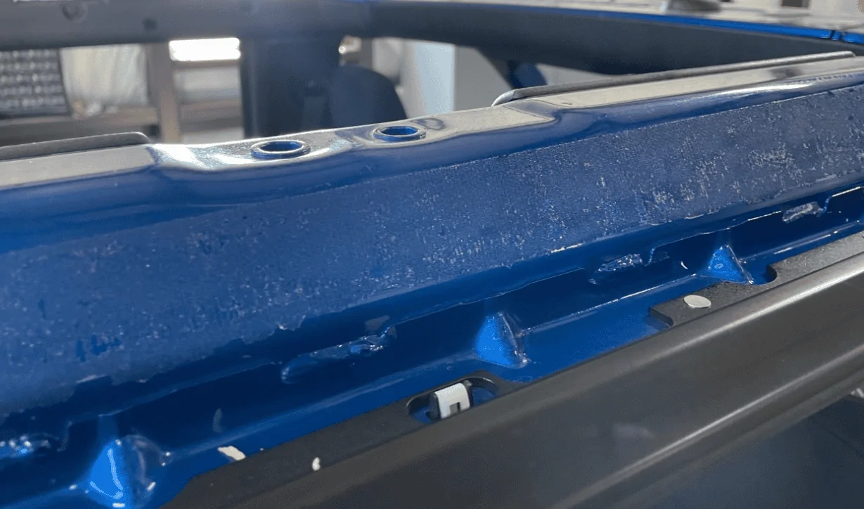

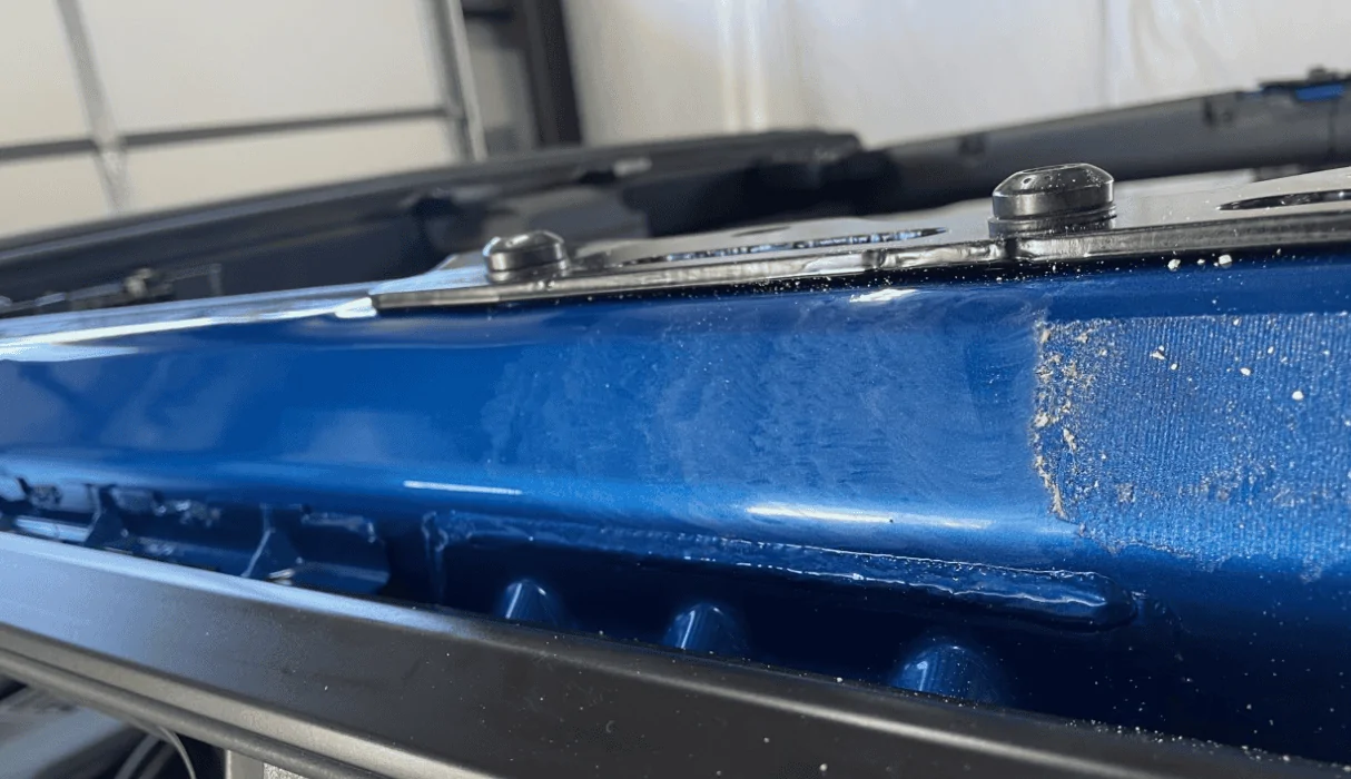

I just spent the last 3 hours cleaning the residue off my Bronco. I am pretty confident that the adhesion to the Bronco itself is great. It's the actual velcro side that failed on mine.
Goof off, alcohol, and the normal not harsh ways of removing would not even touch this. I had to break out the 3M eraser wheel to clean it completely. Going to lay down the new tonight and then leave it until spring when I put the mesh top back on.
