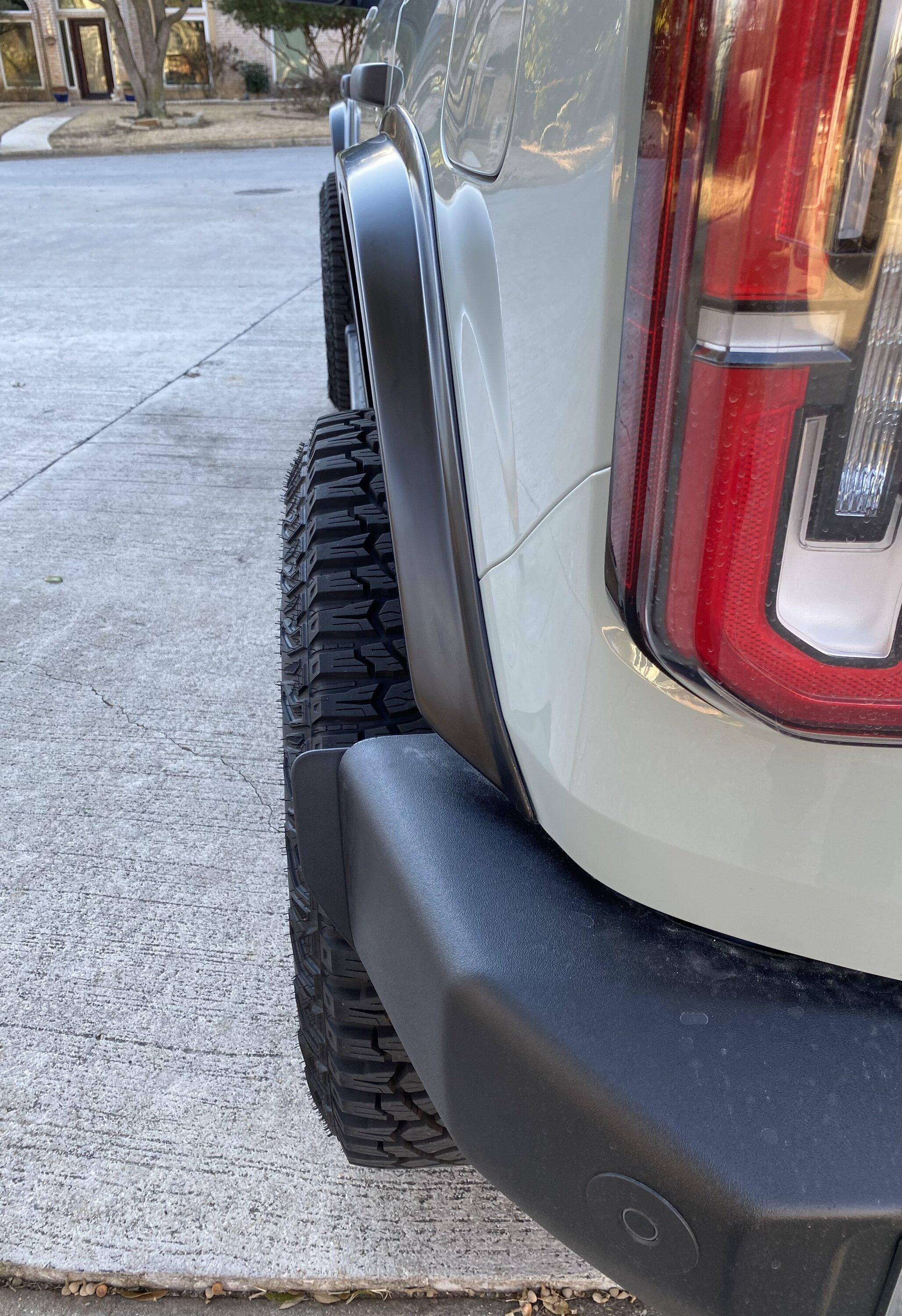

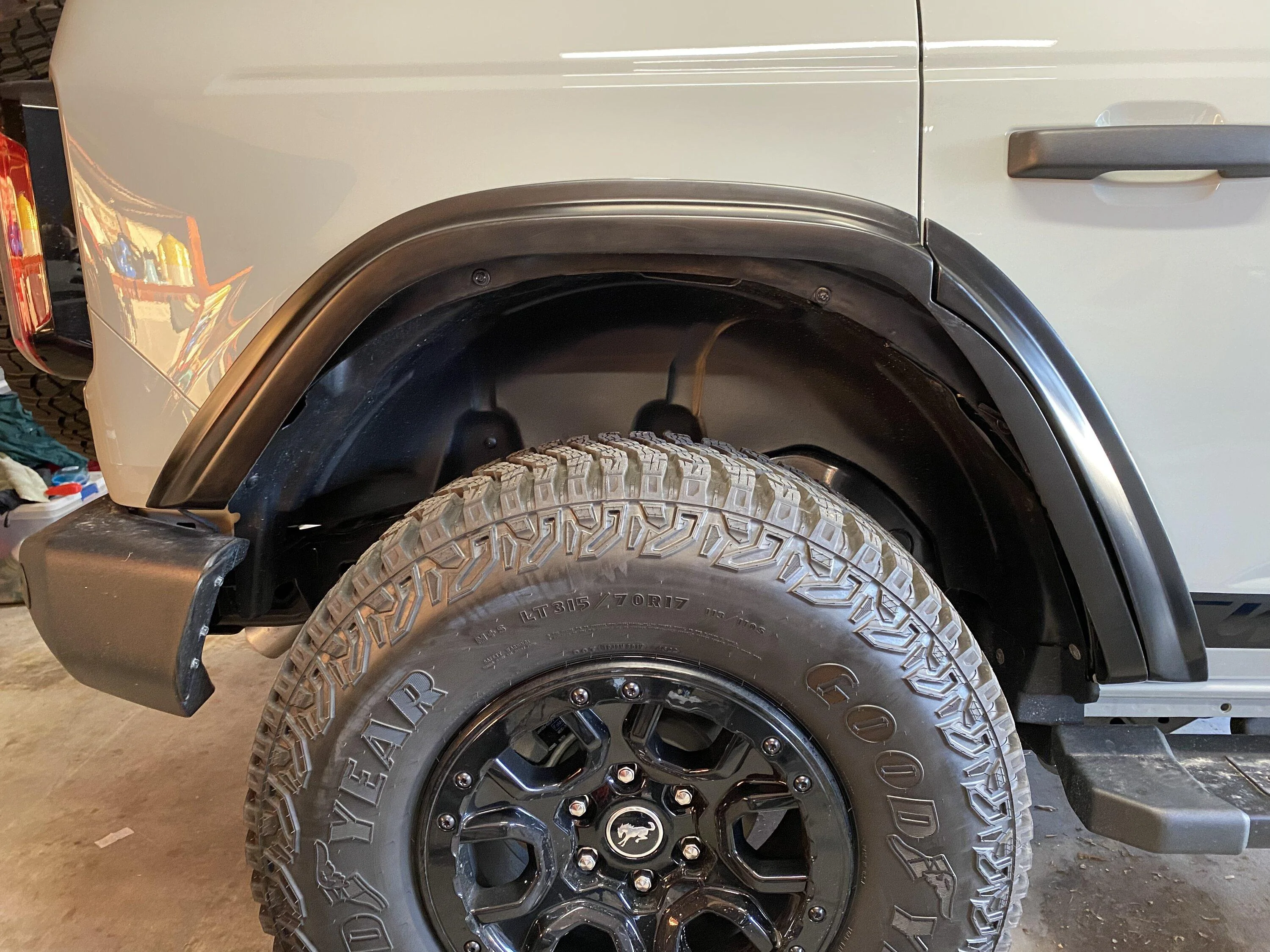

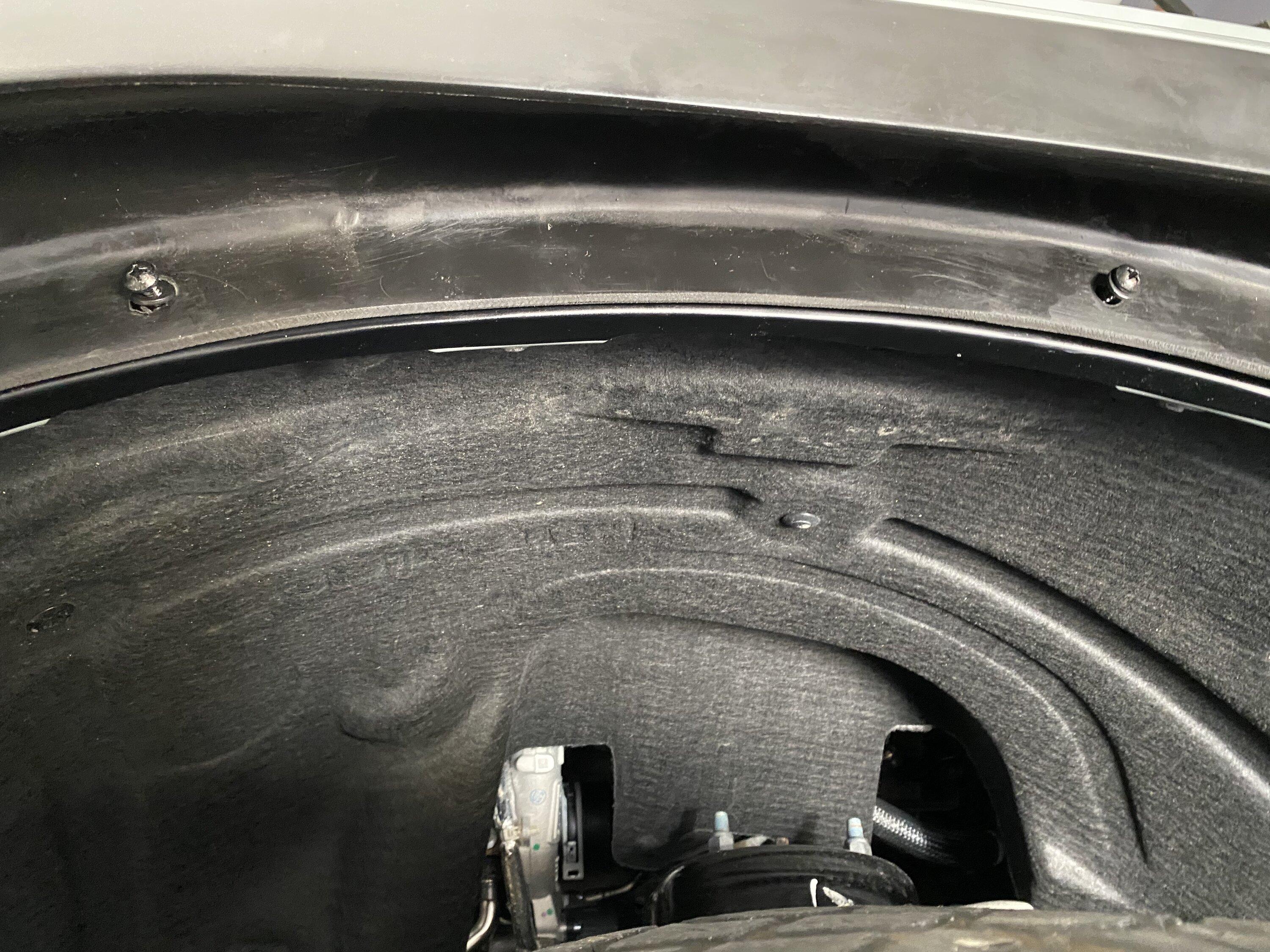

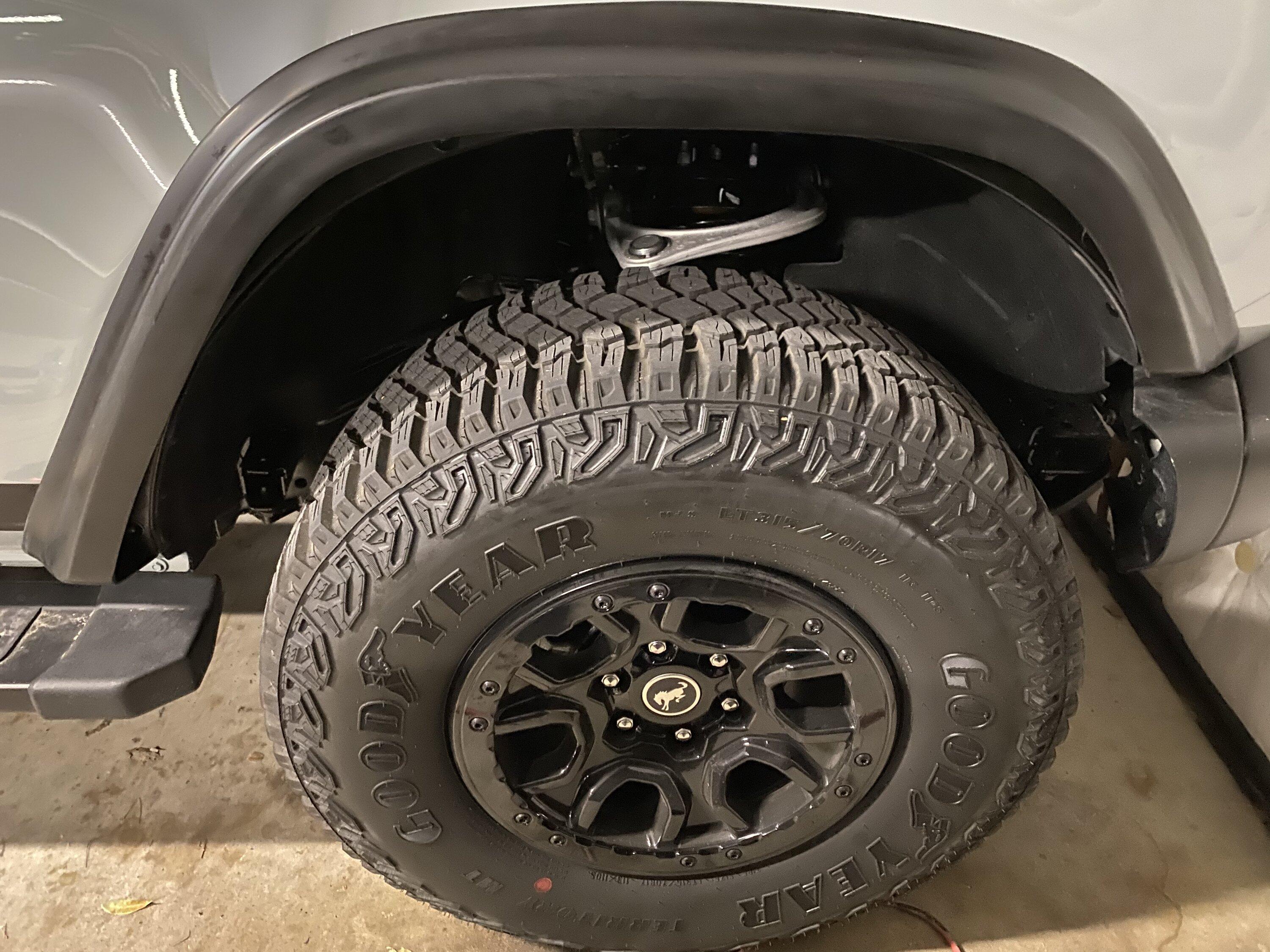

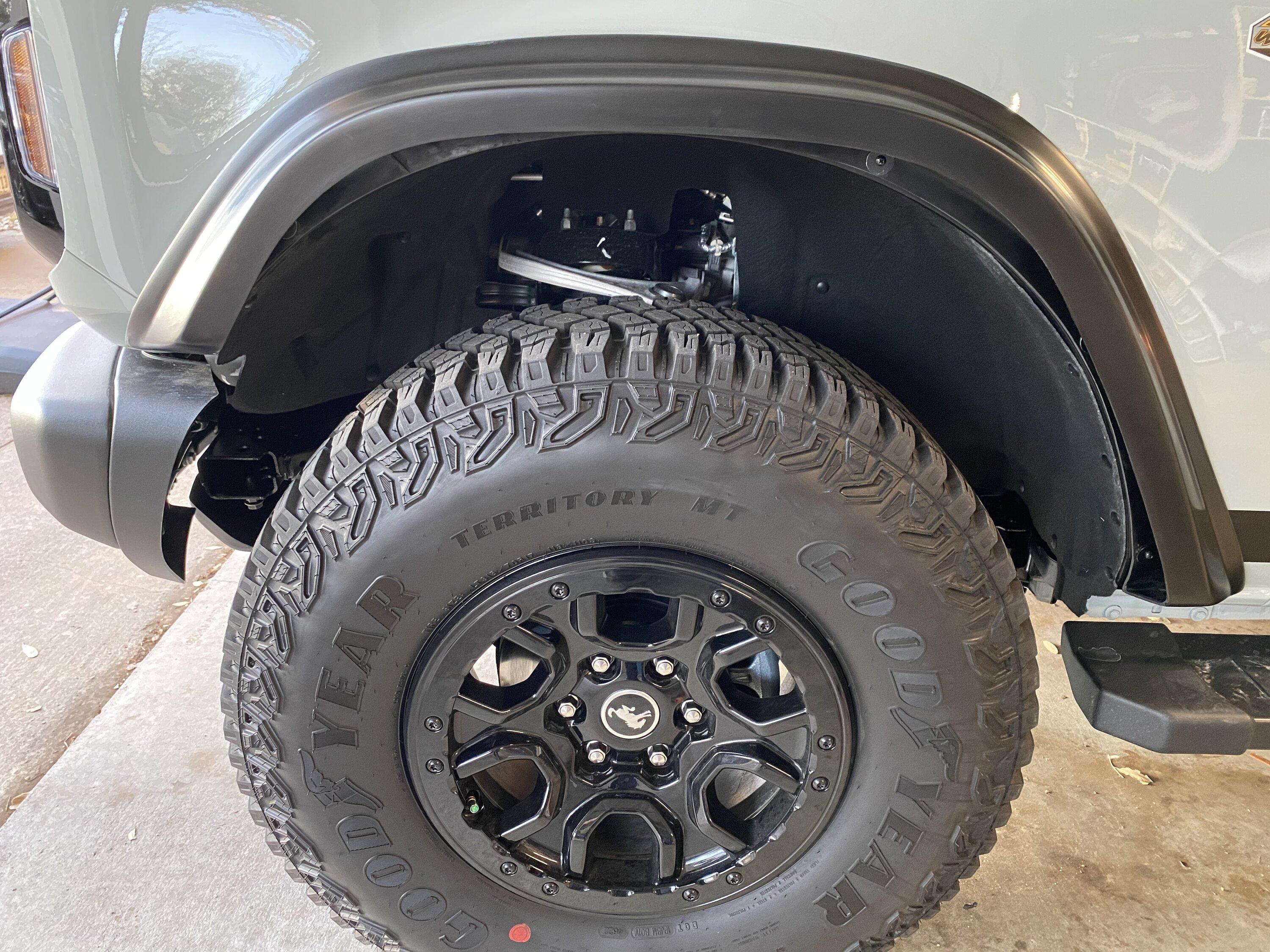

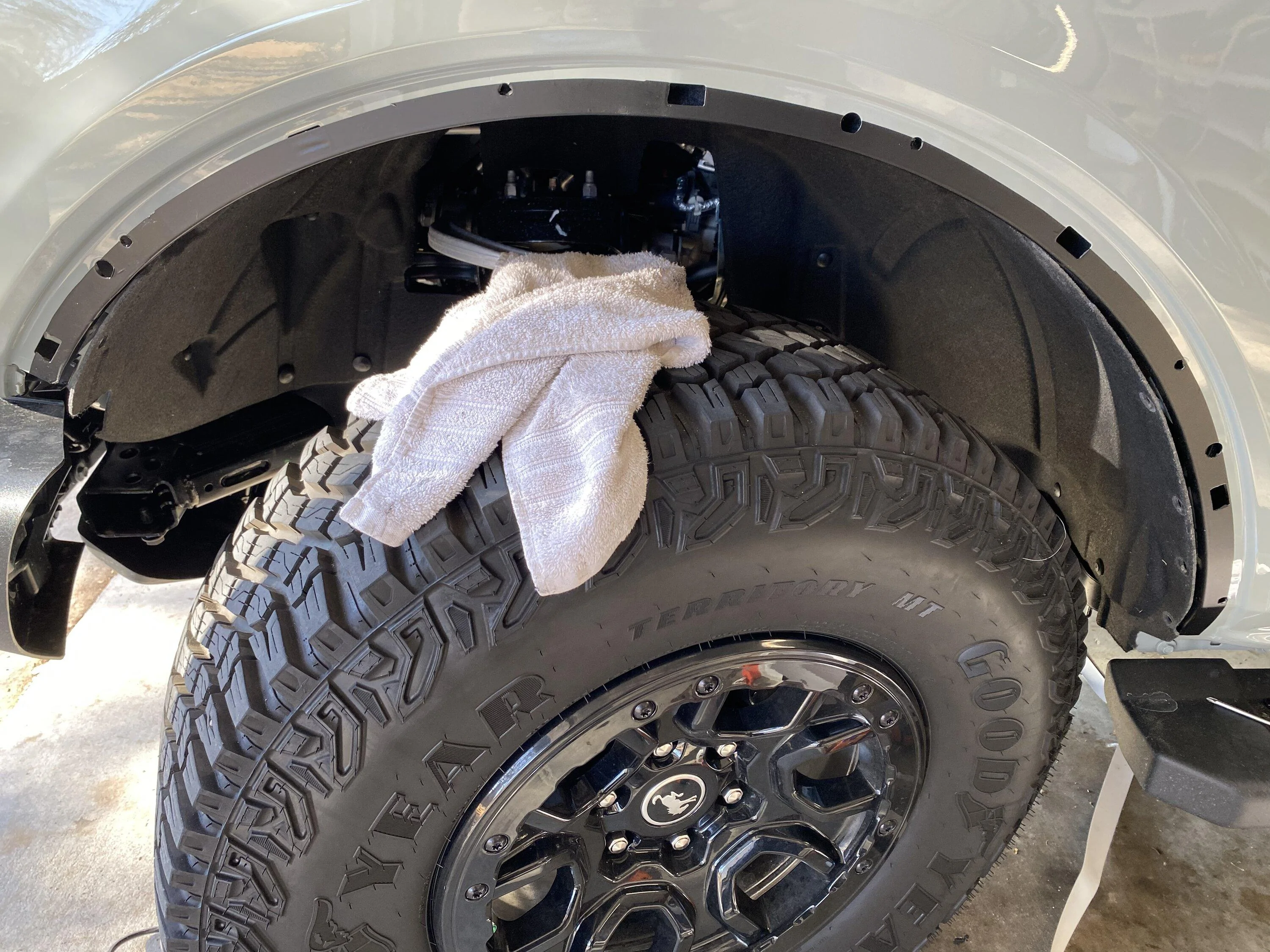

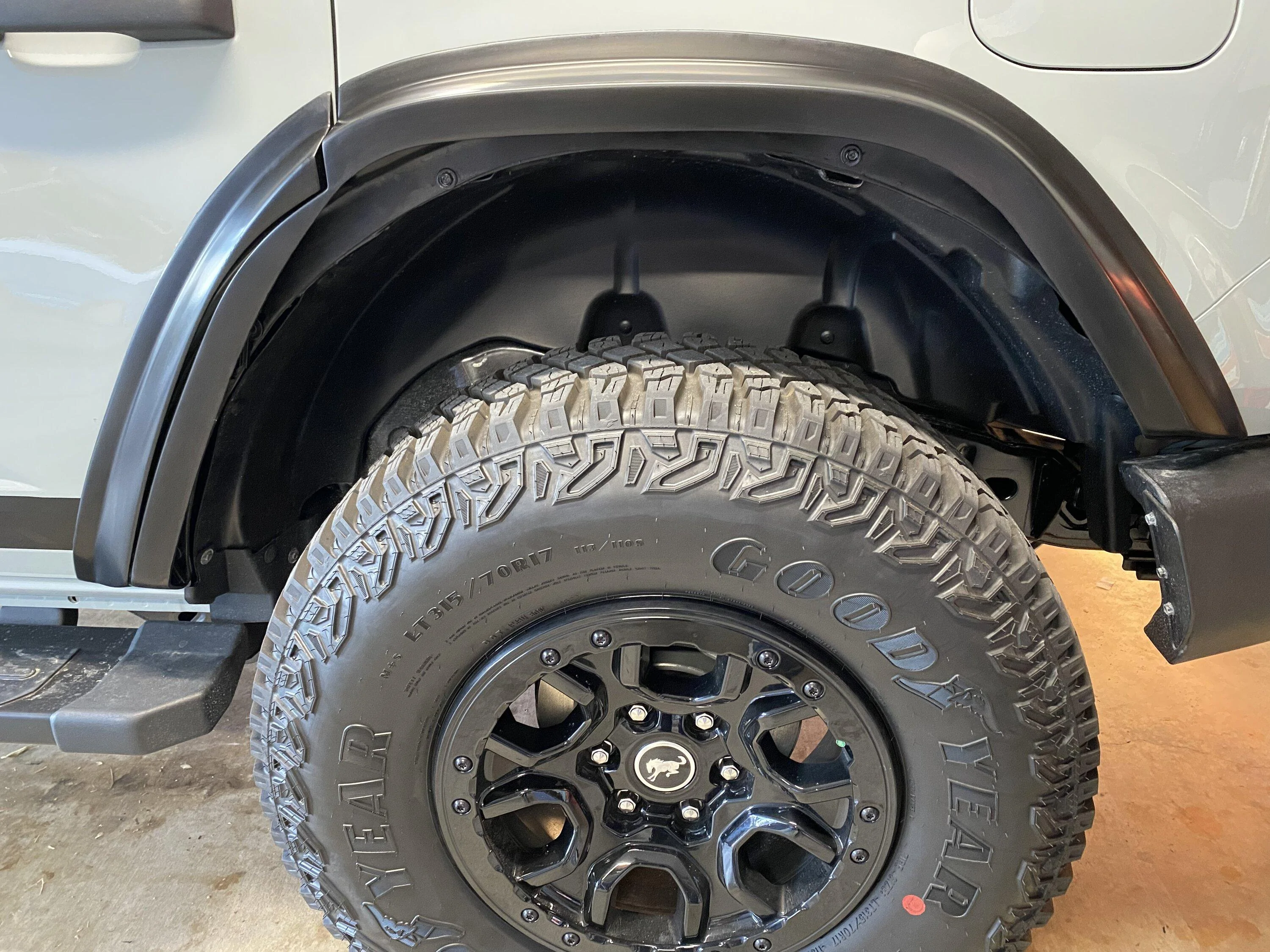

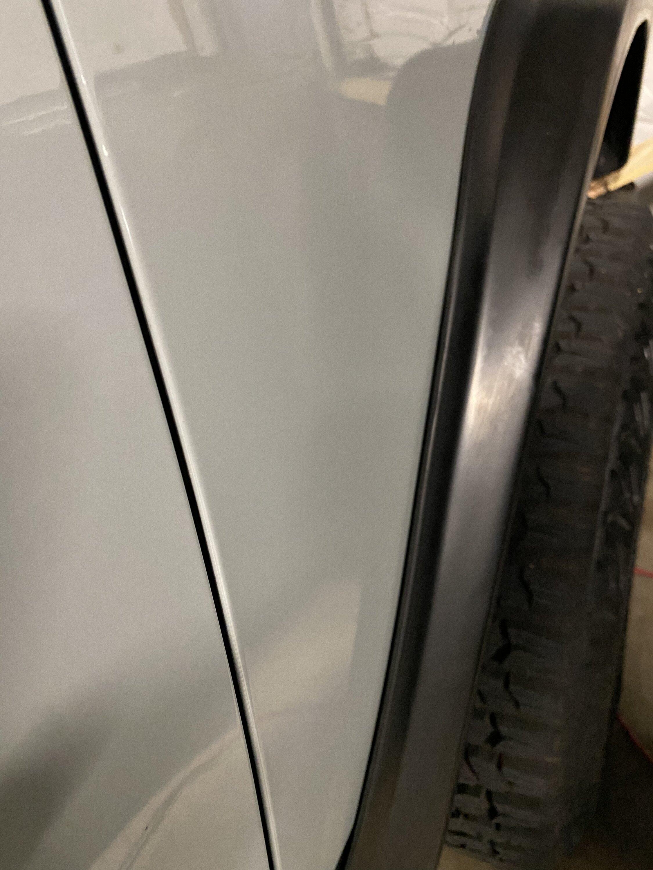

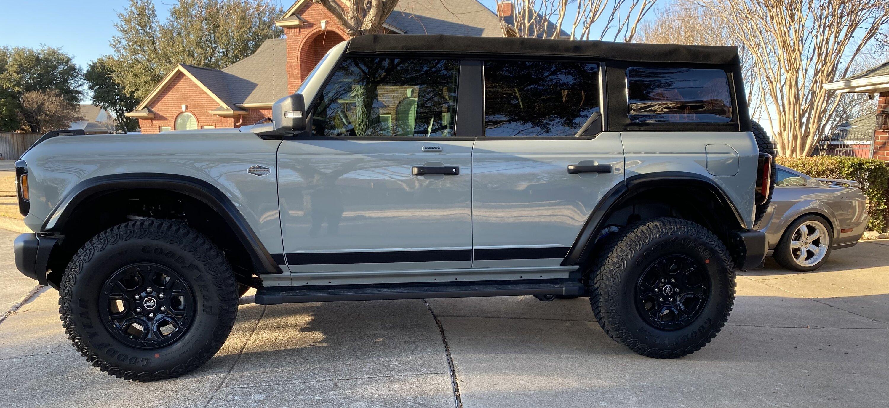

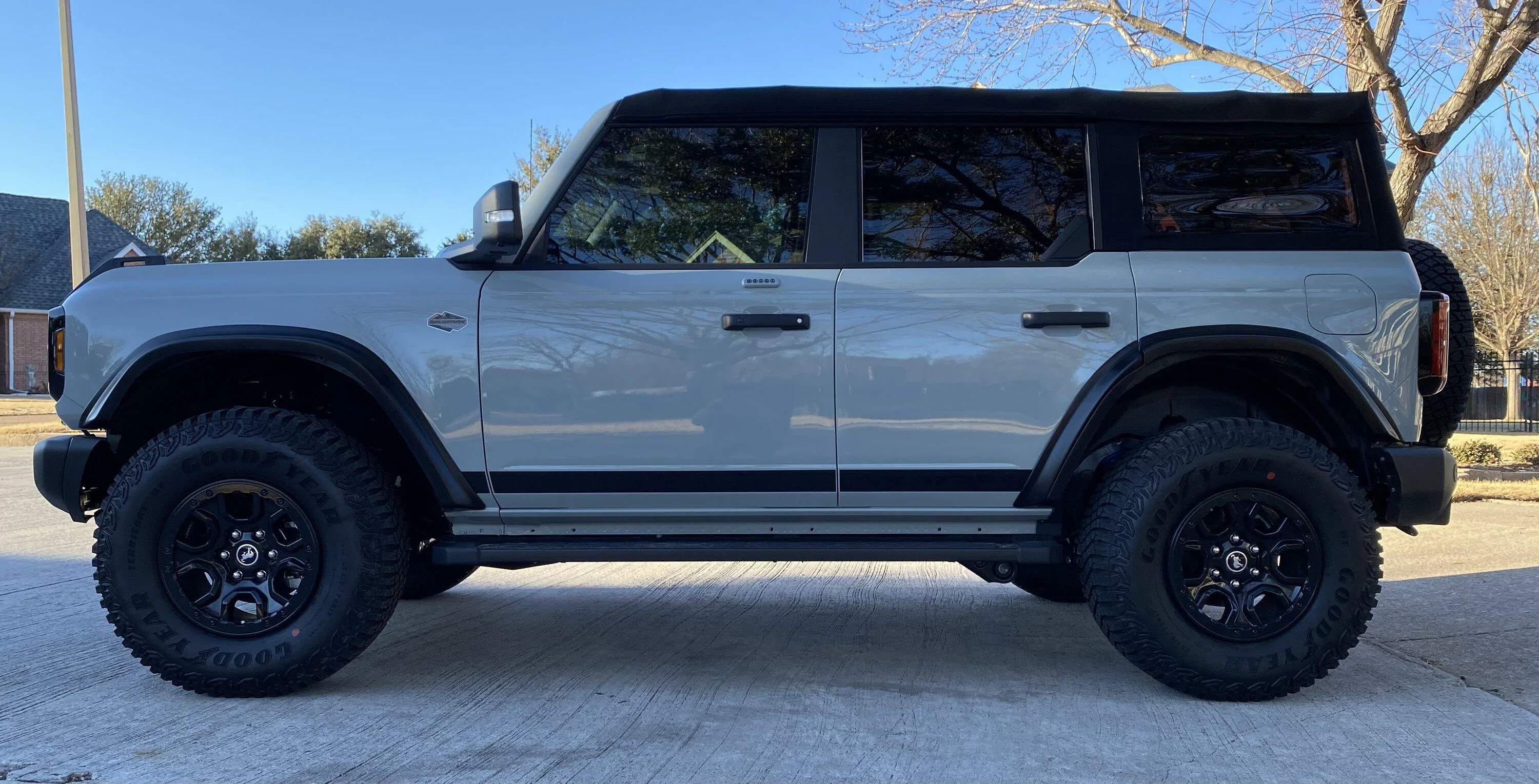

I couldn’t wait… lol Used vinyl trim blackout tape on the fender edge. I had to drill out the screw holes slightly in the front flares so they would sit level. They do seem to squat a little toward the rear, at least the front flares do. So I had to drill them out a little to give more adjustment and then used larger washers on the screws.
I added an extra strip of 3m on all the flares and used a heat gun to help with the bond and forming to the fender. Cleaned with Dawn/water, then alcohol…multiple times… Passengers side front fender, the tape just doesn’t want to stick on the backside and the fitment doesn’t seem as good as the driver’s side. I may see if they can send another…

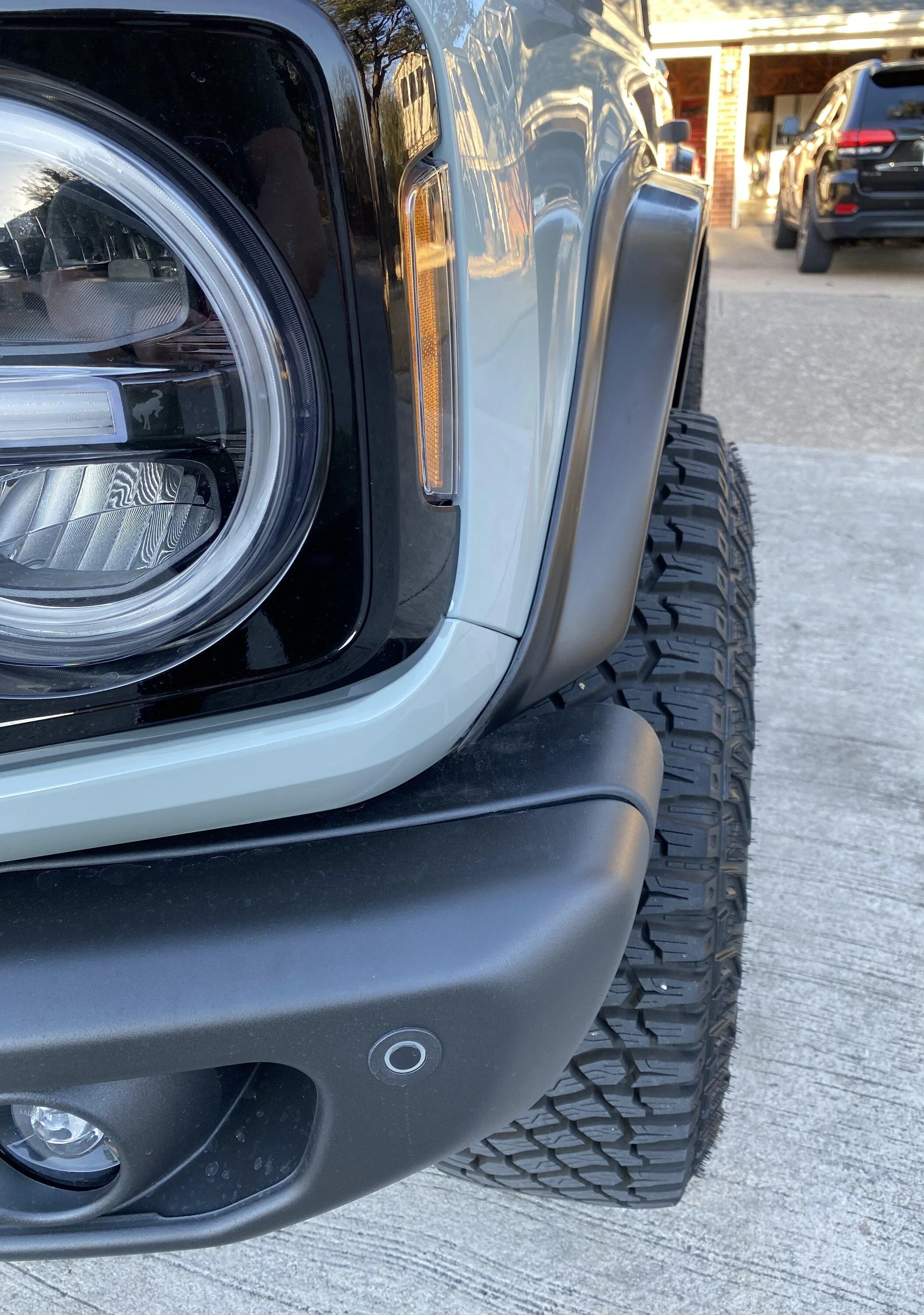

Closeup of the gap on backside of passenger front, not too bad… But my OCD is kicking in.

Try and make sure the fenders are thoroughly cleaned with the alcohol where the tape will adhere. 2 spots on my flares I will have to redo, no big deal. I am glad that I got them.

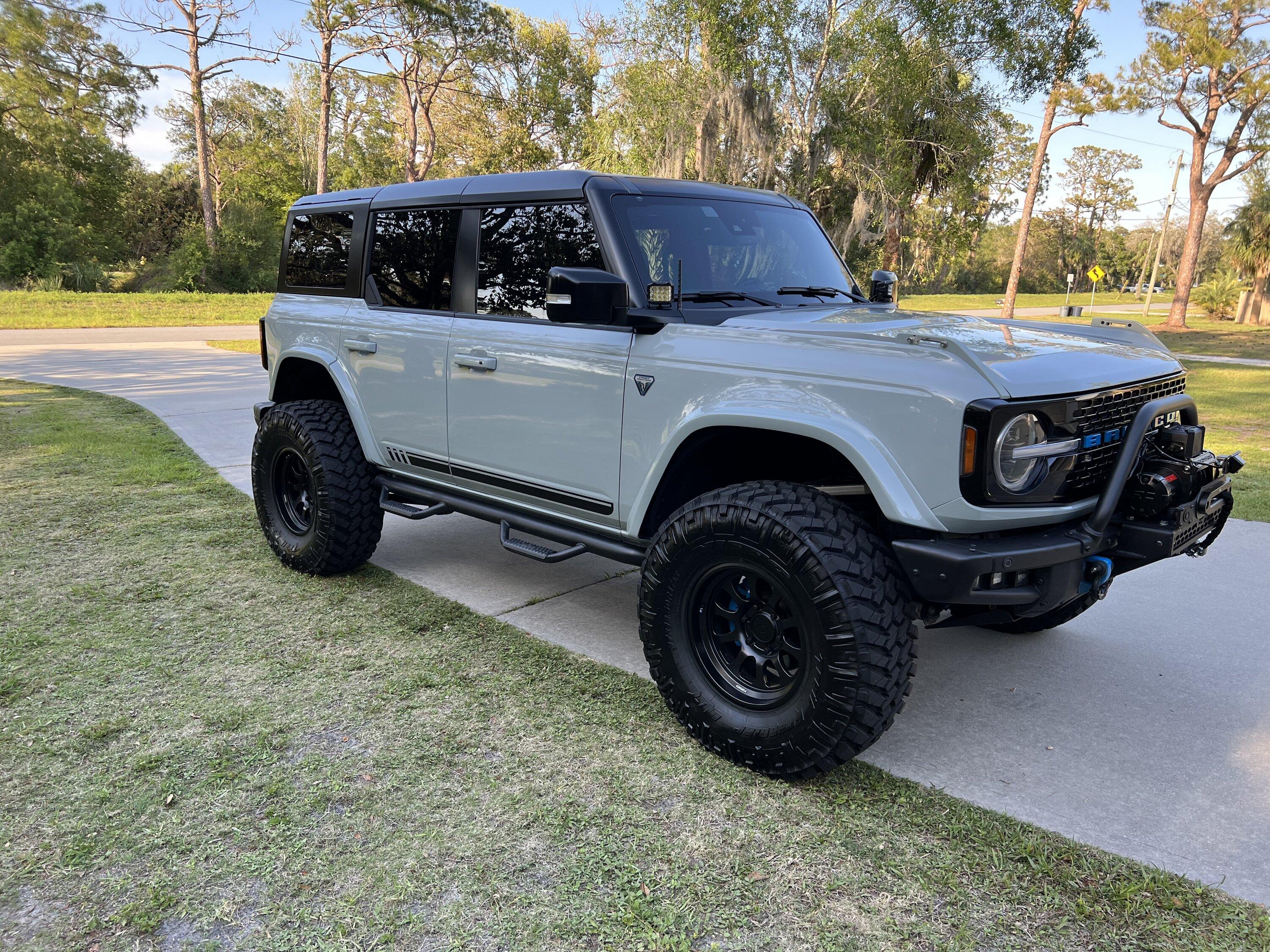

I’ve had my KBD flares at the paint shop since 4/20 and install was scheduled for 5/1. Got an email yesterday (4/28) that the painter was having a hard time getting all the oil out of them that was left on them when they were manufactured. He has painted them a few times now but is not happy about the end result. Tentatively rescheduled for 5/11 now. I had sent them the KBD instructions for paint prep prior to dropping them off. Wether they followed them or not who knows. Anybody else got these color matched and have issues?

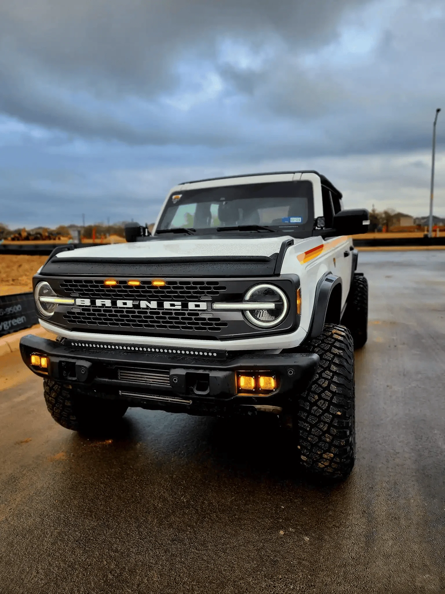

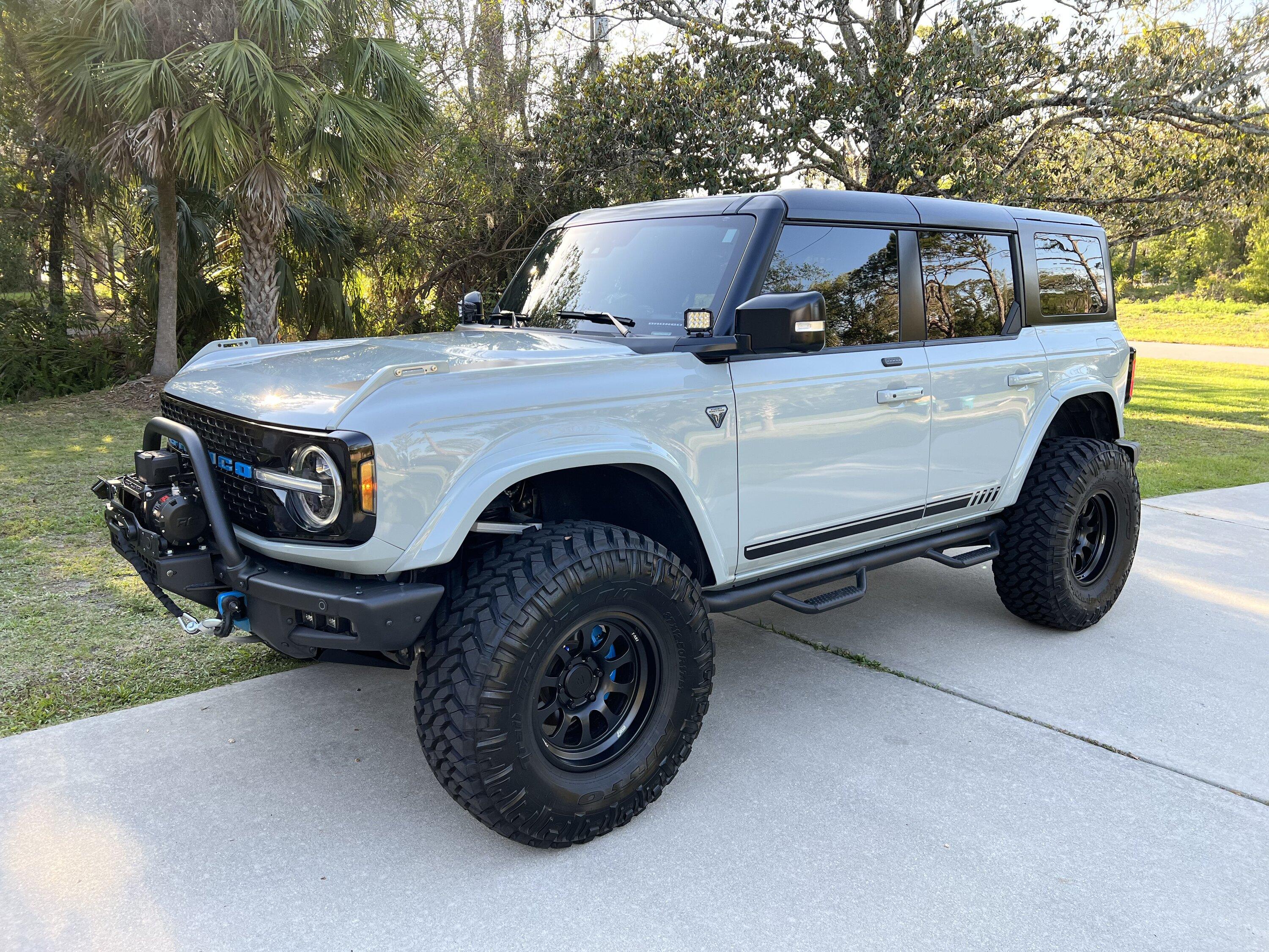

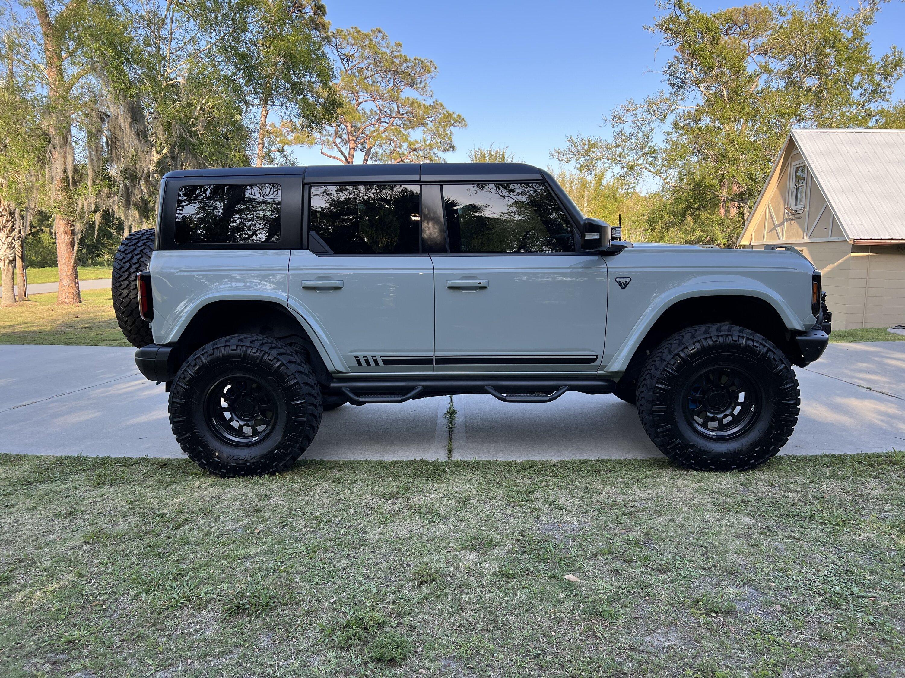

Mine finally arrived back today

They look amazing painted, even better than I thought. Looks like Anderson or ADV fenders from the side.
How many hours did they take and/or what did they end up charging you?
