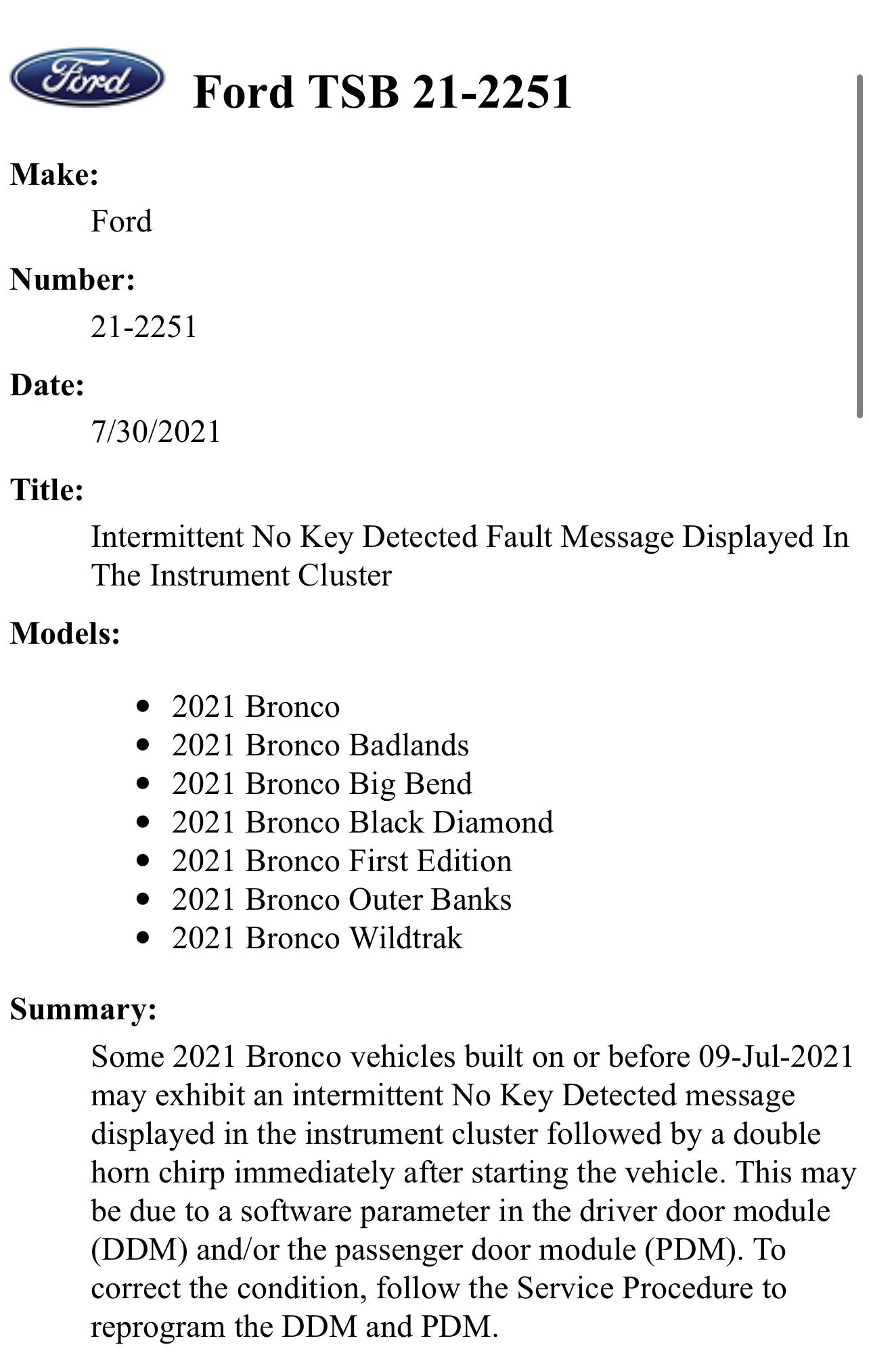

So I took delivery of my 2022 last week and a day later this issue popped up. Found the work around here on the forum, bypassed it by putting the key in the spot in the center console to get it to start. Just dropped it off this morning with the dealership to reprogram it per the TSB but the tech couldn’t find it. I gave him the number and he said that was for the 2021 only but would go ahead and reprogram them anyway. Does anyone know if there is a new TSB for the 2022?

My Rep just called me and said that the techs are on the phone with Ford to see how they go about fixing it. They’re saying the fix for the 2021 doesn’t work for the 2022, which sounds really odd to me but ok. Will keep y’all posted.

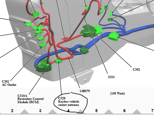

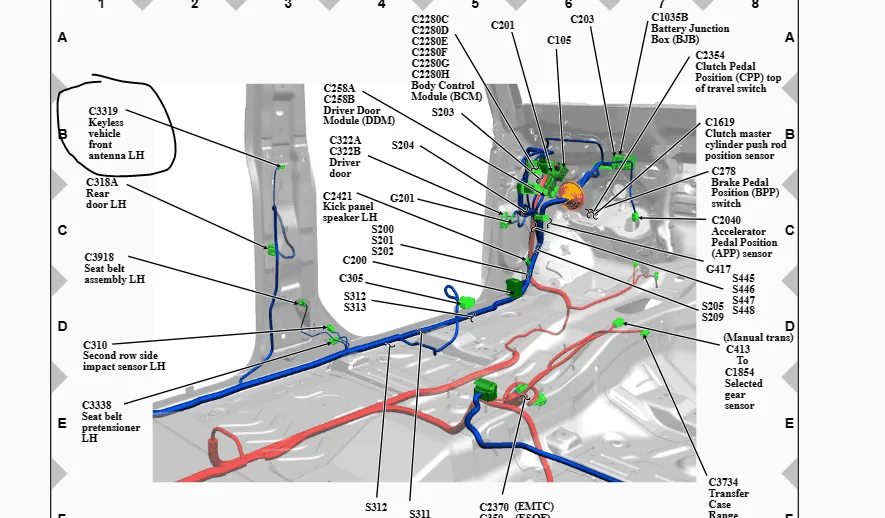

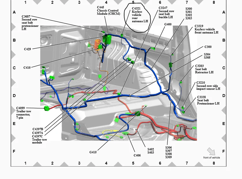

These concerns are kinda hard to diagnose but the first thing to check is the fob battery to make sure it's above 3.0V. Not close to 3.0, has to be that or above to work correctly. Second thing is if it can be duplicated with the second fob. If so and the batteries are good, it could be transmitters, outside RF interference (does it happen in a specific location like school, grocery store, gas station, mall), intermittent software malfunction, wiring or antennas. I had this happen several times on my '21 but never bothered trying to chase it down.
Center console.
Ford Bronco Key Not Recognized 1689683036973
Front. Has matching one on passenger B pillar.
Ford Bronco Key Not Recognized 1689683089154
Rear. Has matching one on the passenger side.
