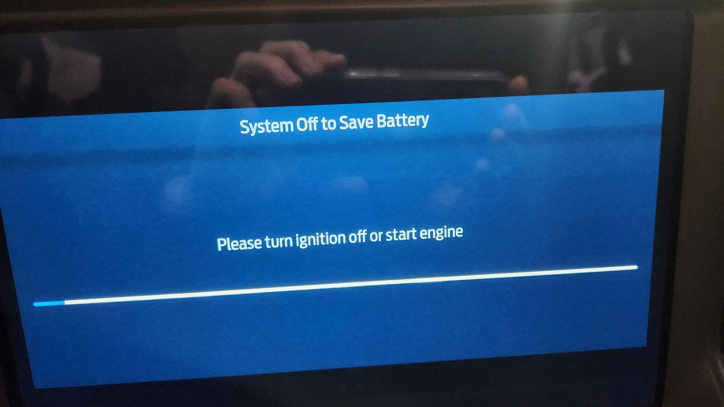

OK, I think I've narrowed down the problem. I believe that the battery level is too low, causing the truck to cut back on functionality when the engine is off. The display, the dash, and the overhead cabin lights don't come on when I open the door, the passenger door and tailgate don't unlock/lock on touch (driver door does, so a selective decision on the part of the system, I'm guessing), and the screen shows the below message when I turn off the engine and open the door.
The gauge on the dash showed 12.5V with the engine off, but was down to 12.2V a little bit later when I checked. The truck starts just fine, however. Anyone know the minimum battery voltage required to make everything work with the engine off?

I am going through the exact same thing as you are, I think the battery is bad.

Maybe a bad batch of batteries, or possibly the features that are active when the truck is not running (keyless entry, etc.) wear the battery down prematurely. I also have a BlackVue dashcam system, but it's set to turn off in parking mode when the battery reaches 12.2V. That shouldn't stress a battery.
When these features were not working I measured voltage directly on the battery and got 11.6V, then turned on the accessories (but not the engine) and the battery voltage on the dash said 12.2V. Not sure how accurate the dash voltage reading is.
Anyway, I have an appointment to take it to the dealer on Monday to have the battery tested as a first step.

It was the battery. Took it to the dealer today and they tested it and replaced it under warranty.

Even though this thread is pretty much dead i just had this issue after my truck sat at ford for 2 months. Driver door handle would unlock and lock with passive key system, passenger and swing gate would not, as well as that same sync message of turning off to save battery. Several other things were happening, aux switches working when car off etc.......i pulled the neg batt terminal and trickle charged my batt overnight and low and behold when i reconnected it EVERYTHING WENT BACK TO WORKING AS SHOULD :ROFLMAO::ROFLMAO::ROFLMAO:
ill come back and update if the gremlins come back
