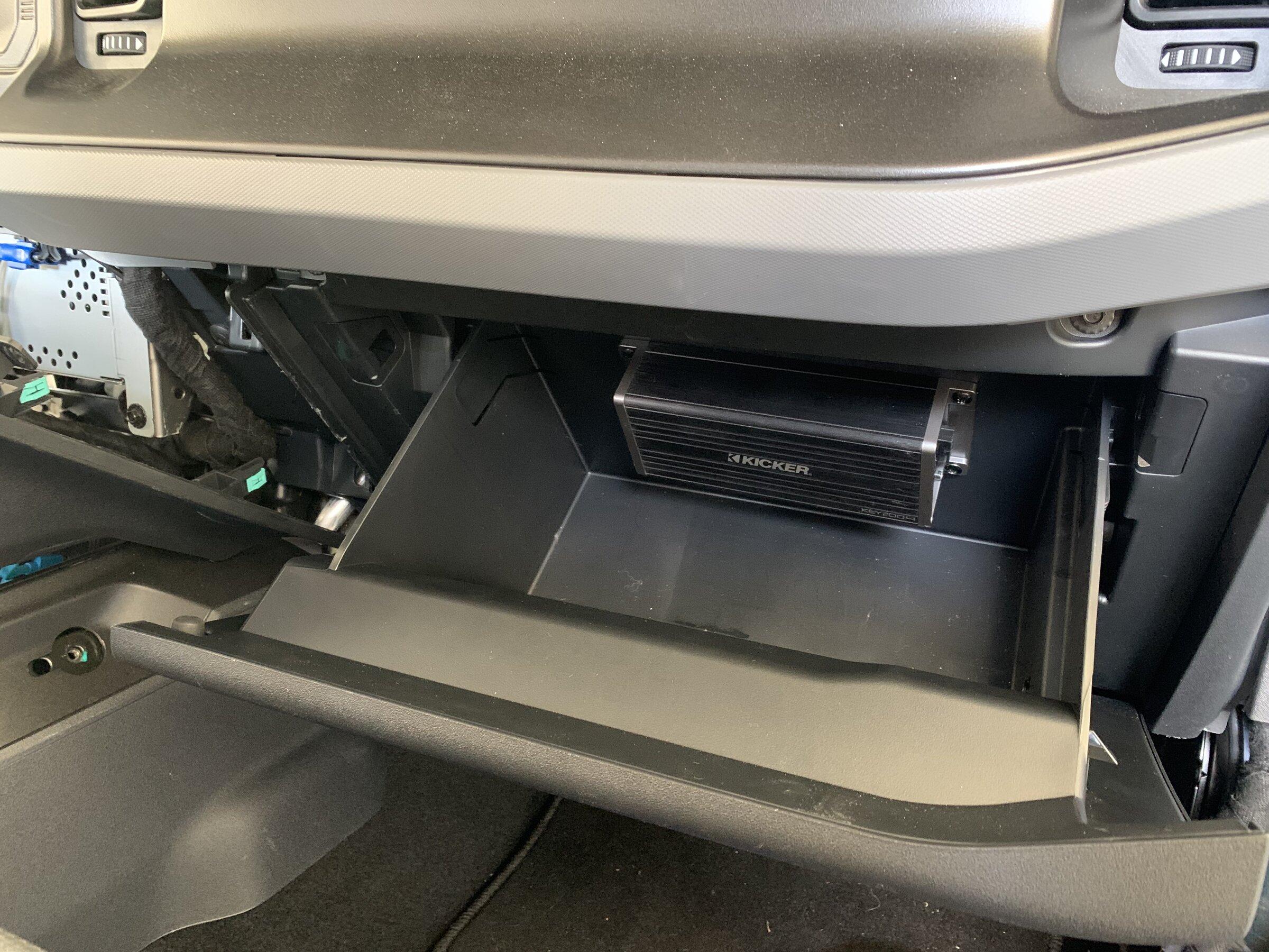

I am basically new to car audio and using this thread and the original videos plus a few key posts and I got it done solo in about 5 hours. I mounted the amp above the glove box vs under the steering wheel as I wanted to run the power for the sub down the driver side and also maximize how much RCA cable I had/ not have it next to the power.
Special thanks to @Thicky_Vicky for her post on page 20 as I was really struggling to find a good spot for the sub amp. I know the spot under the carpet in the back isn’t for everyone, but I won’t be getting rained on and it’s a cubby that would never have been used. For the record it sits in really nicely and does not rattle. I’ll clean up the cabling in the pic below at some point, but I didn’t want to trim it and lose options in the future. I’m not 100% committed to the amp location and will consider going where the factory one is in the future should I see a post that isn’t as involved as @cmcbronco (though I’m jealous of his skills).

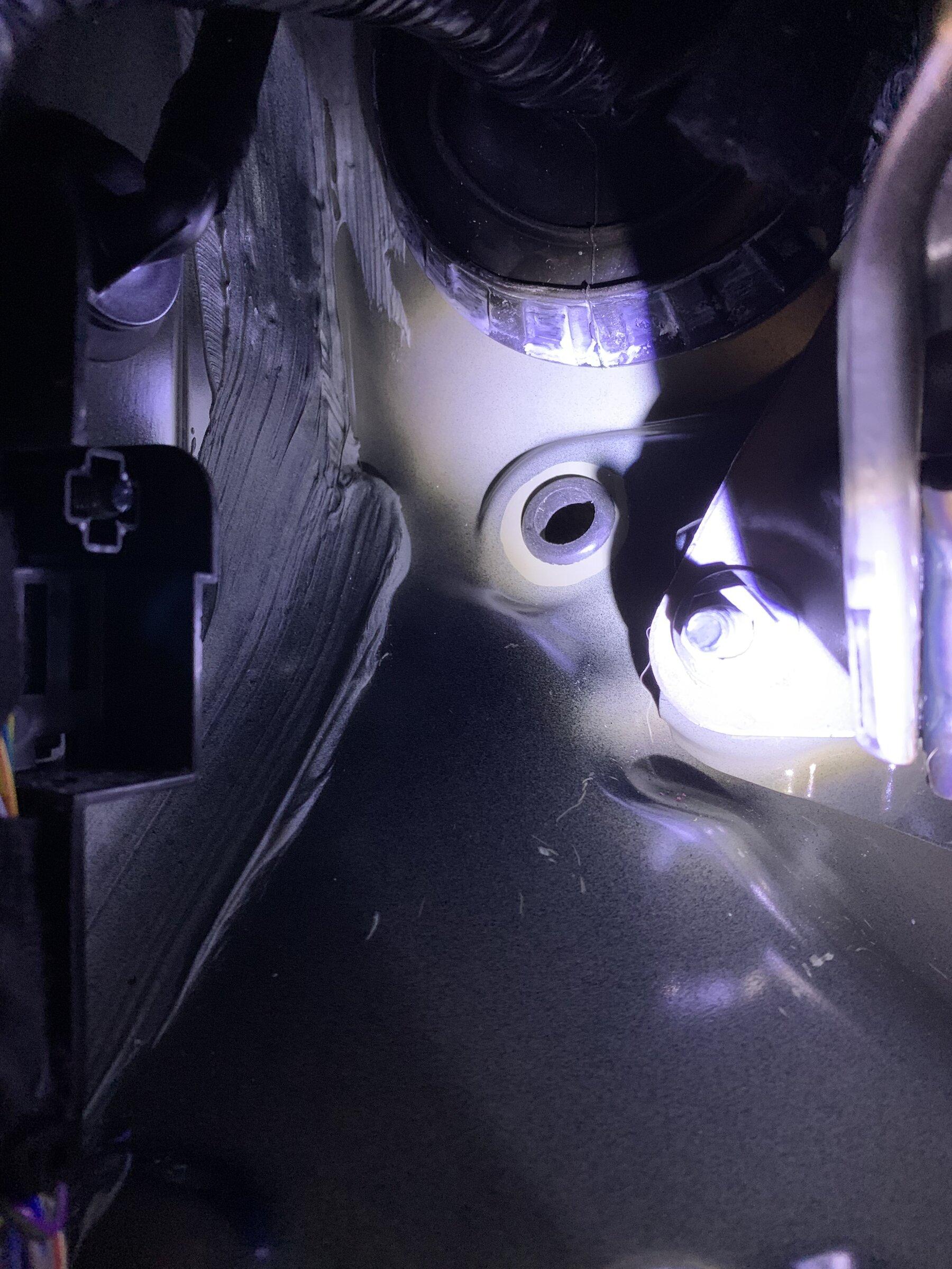

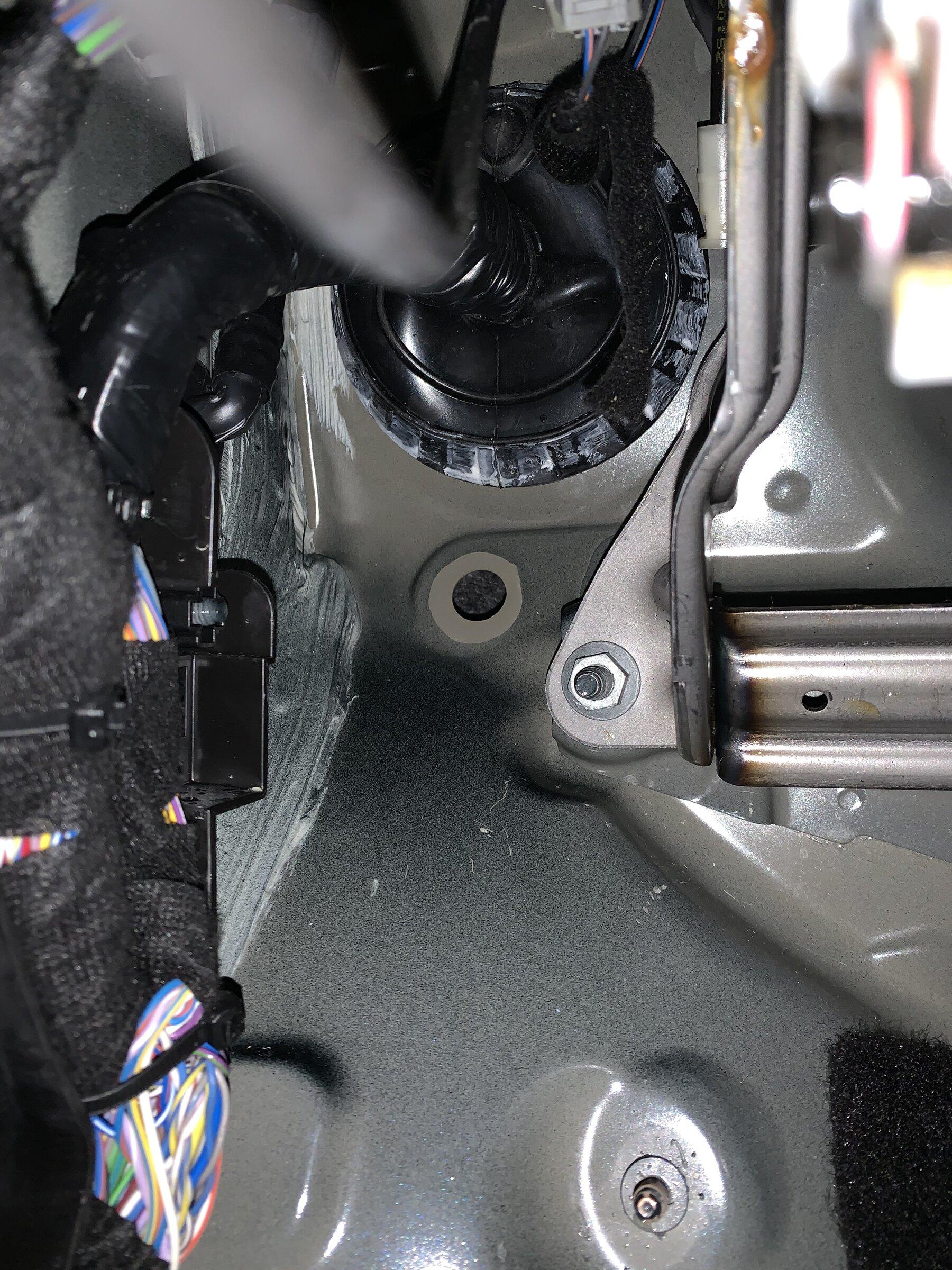

The video below was also very helpful, particularly because @evilletruck shows how to get the control panel off where the head unit wiring is without it being scary as hell. He shows the spot to punch through the firewall. He also explores behind all the paneling in the rear which was useful in ruling out places and giving me future ideas. I’d recommend this in addition to the original post.

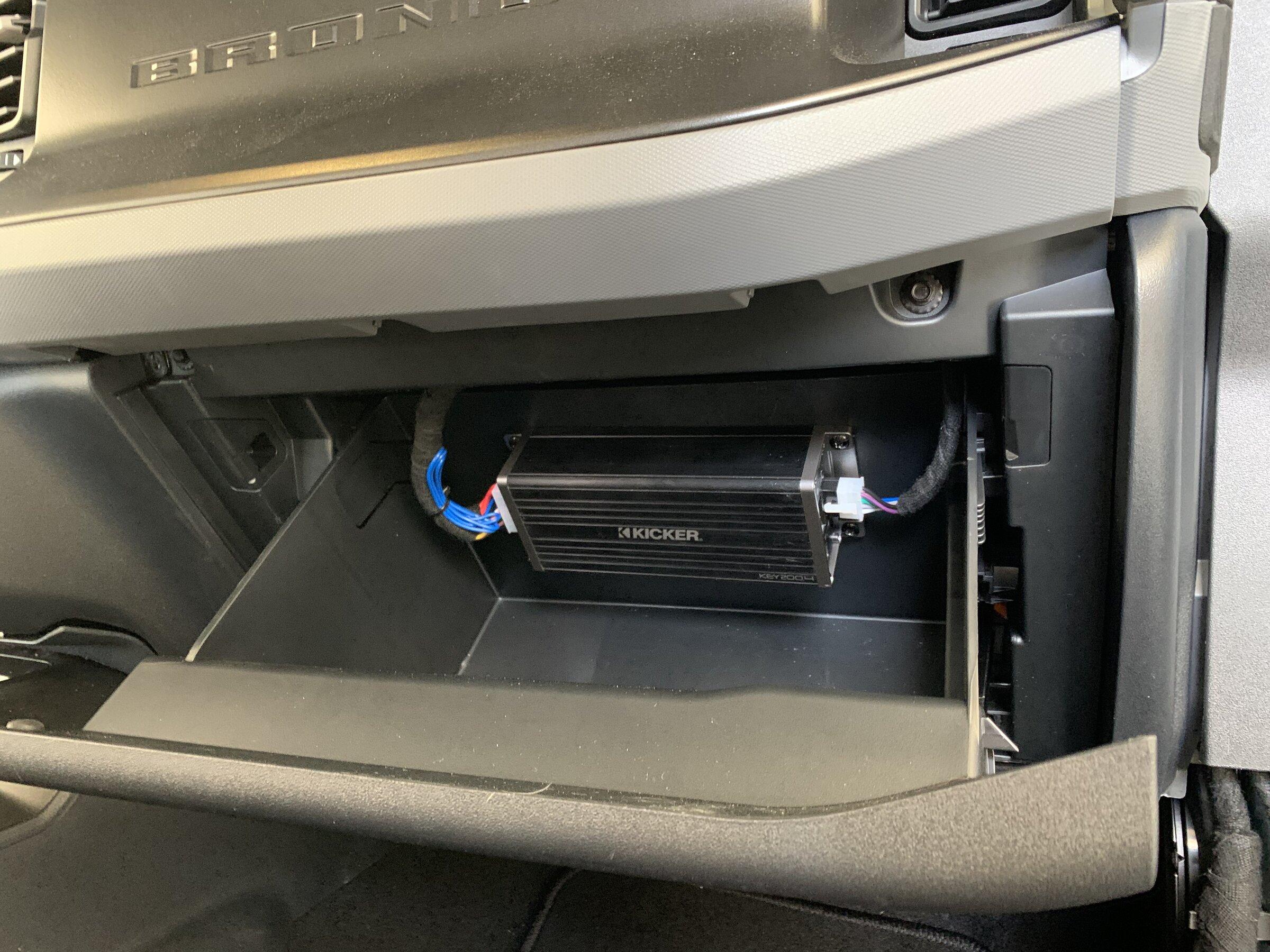

I installed a Kicker Key 200.4 amp in my BaseSquatch today and it made a HUGE difference. It was a straight forward install that took about an hour and a half. The install was made easy because of the harness from plugnplaykits.com. There was no need to cut, splice or drill anything. As you will see in the video below, it litterally was a plug and play operation.
The Kicker Key amp has a build-in automatic DSP that fixes Ford's terrible signal as well as adding 50 watts per channel. The combination is amazing. I have a nice 3 way component speaker set waiting to install in the front and now I'm not even sure I will bother. That is just how big of improvement this is.
