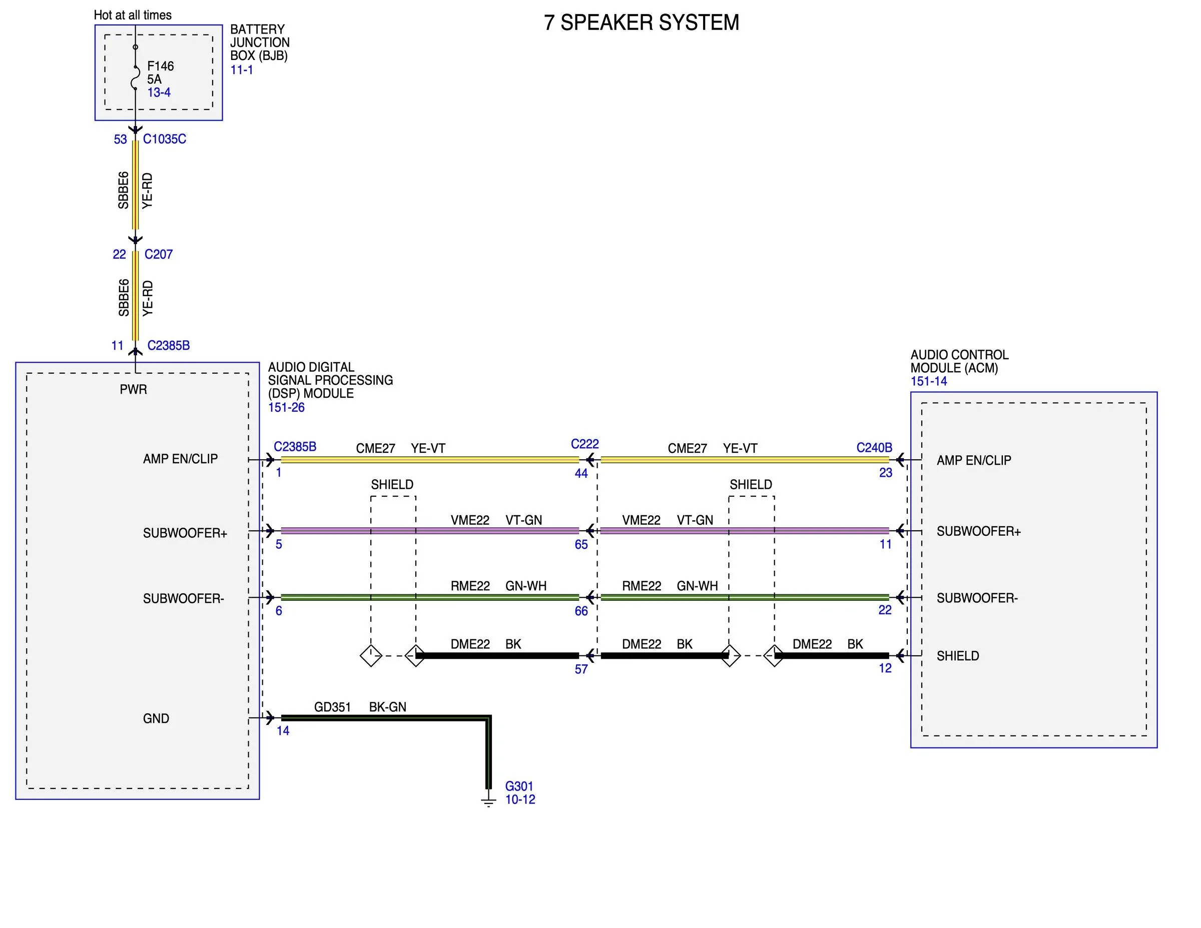

Just checked and the sub has high level inputs so kit 6 should work. I think.
Give the tech number on the website a call, talk to Joe and describe your set up (amps, lci,etc) and he will guide you to the right kit.

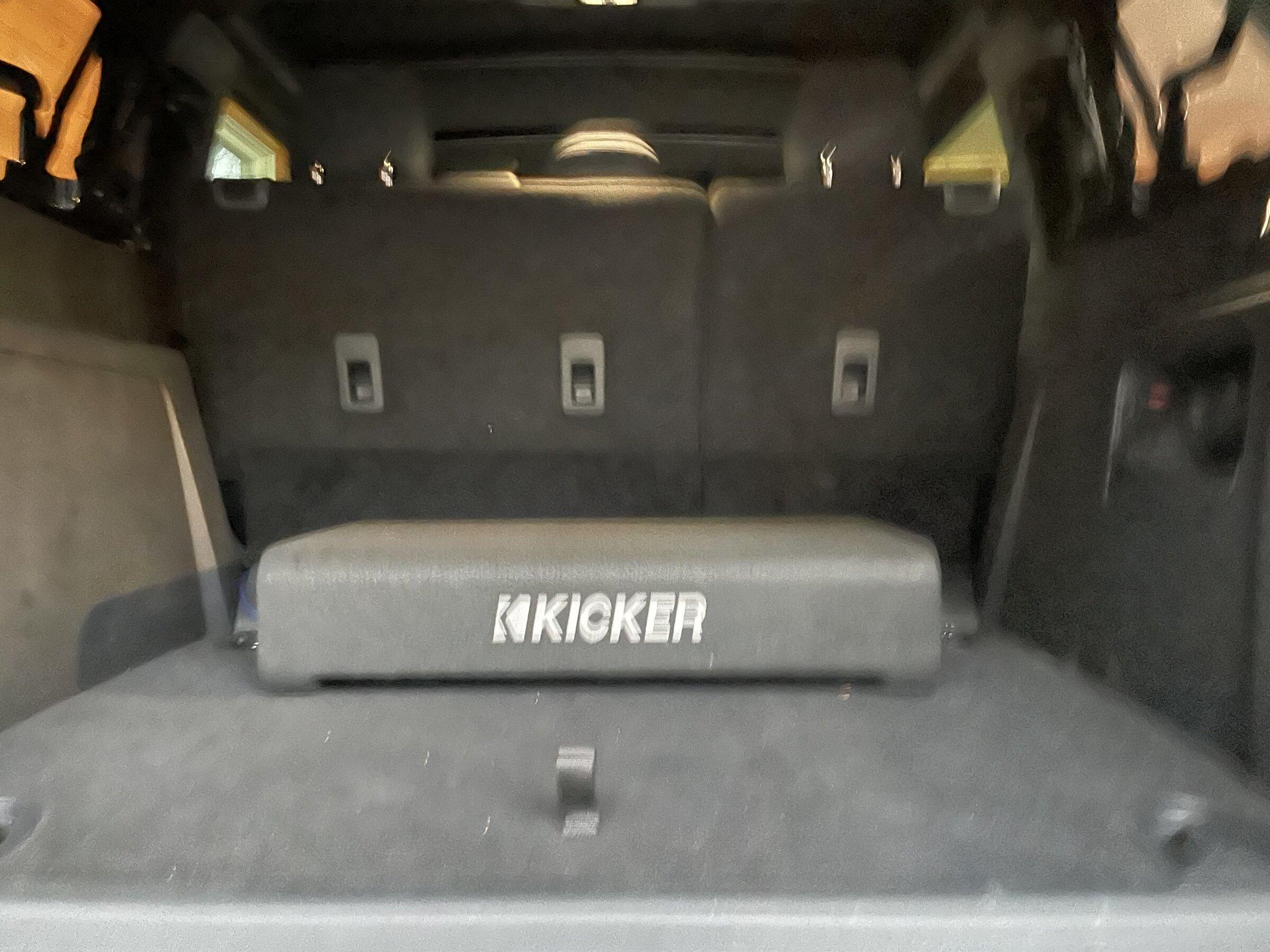

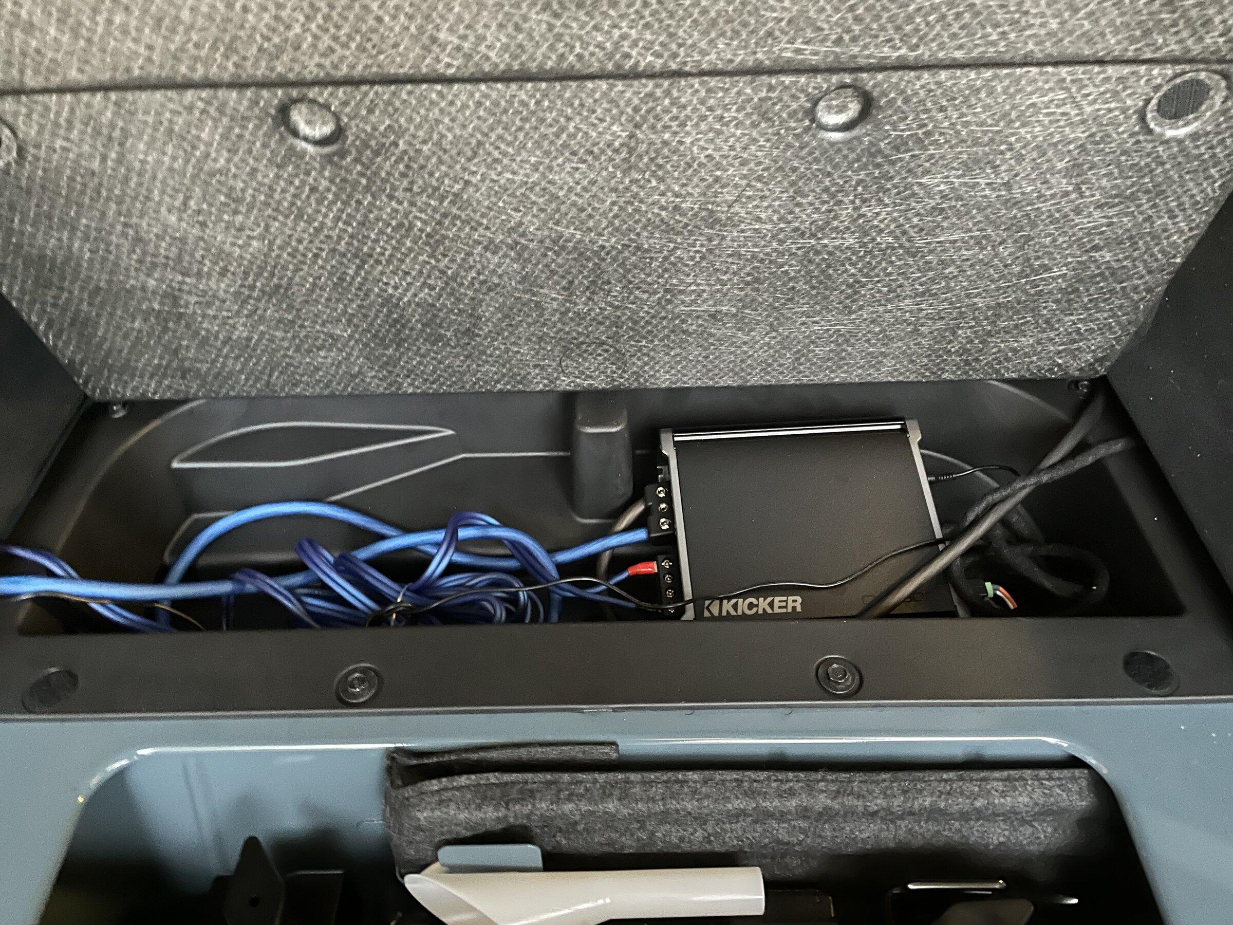

Hi everyone! Its my first post here as i await for my Bronco to finish its matte ppf which i recieve on Sunday im looking to upgrade the sound system first thing!
I got 2 Kicker csc4s and 1 csc65. Kicker 200 amp including harness from plug and play along with a hideaway 10in sub. Am i all set with this setup ?
Thanks in advance!

Should be. Consider boom mats for the 4” dash speakers, dynamat behind the 6” and rear speakers and if you prefer bass blockers for the dash speakers. I’ve read though the DSP on the amp may adjust for that.
