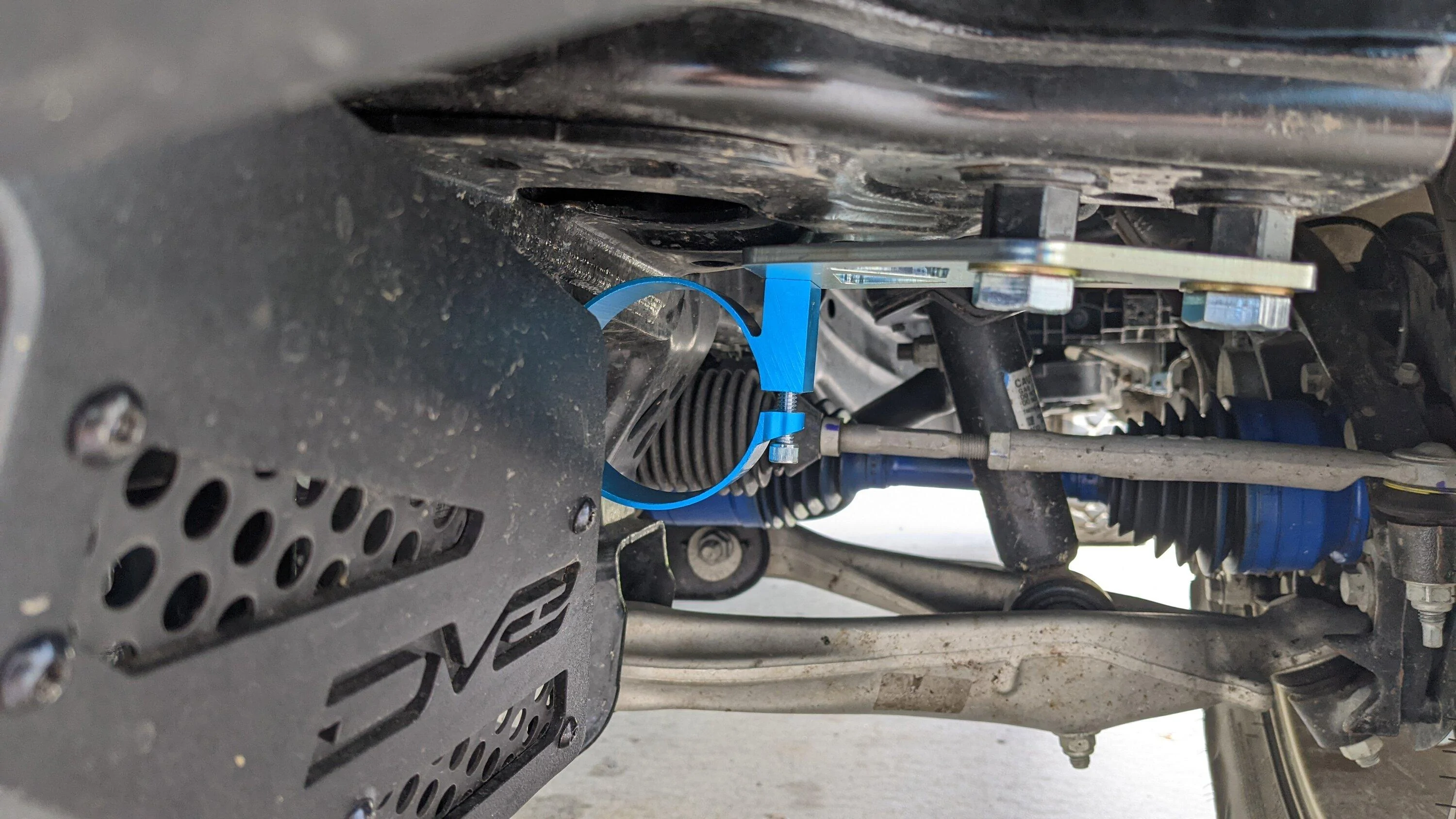

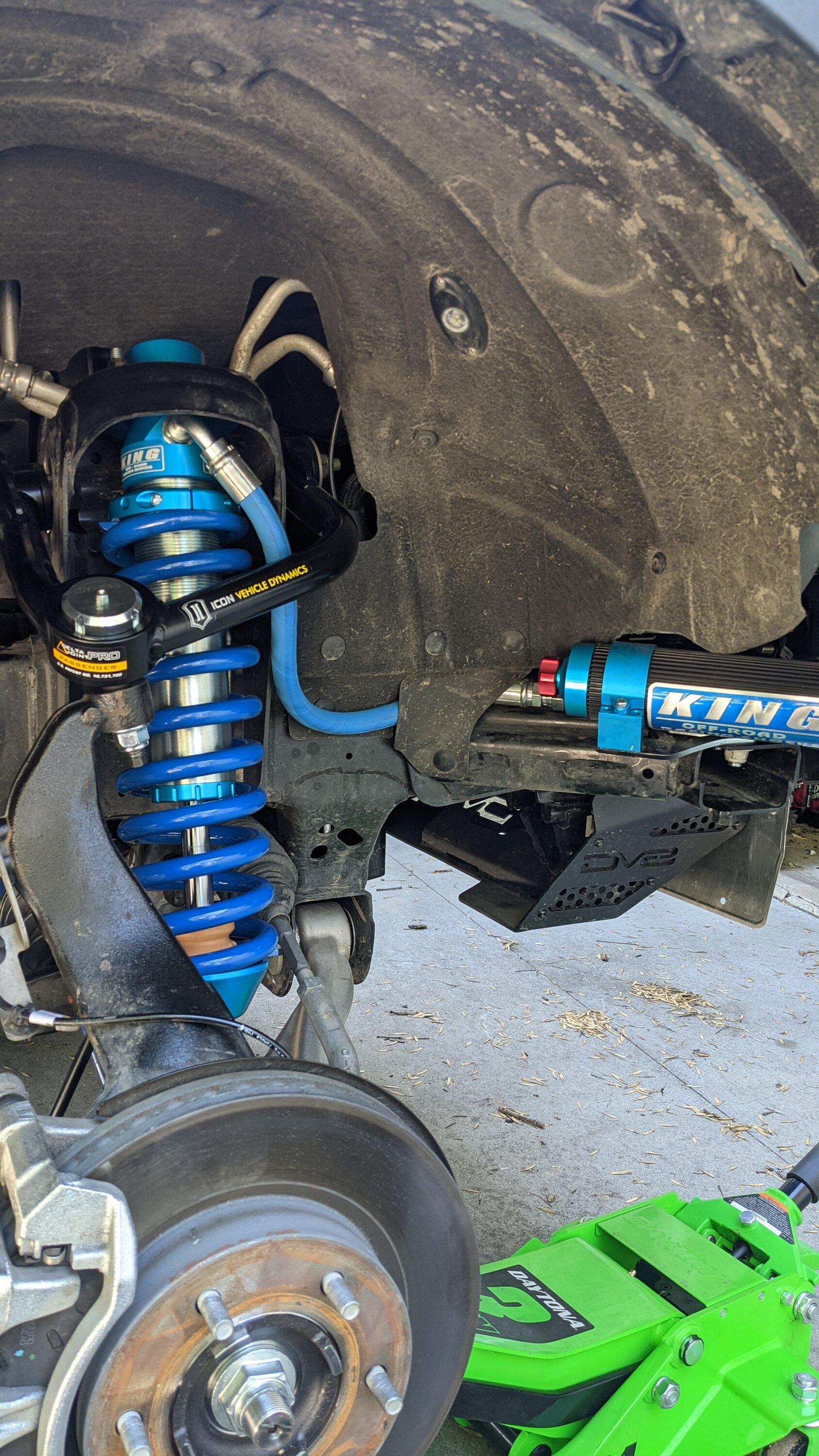

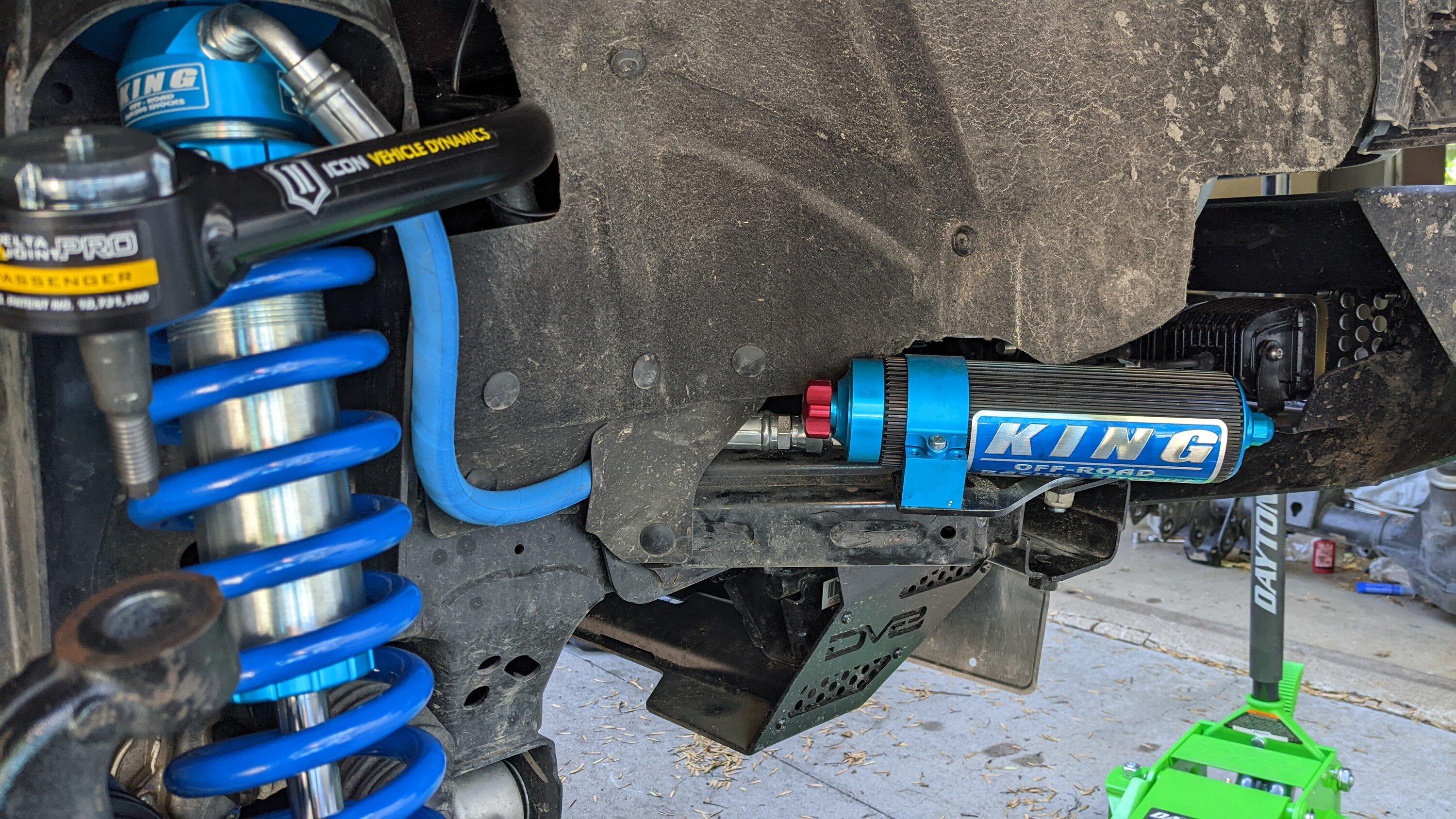

One thing that I initially just didn't like, but now it's a real issue, is where the front reservoirs are supposed to go.
The DV8 front skid plate won't allow them to mount up close. Flipping the mounts around puts them out in harms way.
Fabtech's mounts put the resi aft of the strut, but they don't have adjusters.
I'm going to have to mess around with this a bit and find a good solution.

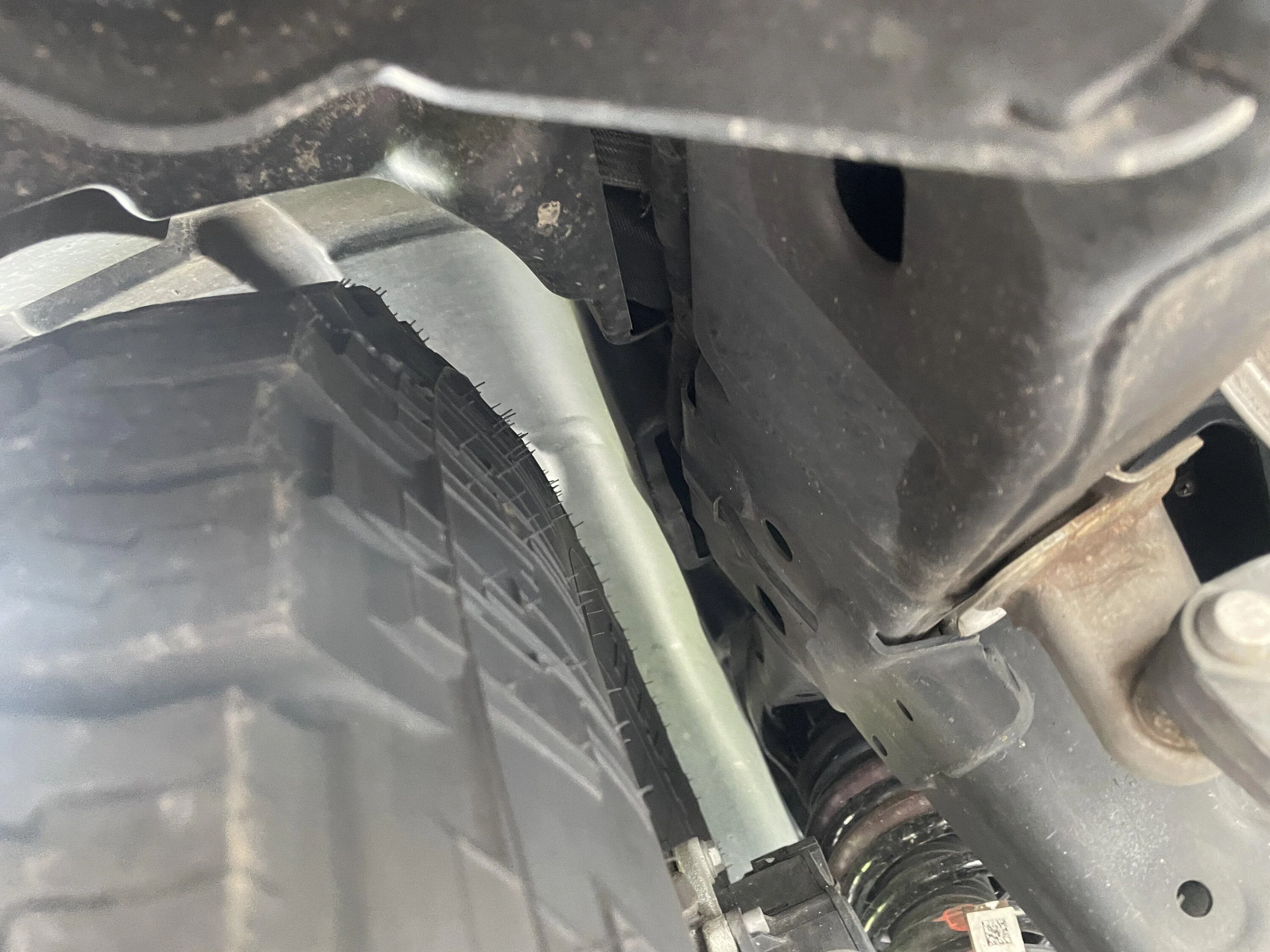

I’m sure you have but double check for contract on the resi. Space gets tight in a hurry. This was stationary and not fully flexed just as high as I had available. If your not doing extreme flexing I’m sure you’ll be fine

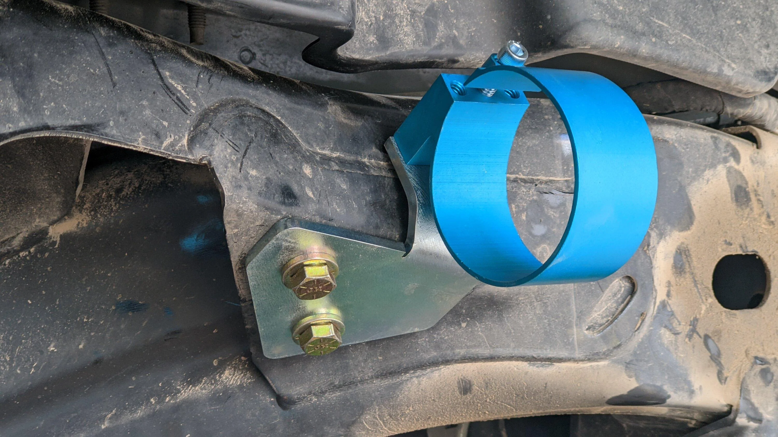

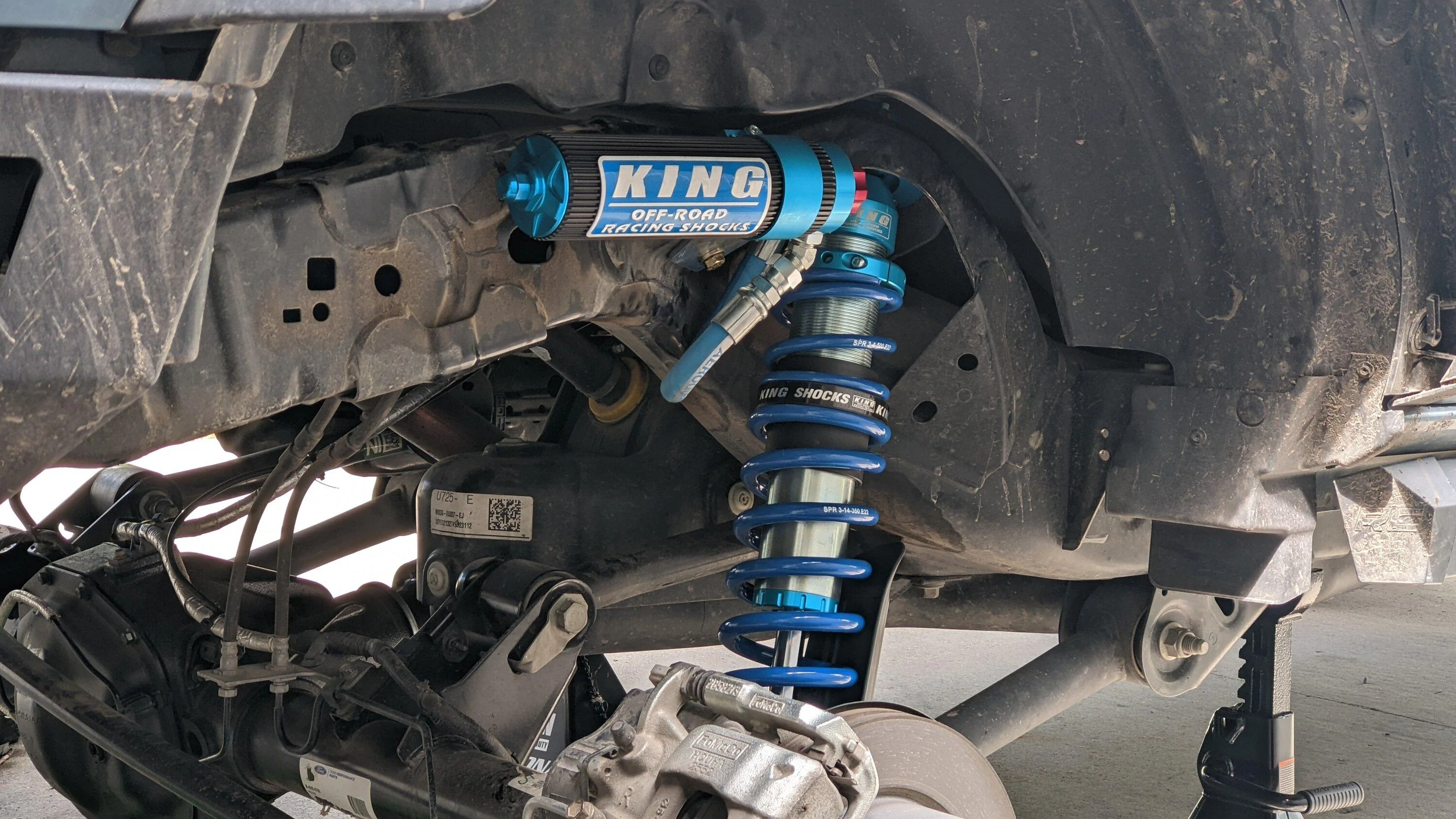

Well, with a little creative engineering, I was able to modify the reservoir brackets to mount to the top of the crash bar mounts, tucking the resi's nicely up behind the bumper.
My first attempt was to have the resi's follow the frame line but between the chassis and body mount. It just wasn't a good fit as there's a flange that's in the worst spot and prevents the bracket from fitting.
The "fix" just required one hole to move the bracket over, and then cutting off the "extra hole" point of the bracket. Once in location, I used an adjustable wrench to bend the bracket down about 10°, then put the aluminum collar mount on. The brackets are hot dipped or some such mild steel, so I shot the new hole and cut end with some black paint.
Ford Bronco King 2.5 Bronco kit installed PXL_20220804_202659111
I did trim the fender liner a bit to make a hole as well.
The lower OEM shock studs are the same size as the crash bar bolts, so I used those nyloc nuts to secure the bolts King provided. Too easy! 😎
Ford Bronco King 2.5 Bronco kit installed PXL_20220804_210333134
Ford Bronco King 2.5 Bronco kit installed PXL_20220804_212416100
I still need to finish greasing everything, but she's installed.

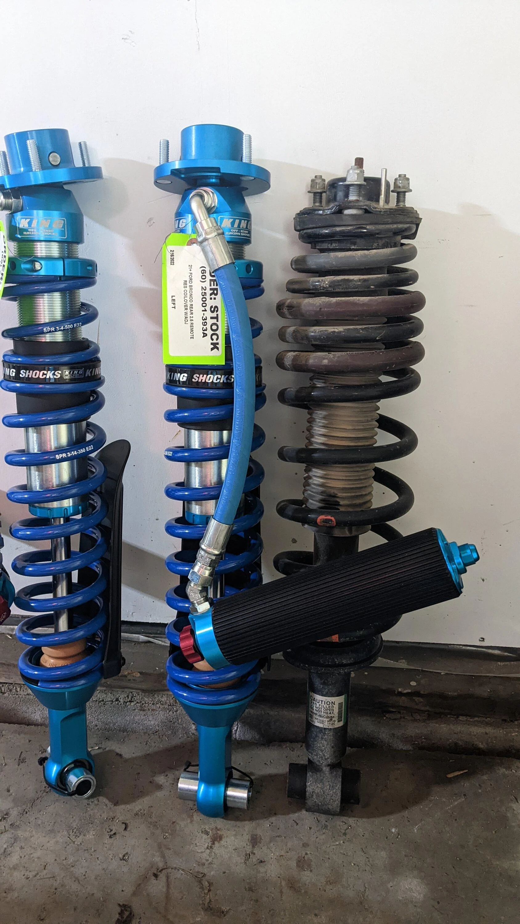

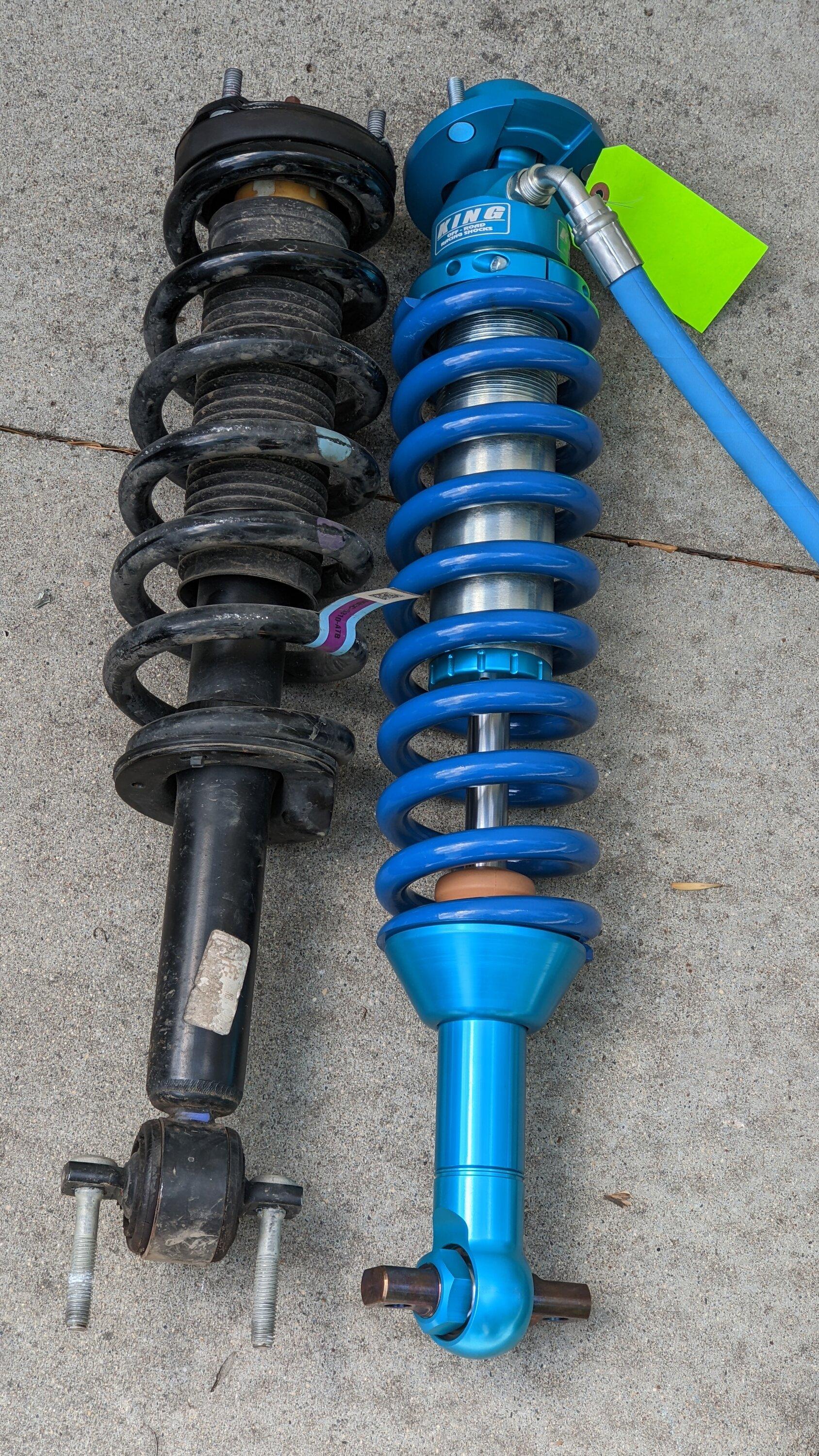

I almost forgot. Stock fronts vs Kings:
Ford Bronco King 2.5 Bronco kit installed PXL_20220804_193001820
I took a little jaunt out on some gravel roads (I live in the boonies and my in-laws farm is on one as well) and really like the improved suspension of the King's. I used to feel like I was driving on ball bearing or marbles while doing 45mph on the class 5 gravel. Now I'm very comfortable pushing 60mph without telling like I'm one section of washboard from going in the ditch.
The constant nose diving is also a thing of the past.
First impression is that King lived up to their hype 👍
