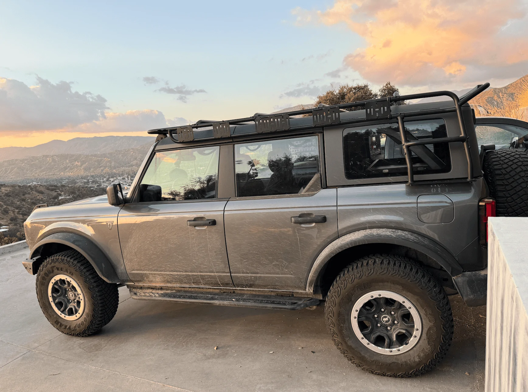

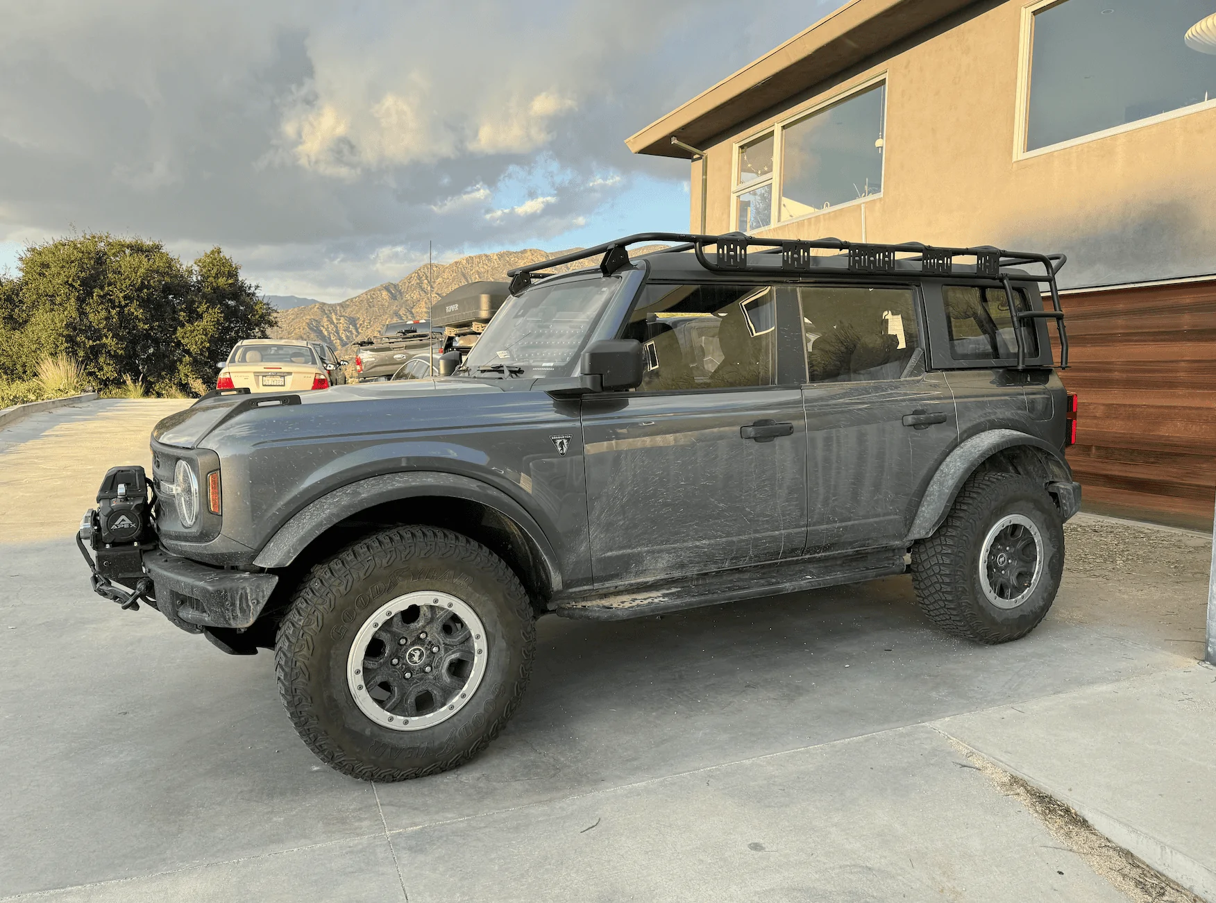

Just thought I’d pop on here to give you guys a look at the King 4WD roof rack. I’m in the beginning stage of what will probably be a very slow and just as low budget build on my beloved bronco. And being that I was a first day reservation holder and actually volunteered to push off my reservation until 22 (sorry you guys who are still anxiously waiting), I’m in no rush. I waited 32 years,from the day I got my drivers license, to actually own a bronco and my dreams for the most part finally came true. It’s dirty, but that’s just because more time is spent driving and wheeling than time for cleaning…….and I’m lazy.
Ok so to the real reason for the post. Just installed the King 4WD Roof Rack…..Been on the forums multiple times waiting to see if anyone would post some pics of their newly installed King 4Wd roof rack to get more info but just never happened. Have been going back and forth between the Raptor Gobi rack and this one for the last year mainly because I want a rack the doesn’t mount on or come into contact with the roof. There is no info out there for this one other than a couple of photoshopped images.
Well the price was unbeatable for Black Friday, just over $1000 (I also found a code online that brought the price down significantly) and compared to the price for the Gobi, I decided to be the guinea pig. Plus I found out the company I bought it from……*wait for the name drop* "Overland Vehicle Systems" is about 40 miles from me so if I truly hated it I could just drive it back to them instead of paying any shipping.
Ok so anyways to answer the obvious questions. I called OVS and asked them what the ratings were on this because it is nowhere on any site. They told me 300lb dynamic, 850lb Static….they could be blowing air up my .....… but hopefully there is some truth in there. I guess we’ll wait and see.

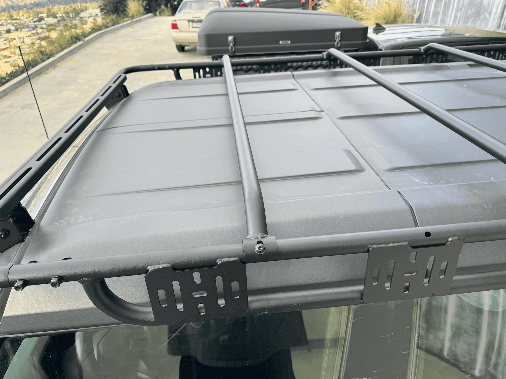

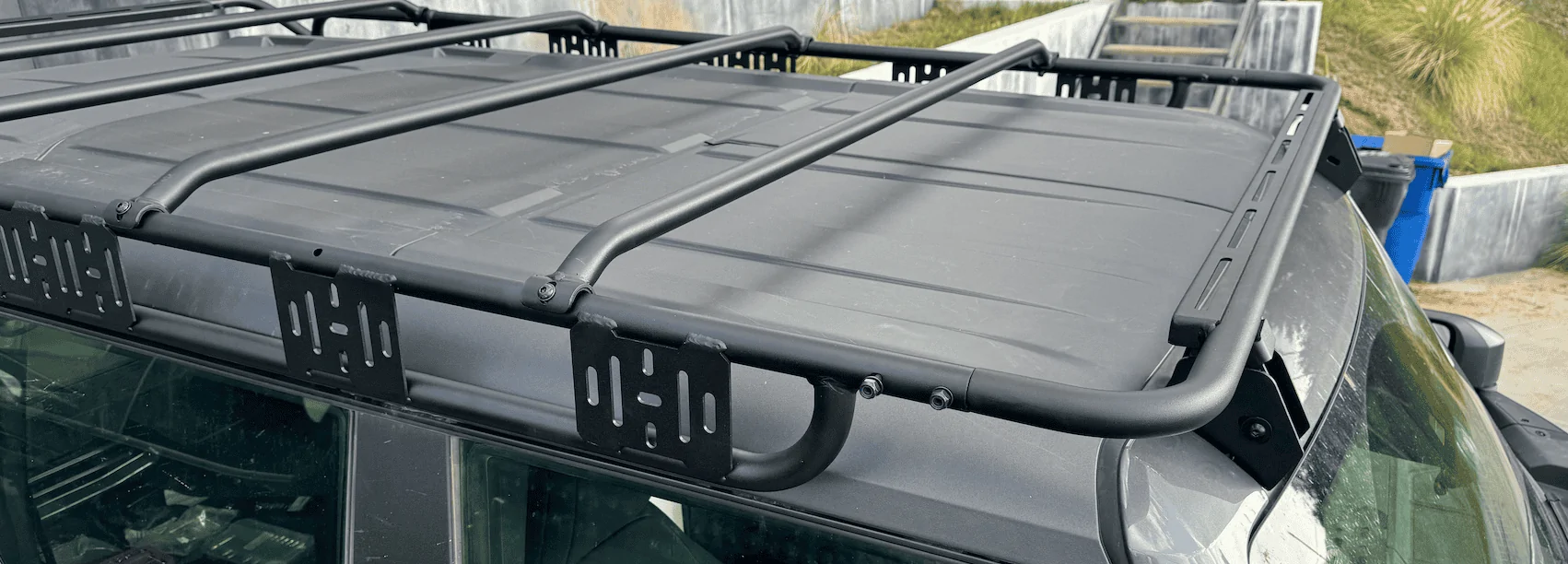

And for the next question I’ve seen floating around. Yes you can remove the front and middle roof panels with this mounted. You just need to take off the front cross bar for the front and if you’d like to remove the middle take off the second one. But the over hang on the sides does not impede anything because the panels come out through the top.
Install was ok…instructions are fairly good, just wish they had a better parts list and identification. But just go slow and take your time….took about 3 hours and slow moving on my part.

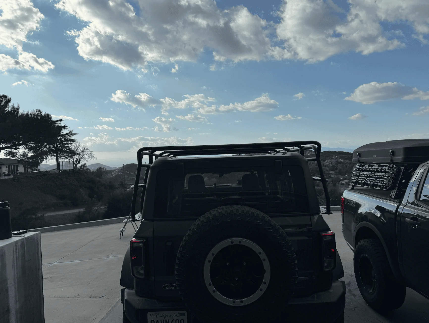

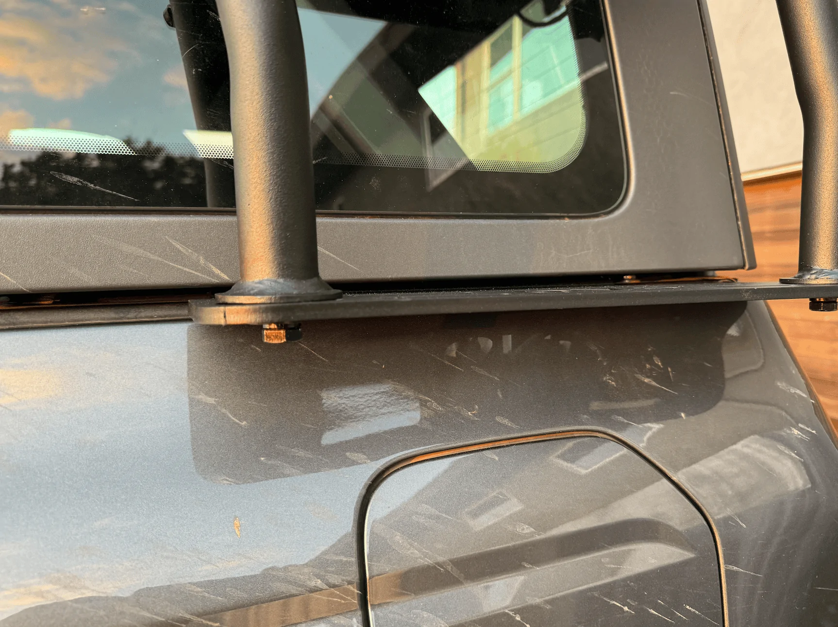

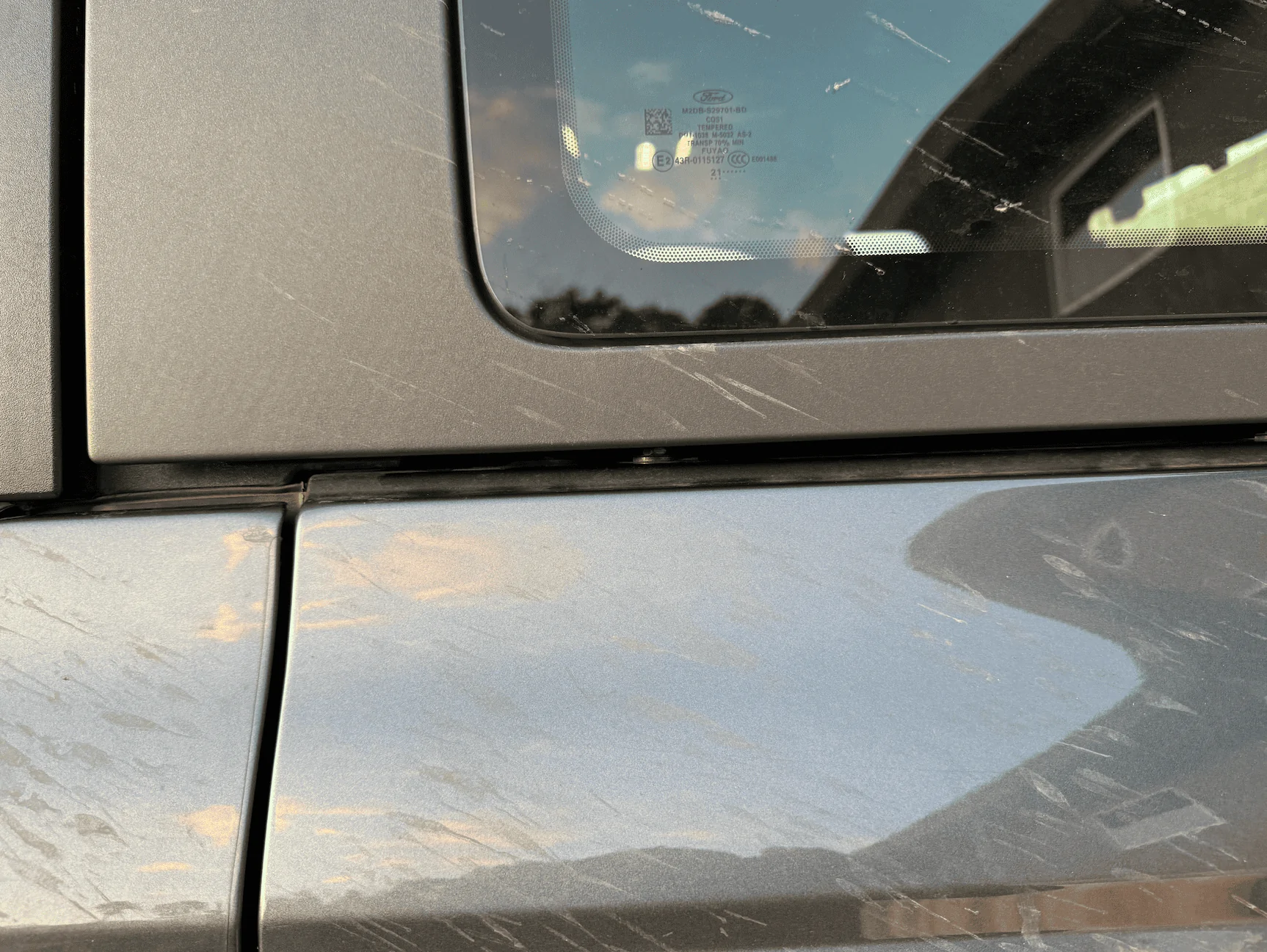

Only downside, but not sure yet if it’s a real downside is the ladder that attaches under the back. That metal is about 1/4” thick so it raised the back cover. Think body lift. It doesn’t look terrible and they do give you some heavy duty dense foam with adhesive to take up the spaces next to where the bottom of the ladder installs (wish they would have made the ladder base the whole length) but there are a couple of gaps so I’ll most likely grab some foam weather stripping to put in the cracks.

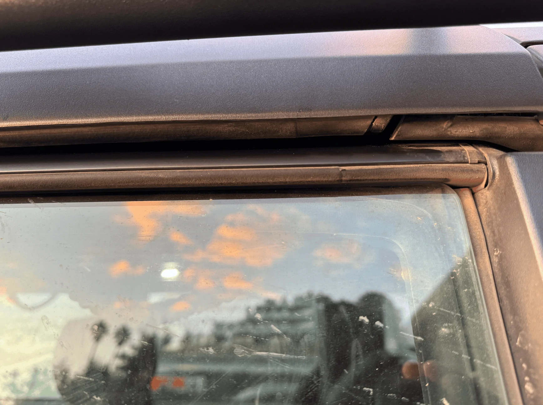

Now being that it raised the back it also raised the back end of the middle panel. Tried to show it in the pics the best I could. The seal looks ok between the middle and rear panels but time will tell if there might be some leaks. There was a noticeable gap just above the back door window but over night it settled and is not as big, but it is still there.
And last question which I’m not sure everyone cares about, but I hated that big block, in the photoshopped pics, of the front where the lights mount….in all the pictures it just looks massive and ill proportioned. Well in real life it doesn’t look that bad and the best part is you don’t have to install it if you don’t want to. I of course chose not to. Now I just gotta find someone to fabricate some covers for the front mounts so it looks finished. But I got it up to about 85 today on the freeway and it was maybe a little bit noisier and I didn’t have the radio on. But by default I usually travel around with the radio between 12-15 so it drowns out all the noise these broncos are known for.
The finish is nice, welds aren’t the greatest but everything fit with out much hassle and I needed minimal help to get it installed, but mostly did it myself.
Overall I’m pleased, Once installed and tightened down this think is stout and solid.
If you're on a budget and don’t want to pay the Bronco tax this might be a great alternative. And the great part no crazy branding....Mine just has OVS on the bottom steps of the ladder.

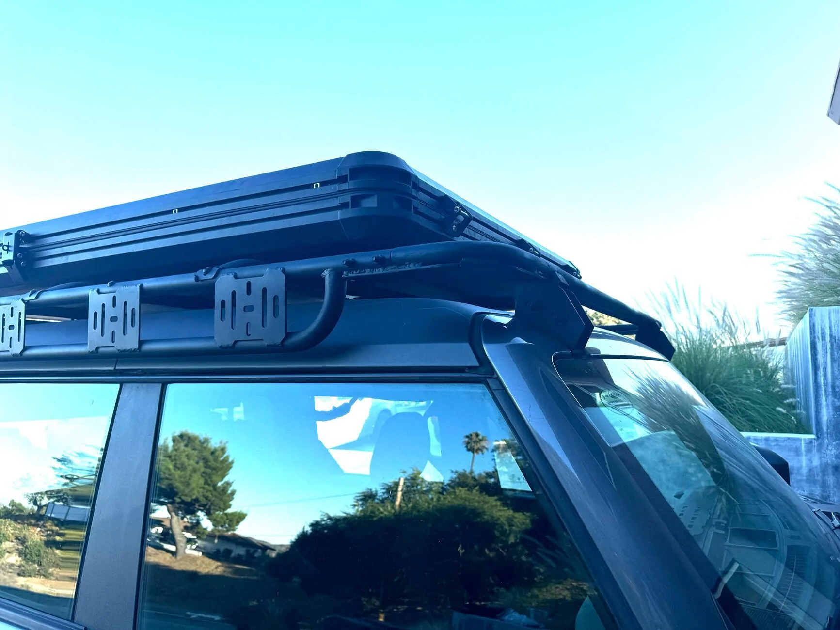

So a couple days after installing the RTT when I'd hit a bump in the road, I'd get a little squeak, which ultimately got louder over time. Cut up some bike inner tubes and went up top and put them any where the RTT rails touched the bars. It seemed to work, but only for small bumps but if the road was bumpy or had a lot of potholes (I live in SoCal, we got potholes everywhere) the noise would be back. over time it just got worse.
Located the noise....there are 2 places up front that the tubing slides into each other and those were rubbing/moving overtime I would hit a bump or pothole. it got really bad....sounded like styrofoam to go containers rubbing against each other but like 10 time crazier. Hated driving to spots late in the evening cause I'm sure you could hear me coming a mile away.
The fix. Bought some corner metal pieces at a metal supplier near me and welded them on. Creaks, noises..... everything gone.
And also glad to report that I've had no leaks....Went through the crazy rain we had her in Cali and have been through a couple of carwashes and all good.
I would definitely buy the rack again as it can be easily modified especially since it can be welded. Going to post some other mods I've done a little later today.

And yes the welds are funky, but I'm not a pro just something I like to do once and a while.
