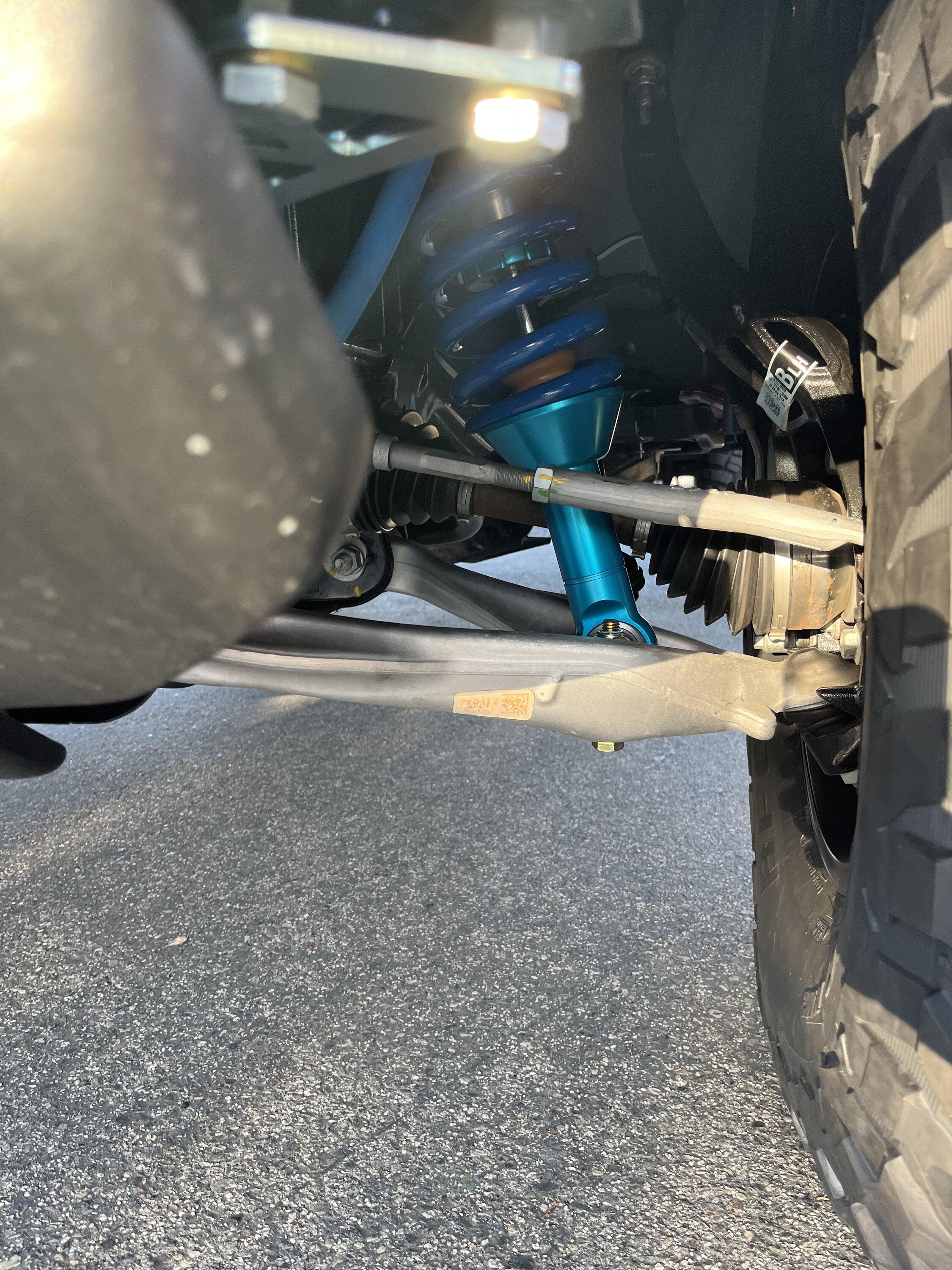

Here are a pic of angles at ride height
Ford Bronco King Shocks DIY install underway UPDATED WITH NEW PICS 15E8342F-3EF2-4786-9577-686FDE2703E9
Your CV and tierod angles look much better than mine. Could you take a look at what spring rate and length you have on your front coils? Mine came with SPR 3-16-550 and after 1000 miles I still have some steep drive angles on the driver side (shorter axle).
sorry I haven’t been on in a while
i can check for you
