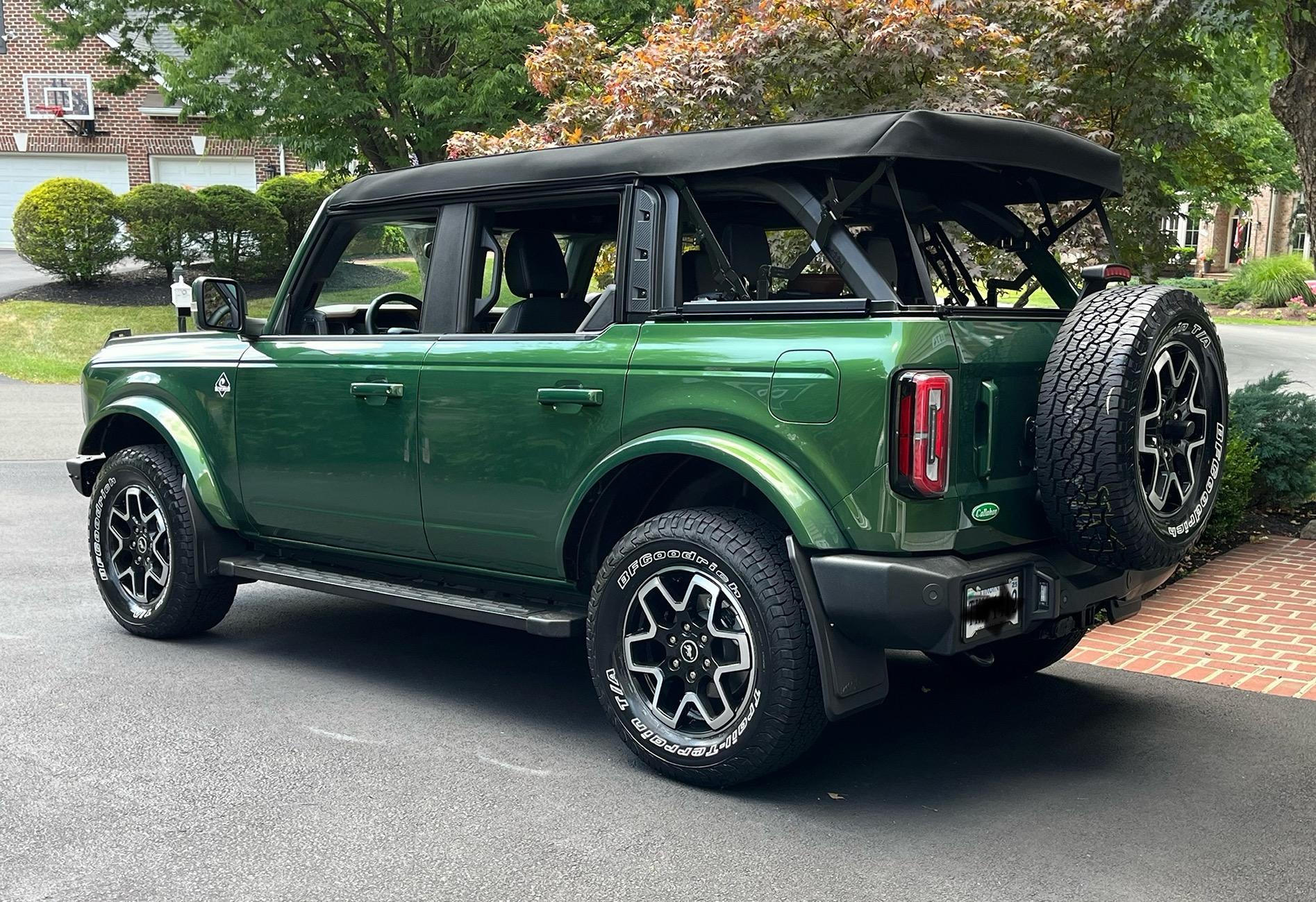

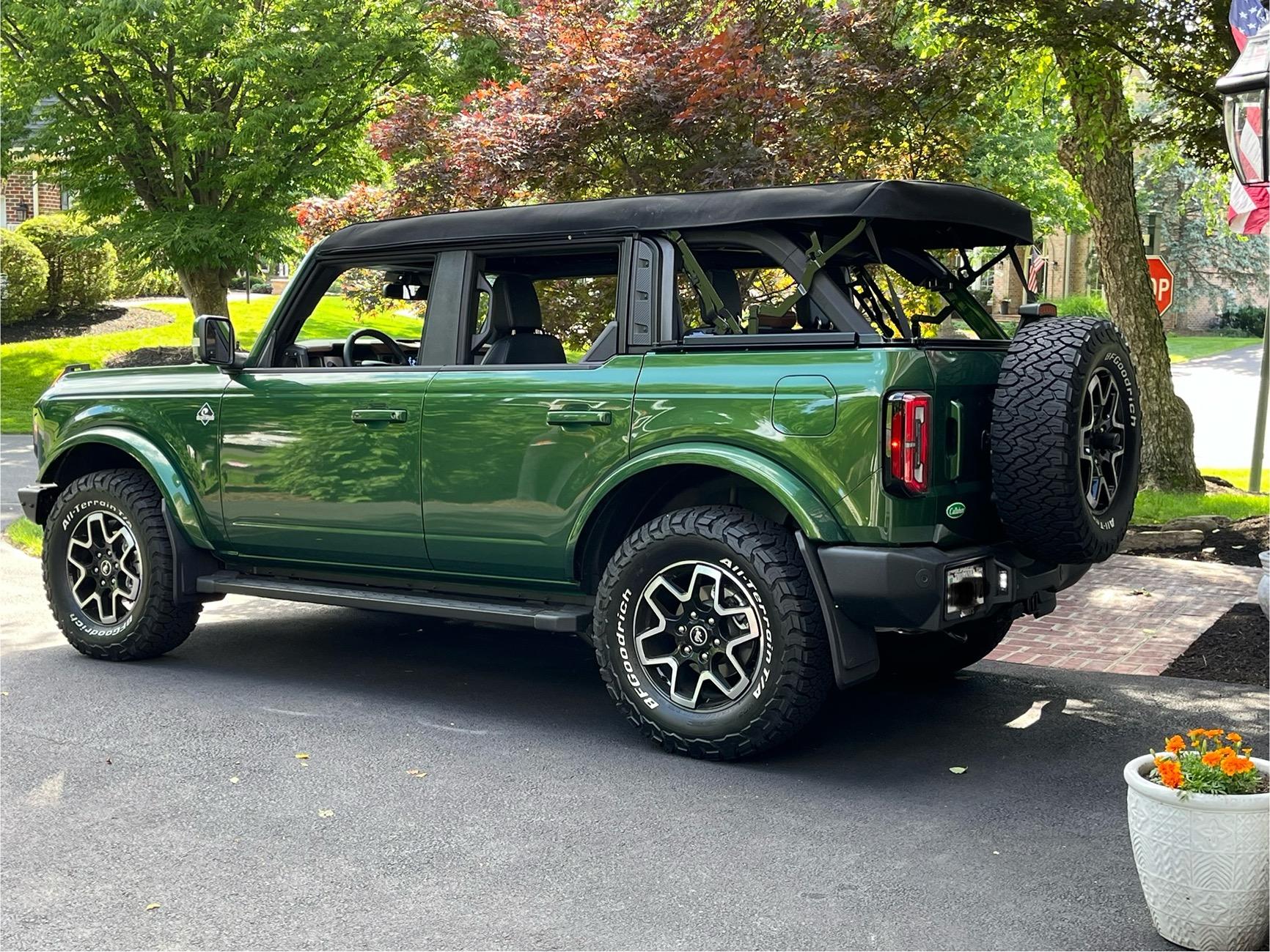

Ok, so initially I bought 285/65/18 KO3 for my Bronco right out of the gate. Kept OBX rims. But, had a horrible time with highway shakes and couldn’t get any of them to balance very well. Got close, but didn’t last long. Whole car shook left right. Road force score of 19-21 all around. Didn’t matter. Shaking never went away for long. So I tossed in the towel for BFG Trail Terrain (275/65/18) instead. Key difference being load rating. KO3 are E rated and very heavy at 60lbs each (slightly more than KO2’s I believe). The Trail Terrain tires are SL (Standard Load) rated and much lighter. Bottom line, no more shaking, rides smoother and quieter, and pretty close to keeping what really attracted me to the KO3’s in general - white letter sidewall.
Here is a picture comparison of the two and the differences in appearance. The solid white letters are the KO3’s (285/65/18), and the outline lettering are the Trail Terrains (275/65/18). There is about a 1/2 inch difference in diameter between the two and maybe a CM or two on width?
my own personal opinion, I like the Trail Terrains better. I like the outlined lettering more , and like the little more street-friendly size for my needs and intended uses. The E rating was just far too much for what I will ever ask of the car to handle. When considering the MPG’s of such a heavy tire (60lb+), super stiff sidewall and ride because of it, other than how they looked, they were the wrong pick for me. Glad I made the switch.
if you’re thinking of KO’s, please know the E rated comments on here from others, are legitimate. NOT a terrible ride, and road noise is OK, but they are certainly stiff and you absolutely feel that heavy unspring weight.
Congrats on finding a tire that works for you. I personally like the appearance of the KO3’s a little better but not being able to balance would be a deal killer for sure.
By chance did the shop that sold you the KO3’s try a different set/batch? Or did you consider the KO2’s. My Badlands came with KO2’s and they are solid.
In regards to width, there is 10mm variance which is just a hair above 3/8” difference.
Width = 285 - 275 = 10mm / 25.4 = 0.393”

Thanks for the education on the size difference! Wasn't sure what the difference was, and honestly can't really tell when looking at the new set against the old set on the car. We were able to get 4 of the 5 tires to roadforce into the 19-21 range, but replaced one that wouldn't go below 34 no matter how hard they tried. We got that new one down to the range of the others as well. We discussed swapping out to the K02's instead, but was told by the tire distributor to the dealership that they can't order K02's anymore and couldn't get their hands on what I wanted (285 or 275 / 65).
I think the K02's are likely perfect, and believe the K03's will be too. But think they have some more work that needs to be done to compare to the K02's ease of use. I really loved the way it looked with the K03's I had on there, and one area that was better than the T/Terrain due to the weight was the insulation of the bumps in the road. I feel more of them with the T/Terrain, where I didn't with the K03's. Not bad by any means, but went from truck-like to more passenger-car like.
