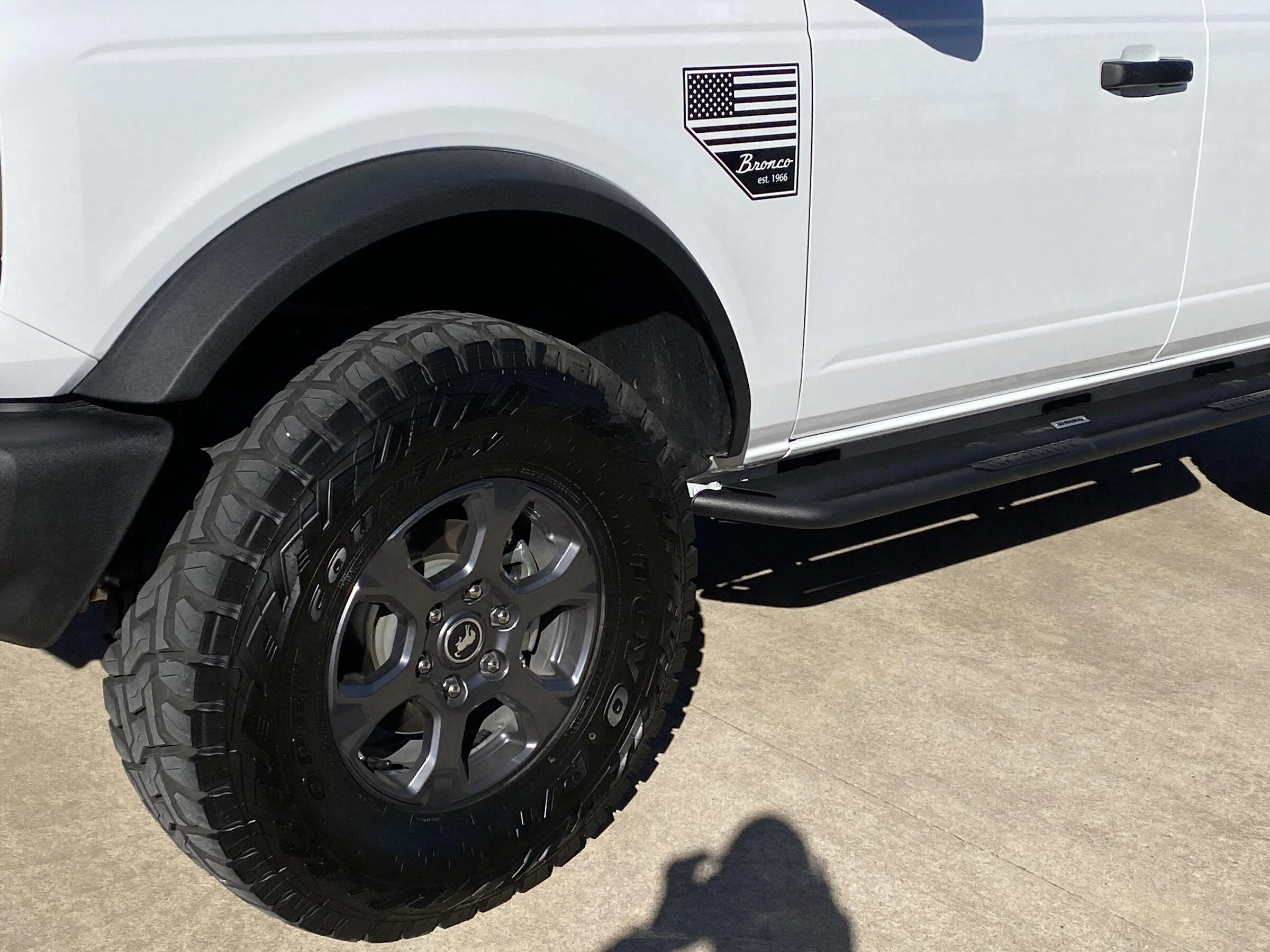

I put 285/75R17 Toyo Open Country R/Ts on my stock BB wheels while I waited for my Pro Comp wheels to come in. They worked great.
Ford Bronco Larger Tires for Big Bend? A57DD5FF-6DB9-411A-935C-0B948D804F3C

Looks great with the stock wheels. Personally I'd save some money and keep them.
And I'm not much of a decal guy but that looks pretty good.
