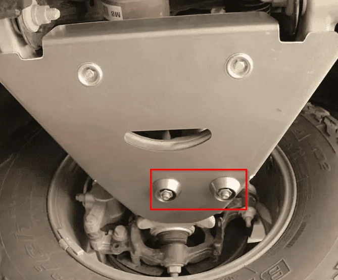

I put on the @ASFIR 4x4 front lower control arm skid plates a few months back. https://www.asfir.com/arms-skid-plate-599657.html.

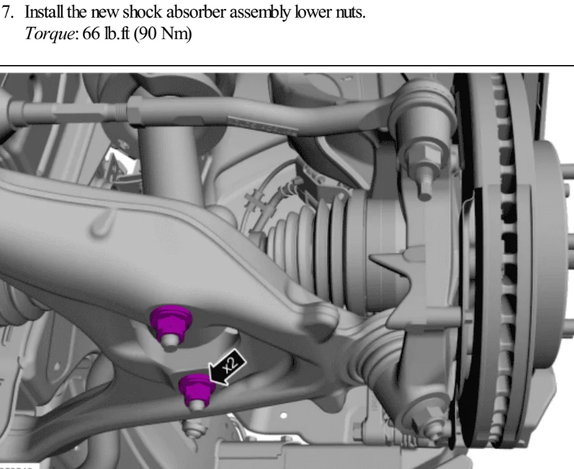

About a month after installing them I started hearing a creaking when I would turn my wheels while stationary or moving slowly. I traced it back to the shock bolts. I loosened those a bit, turned steering wheel, and the creaking went away. So, I took off the skid plates, used a Dremel to smooth out the holes going through the plates, put antiseize lubricant all over the place around the threads and hole, and then reinstalled the LCA skid plates. Torqued to 66lb.ft as shown in the service manual. The creaking went away. Now, 2 months later, my drivers side is starting to creak a bit again. Anyone having a similar issue? Anyone have any suggestions on how to fix this permanently? It gets a bit embarrassing having a brand new vehicle creak like that.

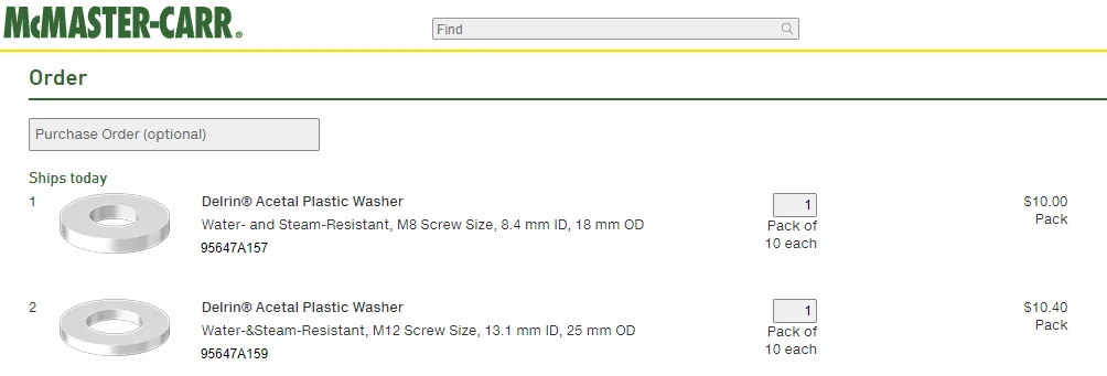

I tightened my bolts up 5 more lb.ft and that seemed to help.....for now. I don't want to over torque them though. If this doesn't last then I'll go with the Delrin sheet, drill a couple holes in it for the shock bolts and put it between the LCA and skid plate. Delrin washers may work also, but that may not cover a big enough surface area. Also not easy to find them. Seems like McMaster-Carr is one of the few who carries the washers. https://www.mcmaster.com/acetal-flat-washers/

Torqueing the nuts down more didn't last long. I took it off road a bit and then the creaking seemed to come back with a vengeance. It was driving me nuts. I removed the LCA skid plates until I can get some Delrin washers to try. I order some from McMaster-Carr. They have Delrin sheets also, but washers will be much easier. I think a 1" OD should provide enough surface contact to help. We'll see.

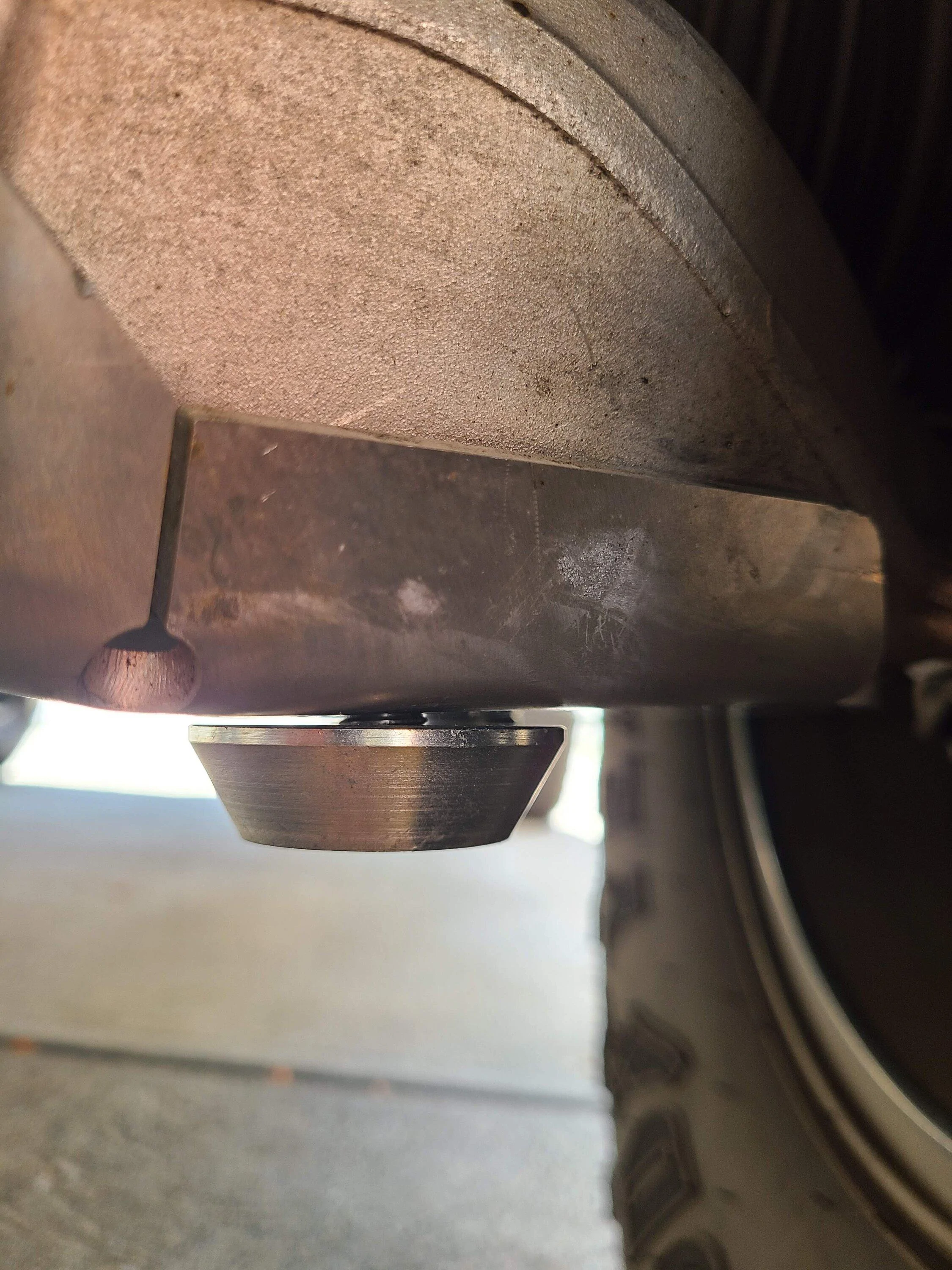

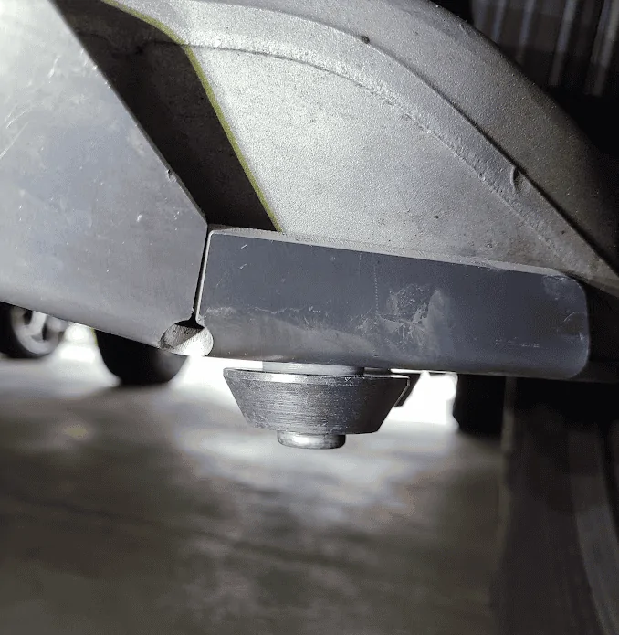

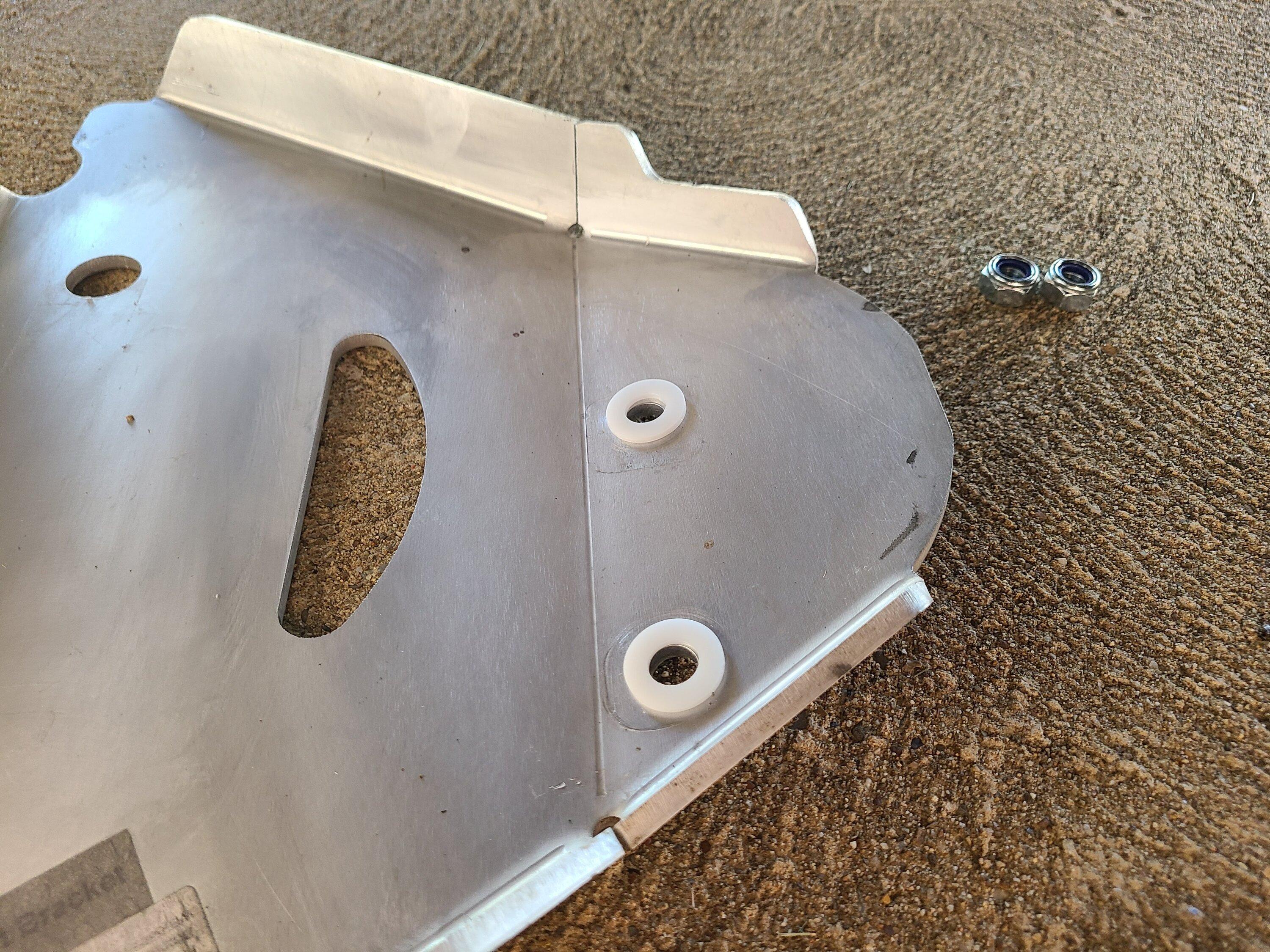

I reinstalled the skid plates with the Delrin washers, as you can see in the picture. It may take over a month for any creaking to come back. That's what happened the last two times I reinstalled them because of creaking. If it does come back, I'll put another Delrin washer under the dome nut protector, which would sandwich the skid plate between two Delrin washers. Hopefully the problem is gone now.
Ford Bronco LCA Skid Plate Creaking 20220813_105935
This is where I'll add another Delrin washer if the creaking returns.
Ford Bronco LCA Skid Plate Creaking 20220813_110216

Well, the Delrin washers were a complete failure. After adding the washers on the top of the skid plates, the creaking came back in 3 days. Last night I added Delrin washers between the mound nut protector and the skid plate. The creaking was immediately worse. So, I completely removed the skid plates again. The Delrin washers must have allowed the skid plates to move even more. I have no idea what to do now.

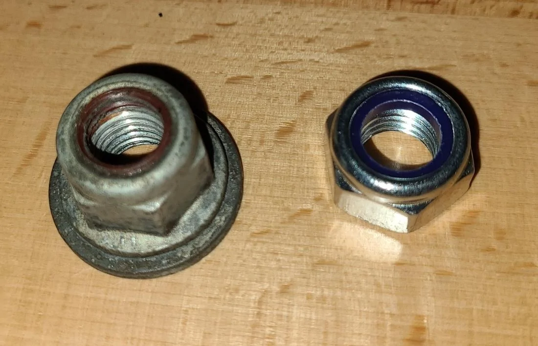

Hello, I bought some lca skids before seeing this post though I might be able to cancel since they haven’t shipped yet but I am aware that the factory nuts used to hold everything are supposed to be one time use due to their locknut design possibly also utilizing a locking compound on the threads when factory installed. Perhaps replacing those nuts with Ford parts or comparable will provide more permanent holding power and prevent squeaking? Maybe drilling out the skid plate’s mounting holes to go over the nuts completely and finding another way to clamp/attach them to the arm?

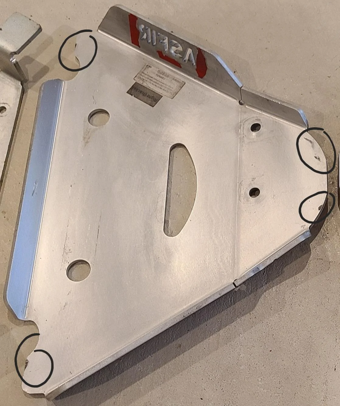

After the nut stripped on my first time installing, I purchased the oem Ford nuts to use. There are plastic locking ring around the inside to of the nuts. I didn't notice a locking compound. When that made no difference I reused the Ford nuts the next time with blue locktite. I also tried enlarging the shock bolt holes in the skid plate but that didn't help. I wonder if spreading some locktite on both sides of the skid plate where it clamps together might help. On the Asfir skid plates there are little wear areas that are probably where the creaking is actually happening.
