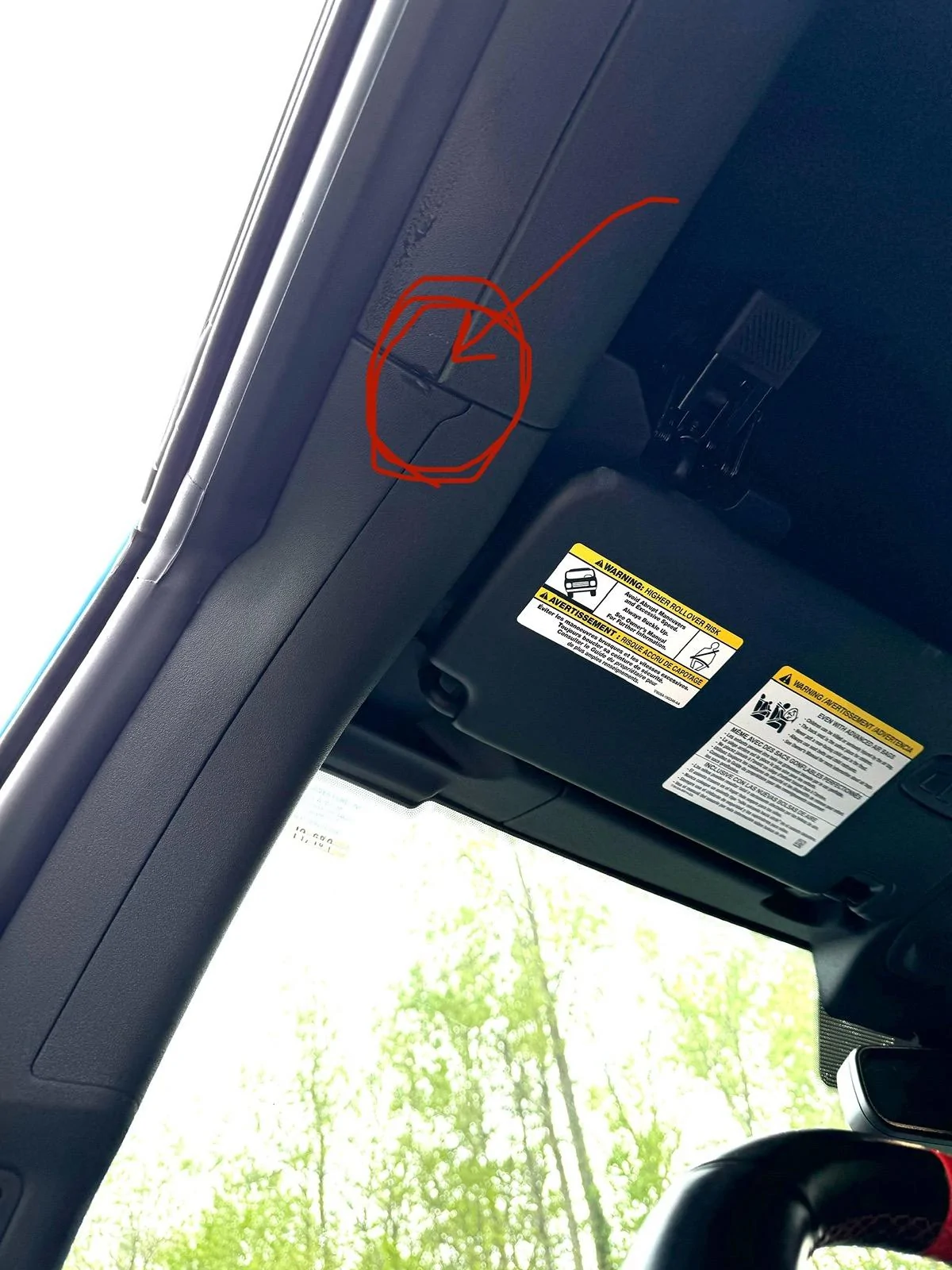

Raptor was sitting outside during rain (not that heavy). When I got in, I noticed water dripping from inside the cab.
At first I thought it could have come from the outside and trickled down, but I quickly discovered the water was trickling out from inside the plastic panel.
I am afraid this has been going on for quite some time, as my Raptor has an odor that smells like trapped moisture.
1) What can be done to fix the leak
2) How do I get rid of the trapped moisture smell

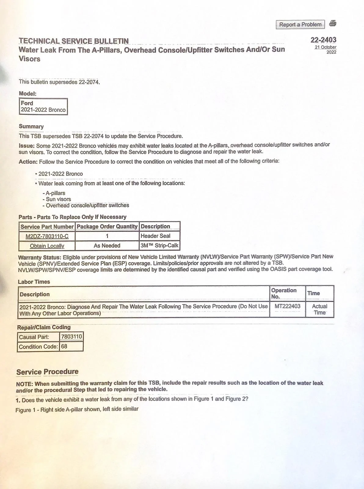

Update: The leak is covered under warranty by Ford. They released a TSB to resolve the issue.
The Ford store performed the TSB items today during the 5K mile service. Just passed 20,000 Miles
Seems like many Warthog owners have been affected by this.

Thanks for reaching out. The Ford store resolved the leaking issue today. Hopefully it is fixed now.
