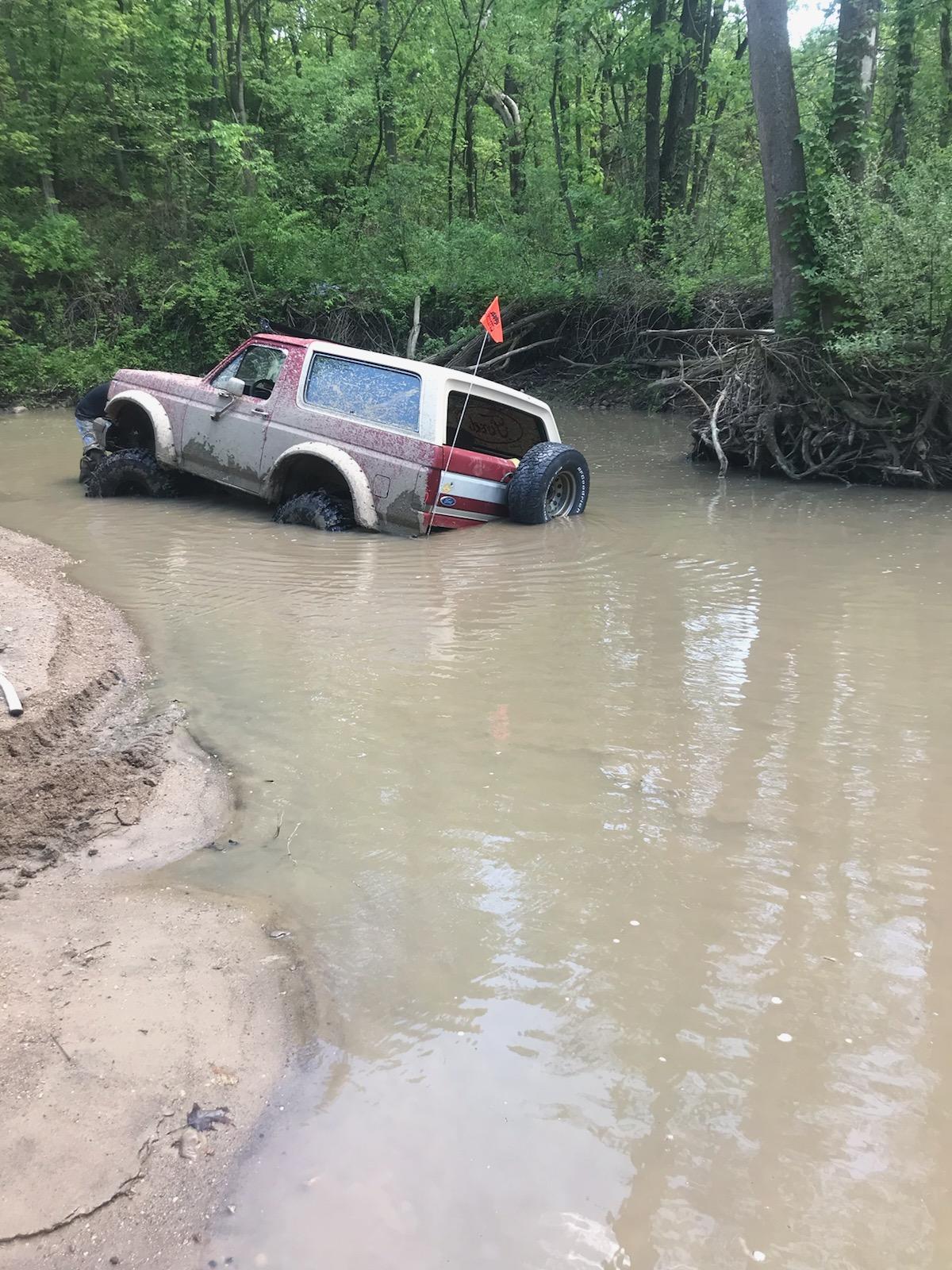

I had a winch mount for my Ranger and Bronco II's that hung down from the frame rails, tucked in behind the air dam, good set up. Something like that might work on the new Bronco, but would require a total bash plate redo.
U don't want anything below the frame rails...unless u out want to shovel your winch out to recover. The rails will be buried! In this pic I am wearing hip boots. I am not 100% sure I was stuck, but, if I got any deeper i couldn't have payed out my winch. I had to dig to get the rope!
Ford Bronco Let’s talk about bumpers IMG_36351
Where you wheel and what you wheel plays a factor. I hate mud more than I hate my ex-wife, between the rails and not stuck off the front where it will hit every single rock is where I'd want a winch.
Thats not mud its sand. If it was mud I'd have been ok. The sand was so loose under the water i plowed a big pile of it in front of my bumper. Between the rails would be ok if you can do it, but looks like things are pretty tight in that area on new Bronco. Even this old fsb I had to move the bumper forward a couple inches (simple brackets to fab) to make room. 2"of body lift as well, and w/all that the winch sits in there real snug!

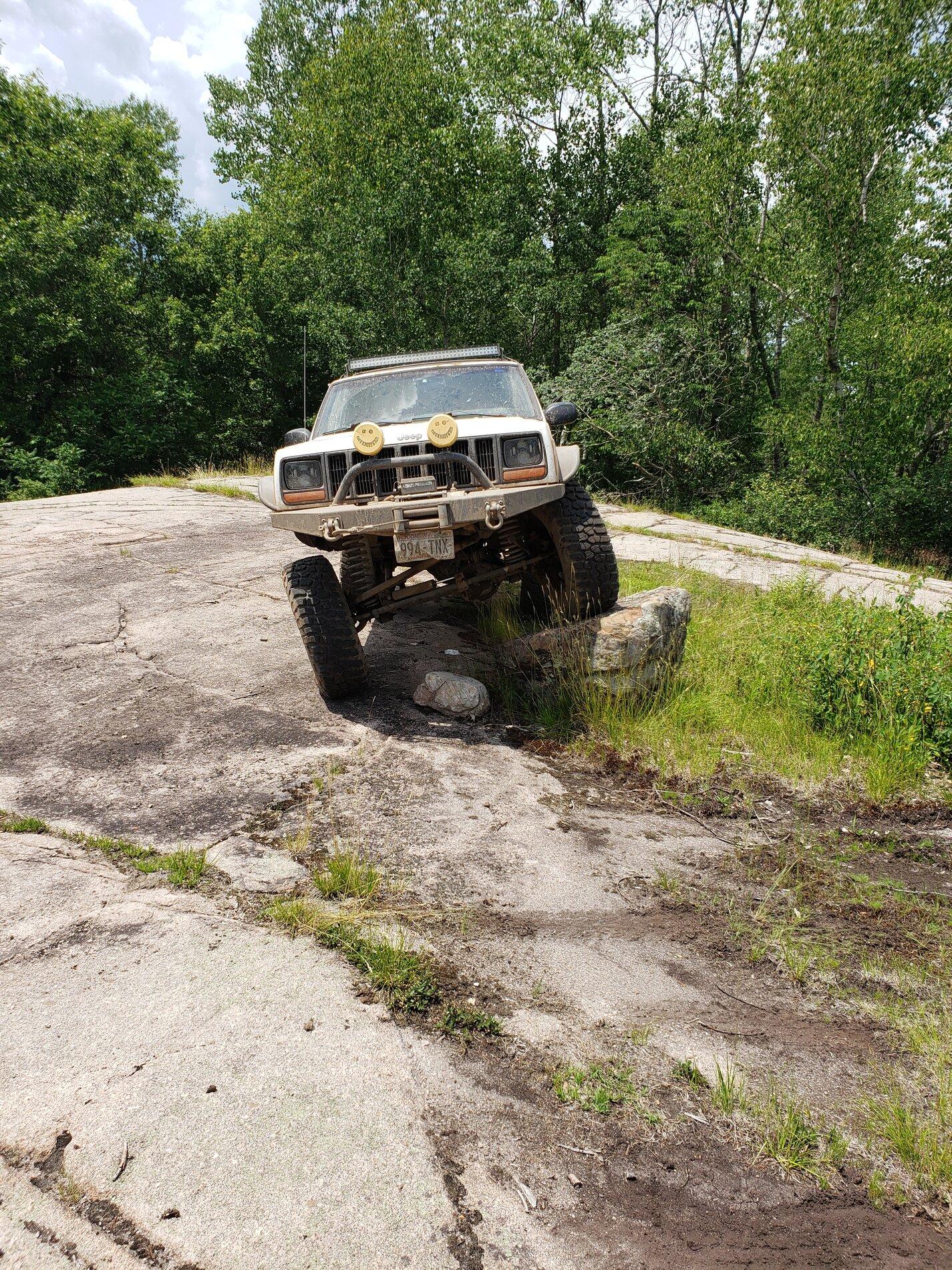

Yeah, some of the newer vehicles like the new superduty and new ram have fully hidden winch capability. Not sure I want it completely hidden, but tacked onto the front like the bronco is pretty awful for rocks, or nosing off a steep shelf..
I crawl some fairly hairy stuff w/my XJ and its got the winch in virtually the same spot. I'm not sure how having it mounted lower would help on rocks? It just looks funky on a Bronco because its not boxed in.

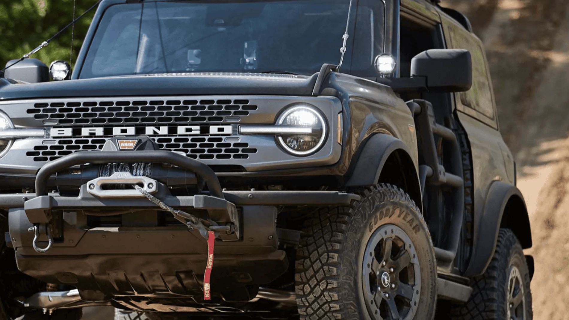

it isn't how high or how low, the mount they have shown sticks out 6-8 inches farther than the bumper. It's just hanging out there in the wind.
Ford Bronco Let’s talk about bumpers 1603486000404
Right...but the bumper is flush w/the grill...fits flat on the frame horns. I u look at my jeep above it sticks out by the same amount, just boxed. I dont really see any other way to do it, or any disadvantage of doing it that way. I do like the way it appears the winch plate can be removed easy enough!
