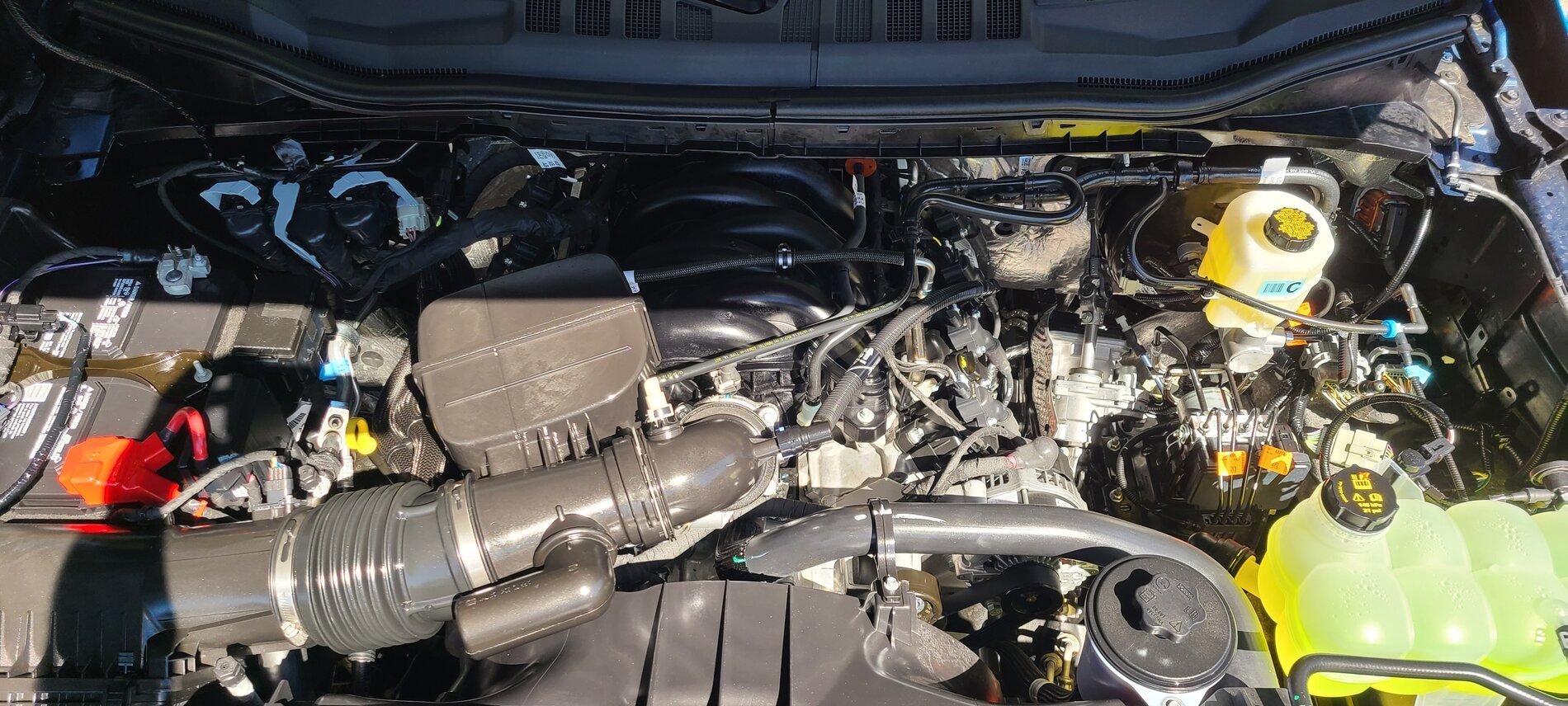

I would love it, but the deep skirt is probably a problem with IFS.
It's noticeably narrower than a 5.0 and sits low in a Super Duty engine bay. I'll climb underneath mine this weekend and see what it looks like.
Top view.
Ford Bronco Lets discuss why there should/not be a v8 option! 20210305_110516
