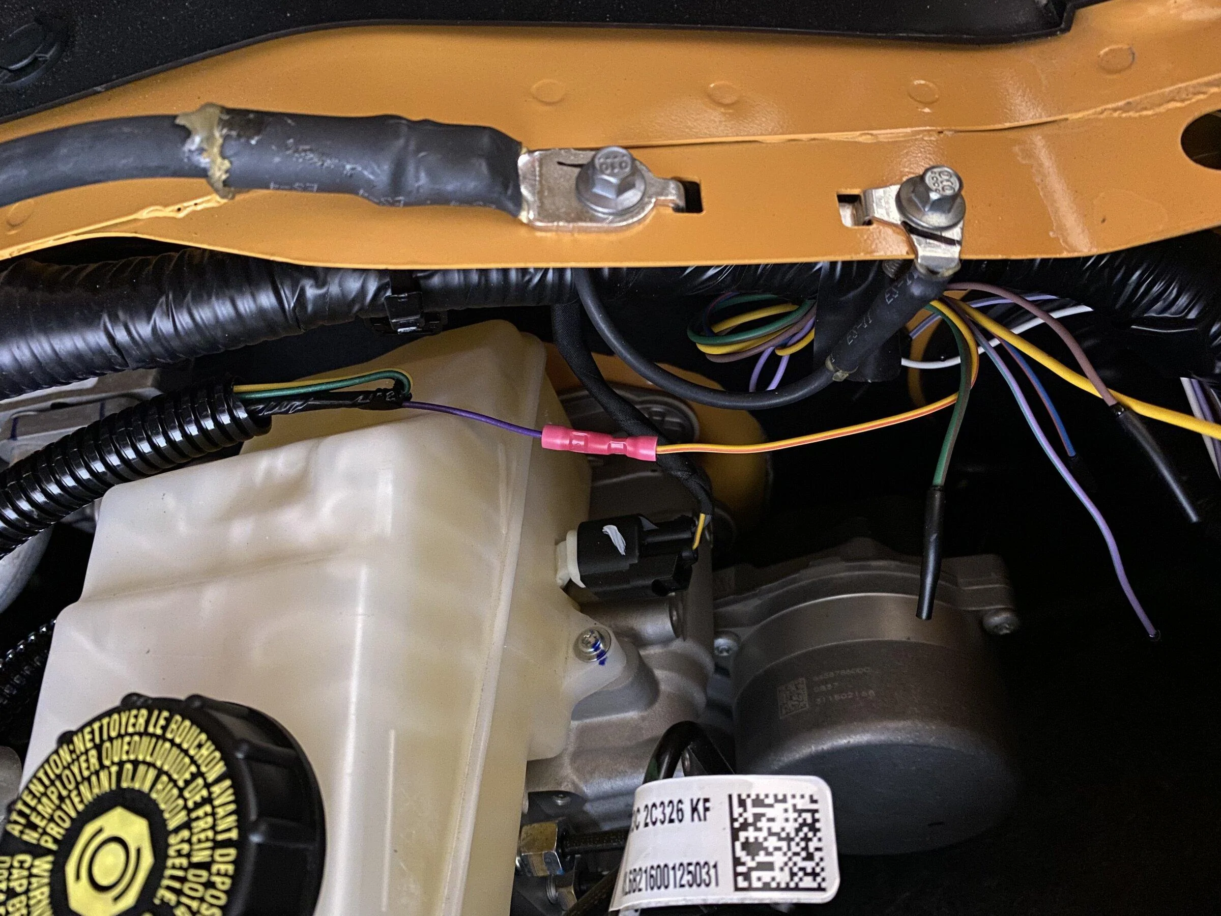

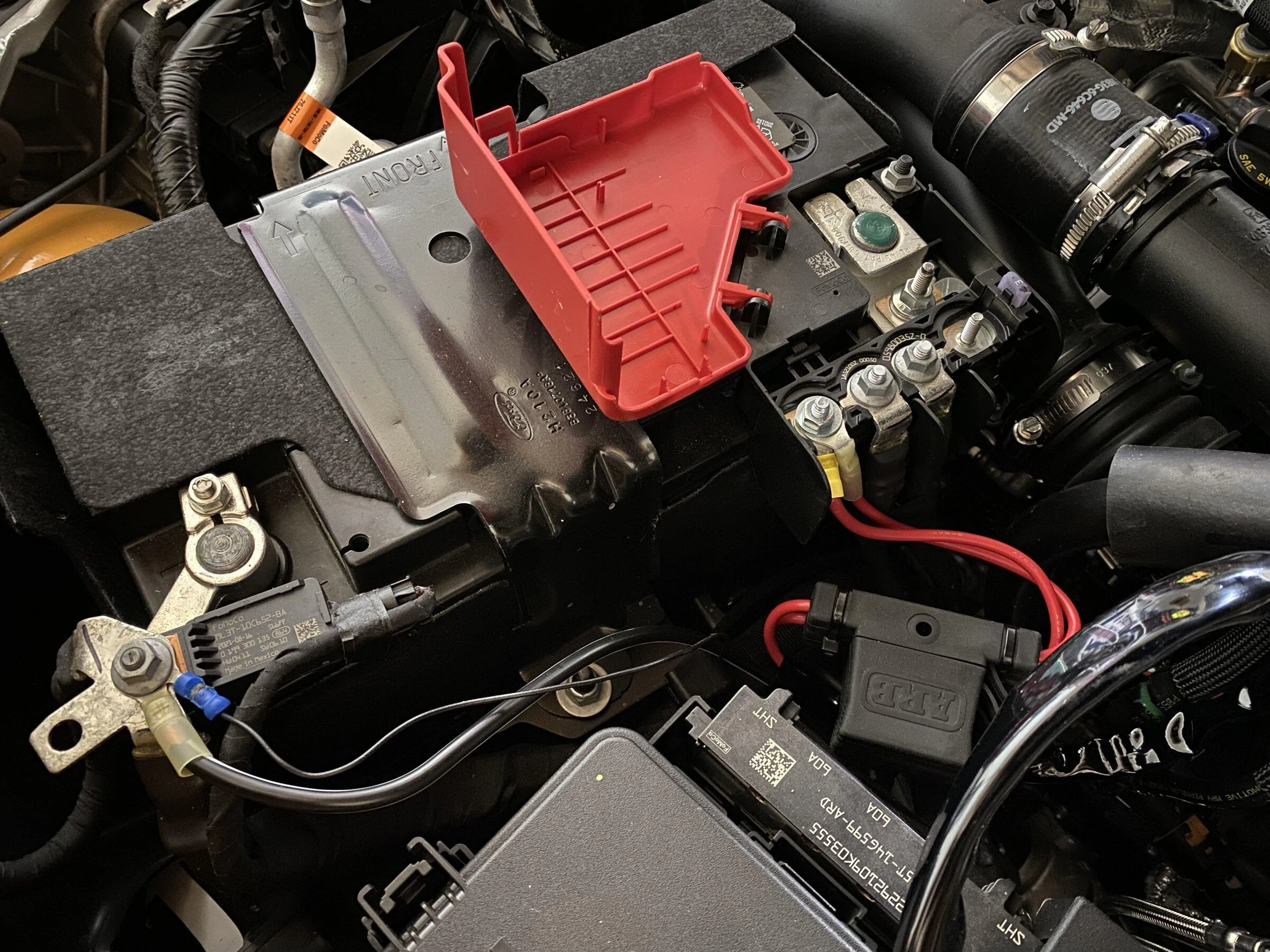

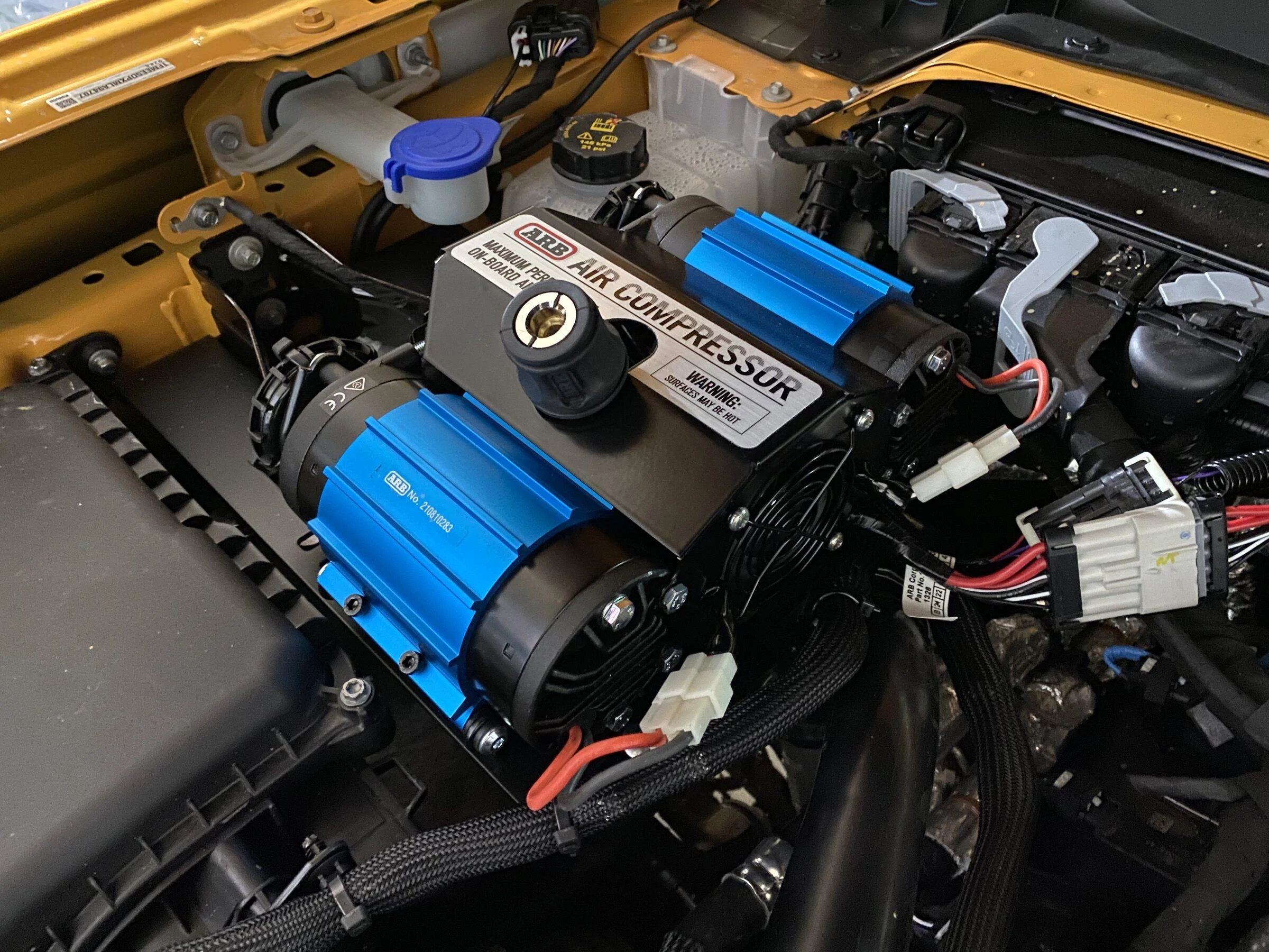

i just got my underhood mount and arb twin compressor, i was wondering about wiring and installation, would it work with aux 1? or would i have to wire it to the battery? cant seem to find any info on that

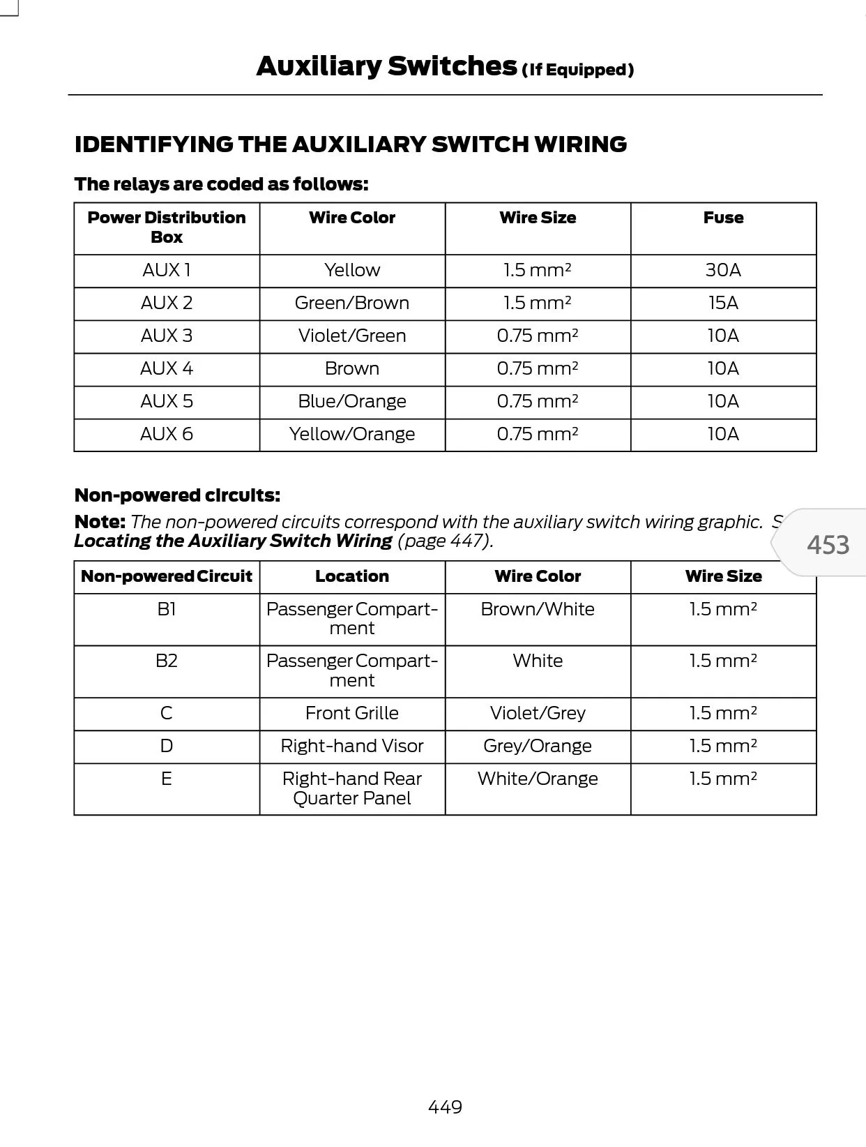

There should be installation instructions in your ARB twin compressor kit. If not, the power harness will wire directly to the battery terminals, but the other harness only needs the single purple wire to handle a trigger signal to activate the on-board relay in the compressor unit, so I would recommend using one of the four, 10A upfitter switches, leaving AUX 1 and AUX-2 for higher-amperage tasks. I chose AUX-6 (yellow/orange wire). I still need to clean up the wiring a bit, but the connections in the photos below are fully functional.
Ford Bronco Lets Talk ARB Air Compressors 50CFF347-7153-48BF-ACFD-E33033371FBB
Ford Bronco Lets Talk ARB Air Compressors D89E3113-1E33-4C44-981A-89943EFAD3E5
Ford Bronco Lets Talk ARB Air Compressors B6A9264E-5A08-4EDA-AA17-40E8B0FE0A15
Ford Bronco Lets Talk ARB Air Compressors 7638495C-AD3A-4F26-A76B-A83ACE0A3D21
