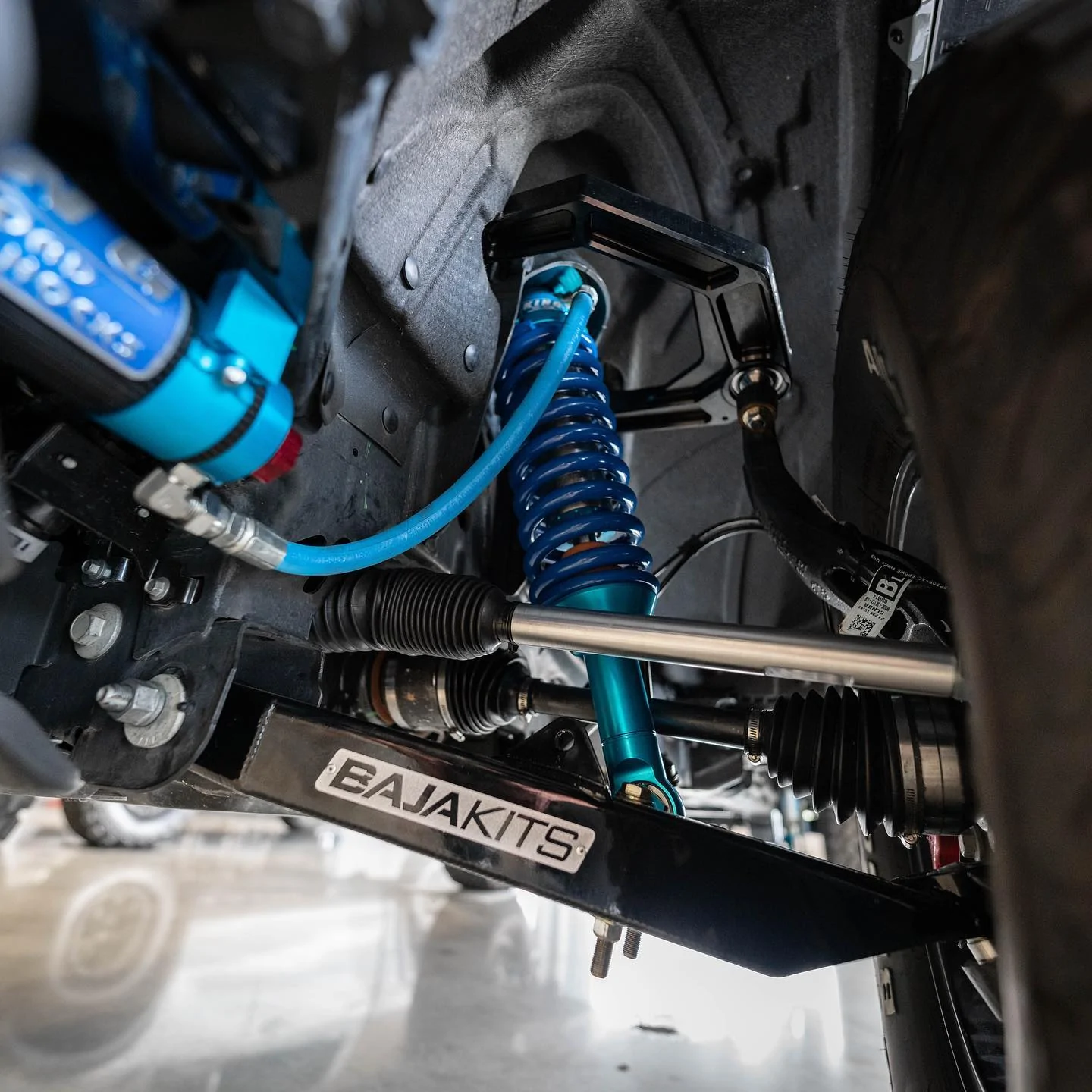

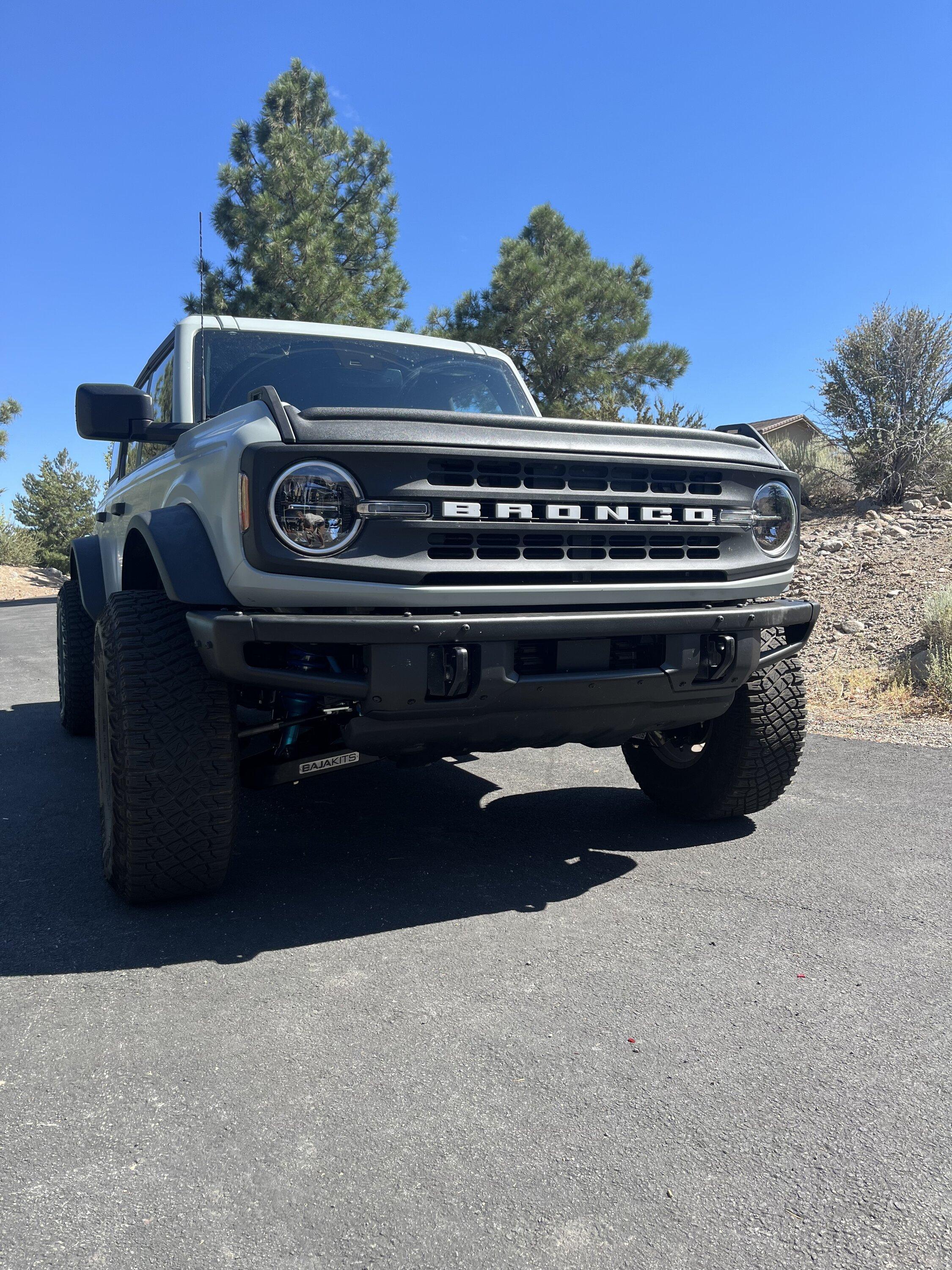

I just installed the +3 kit and it rides awesome off-road. Iā€™m still waiting for Bajakits to make the rear links but itā€™s basically done. King shocks, 0 offset methods and stock Sasquatch 35s. I havenā€™t had it out a ton but the ride is noticeably better in the rough stuff.
The install was really straightforward. Hardest part was getting the cvs rebuilt with the new axle shafts but that was just because I hadnā€™t pulled apart a set in about 10 years. First axle took me over an hour and the next one took about 15 minutes. By the time I was done with the front, bleeding the brakes and throwing on the rear spacers it took about 10 hours in my driveway.
I was running kings before the prerunner kit was on and itā€™s a massive difference in how the front handles with the extended arms. Iā€™m running the stock king tuning in the shocks and thinking Iā€™ll probably end up revalving the rear.

We have a few of the Prerunner Kits here in stock if I can help. We don't keep the shocks here unfortunately though if that's your hold up. Just let me know if I can help!
