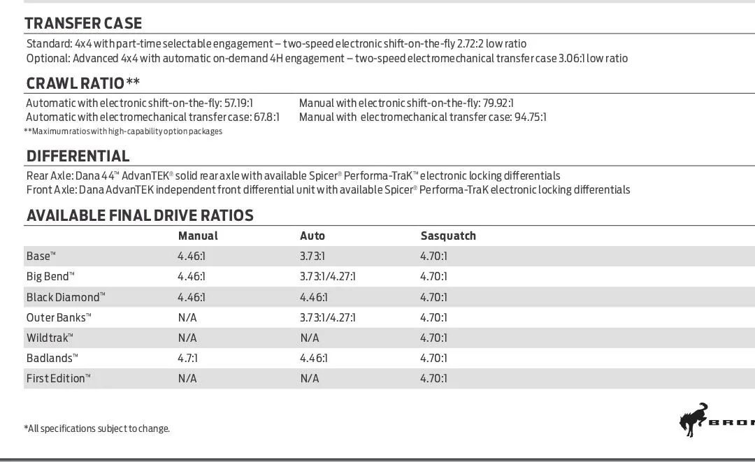

It appears the only way to get the 4.70 on any trim is with the Sasquatch. Maybe 4.27/4.56 will be Ala Carte options?
Gears are plenty cheap enough after the factory to get anything you like, with the bonus of being able to pick lockers you want at the same time.

4.70s come on the Badlands in MT.
It would be great if we have the option to get lower gears, upgraded front axle, and front locker on the lower models, but I doubt it.
Manuals are 4.46:1 except the Badlands which has the 4.7:1.

I saw some where that a rear locker is available on the base
I thought I saw on a infographic of options the base couldn’t get the locker? Hopefully I am wrong on that.
Unless Squatch obviously.

you can at least get a rear locker on Bigbend and black diamond without Sasquatch

You can get the rear locker on the base trim IF you get the squatch package.
