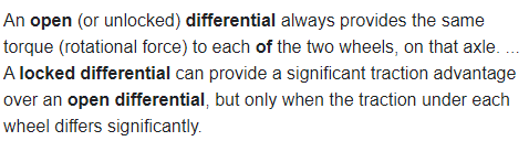

i have ordered OBX it comes with an open rear axle when you put it in 2wheel drive which 2wheels are active. also when you put it in 4wheel drive does it activate all 4 wheels and if so why do you need locking front or rear axles if all 4 wheels are pulling.

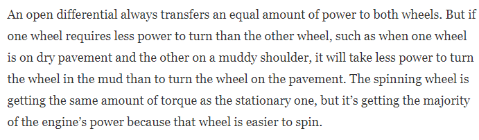

Or.... I can delete all that garbage and post this:
Ford Bronco locking axles 1616758218854
Ford Bronco locking axles 1616758311458

2wd will be the rear axle.
With open differentials when it's in 4wd both axles will get power. But in low traction situations, if a wheel spins that wheel will get all the power and the other won't be pushing at all. Locking differentials lock the wheels on that axle together, so if one spins the other will get power to pull you free.

An Open Differential is just that, open, w/power going to but one wheel. If you've ever gotten stuck, like in snow, you will only see one wheel spinning.
A Locker Differential, when disabled, is Open, just like on an open differential.
When engaged via an electrical/pneumatic/or vacuum switch, it is Locked, w/both wheels Locked as in one solid axle. There is no disengagement when turning a corner, and as such can only be used Off-Road on a loose/slippery surface, such as on dirt and gravel, snow, ice, and rain (heavy).
Finally, there is a Limited-Slip Differential which is always engage, using a clutch, where one wheel is allowed to disengage when you make a turn. It can be used on all road conditions, including on gravel and dry pavement, though it not as strong as a Locker, especially w/big wheels/tires, and under extreme conditions such as heavy offroading.
Now there are an assortment of different differentials in between, w/Open Differentials using the brakes to apply pressure to the spinning wheel, in order to help transfer power to the non-spinning wheel. That's become pretty much the standard norm w/many vehicles now-a-days, w/an assortment of different names. I had a Toyota Tacoma TRD Sport which said that it had a Limited-Slip Rear End, when in fact it simply used the brakes to control the traction.
